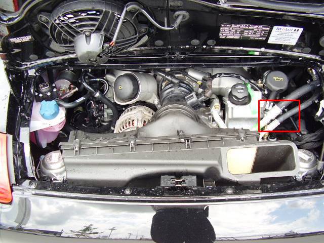

Guys,
I made a simple mod on my 997C4S Porsche sport Exhaust (PSE) to make it stay ON all of the time (so I didnt have to keep hitting the switch).
I simply disconnected the pink connector on top of the engine and there ya go - sports exhaust always open!
Question is - is the same modification do-able on my forthcoming GT3RS ??
Many thanks!

Where is this pink connector?

I think the connector in the GT3 (RS) is at the rear right of the engine and is blue.
I have not picked up my GT3 yet to check it but I have seen several posts on this topic, if not on this forum then definitely on others.

Mine wasn't blue. Just follow the hard vacuum lines up from the passenger side exhaust and you will see which plug to undo
You might be right. I was able to find some pics on another forum/webpage, and there might be some blue tape by the connector. I looked at the pic more closely and the plug itself is a much lighter colour. I'll have to look for it on my car this weekend.

Can someone please post pictures of where the connector is located? Thanks.

Right side of the engine bay behind the AC hoses

THANKS - Do you just disconnect the plug or do you need to do anything else?

Remember to squeeze in the locking wire clip and the plug.
