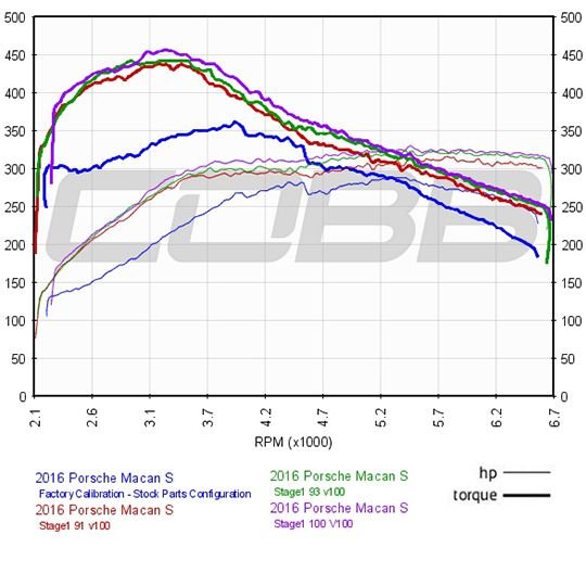

All supported vehicles receive Stage 1 OTS maps that are intended for an otherwise stock configuration. Maps are available for 91 octane, 93 octane, and 100 octane fuel. The Macan S also features an OEM+ calibration available which brings its power output level to the factory Macan GTS calibration. Additional information regarding OTS Maps can be found on the Map Notes Page. Custom tuning support will not be immediately available however we plan to make available in the future. The power gains for these vehicles are significant, see dyno graphs below for power gains on each trim.
Porsche Macan Turbo Power Gains
Stage 1 91 Peak Gains : +13.33% HP, +26.18% TQ
Stage 1 91 Max Gains : +35.24% HP, +34.31% TQ
Stage 1 93 Peak Gains : +17.50% HP, +32.78% TQ
Stage 1 93 Max Gains : +42.18% HP, +42.67% TQ
Stage 1 100 Peak Gains : +20.83% HP, +36.79% TQ
Stage 1 100 Max Gains : +43.89% HP, +44.27% TQ
Porsche Macan GTS Power Gains
Stage 1 91 Peak Gains : +5.25% HP, +15.74% TQ
Stage 1 91 Max Gains : +34.72% HP, +34.81% TQ
Stage 1 93 Peak Gains : +9.26% HP, +19.04% TQ
Stage 1 93 Max Gains : +36.31% HP, +36.59% TQ
Stage 1 100 Peak Gains : +9.26% HP, +23.86% TQ
Stage 1 100 Max Gains : +41.77% HP, +42.07% TQ
Porsche Macan S Power Gains
Stage 1 91 Peak Gains : +9.43% HP, +21.24% TQ
Stage 1 91 Max Gains : +37.30% HP, +37.29% TQ
Stage 1 93 Peak Gains : +12.48% HP, +22.38% TQ
Stage 1 93 Max Gains : +40.94% HP, +40.94% TQ
Stage 1 100 Peak Gains : +14.56% HP, +26.28% TQ
Stage 1 100 Max Gains : +41.73% HP, +41.72% TQ

So I have 3 questions for Cobb Tuning:
1. I have a 2015 Macan S. Can I use the Accessport to initially download the OEM+ map (simulated stock like GTS calibration), then download the Macan GTS Stage 1 V100 to get maximum power benefit?
2. Is this purely an ECM tune or an ECM and TCM tune?
3. Any capacity or future plans for on-the-fly switching between the 91 and 93 octane maps?
BTW, having already used your Accessport on my 2010 GT-R, your product is amazing and works flawlessly!!
Thanks
Jonathan
1) When you install the Accessport, it will identify your vehicle and ECU ROM id as a Macan S and then only allow you to flash maps for that specific ROM ID/vehicle ID combination. You'll see options for the OEM+ maps (to give you stock GTS power levels) and stage 1 maps. The stage 1 maps you'll see will be specific for the Macan S (so not v100 GTS maps) but the stage 1 maps for the Macan S and the GTS will provide approximately the same whp/tq gains on both vehicles.
Aka- there's no reason to download a Stage 1 GTS map to the Accessport and then try to flash it to your Macan S, as the power output will be the same using the preloaded Stage 1 Macan S map.
2) We currently only provide ECU tuning. PDK tuning is something we're investigating for future release but there is currently no decision on if, or when, that support would be available.
3) Map switching is not currently available for the Porsche Accessports but it's definitely a feature we're hoping to add across the Porsche platform in the future.
Thanks!
~Jared
