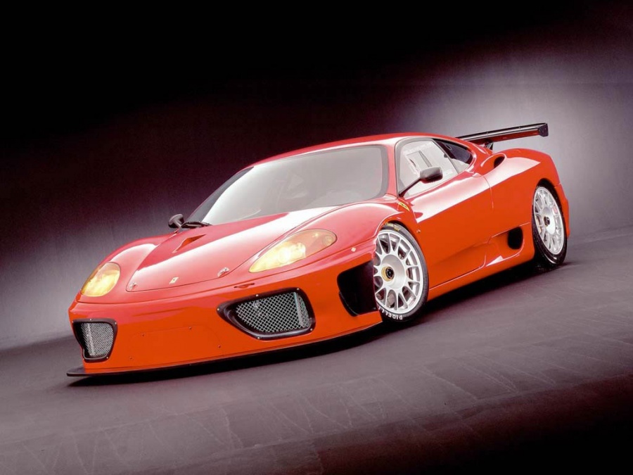

CornersWell Is a GOD !CornersWell Is a GOD !CornersWell Is a GOD !CornersWell Is a GOD !CornersWell Is a GOD !CornersWell Is a GOD !CornersWell Is a GOD !CornersWell Is a GOD !CornersWell Is a GOD !CornersWell Is a GOD !CornersWell Is a GOD !
My "other" ex-GrandAm ride...
CW
