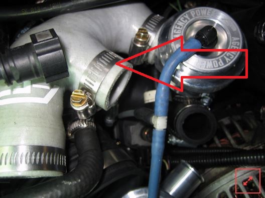

Anybody knows which brand is this / where to order these aftermarket F-hoses ?
Old Apr 13, 2018 | 04:34 AM
RDS993's Avatar

Thats AGENCY POWER F hose.
Vivid racing sells them.
https://www.agency-power.com/shop/si...porsche-996tt/

So it means that 996TT and Panny Turbo/Turbo S has the same F-hoses ?

OK. Seems that there is no aftermarket hoses for Panny Turbo diverter valves ... ? At least I have no success finding them

Just OEM hoses. They are fine.

yes they are, but when changing diverter valves they might brake, so I wouldn't mind to order silicone ones like for 996TT and replace them together with valves.
.... and what is p/n for OEM diverter valves for 970 Panamera Turbo just can't find them on diagram to check other stuff related ....
