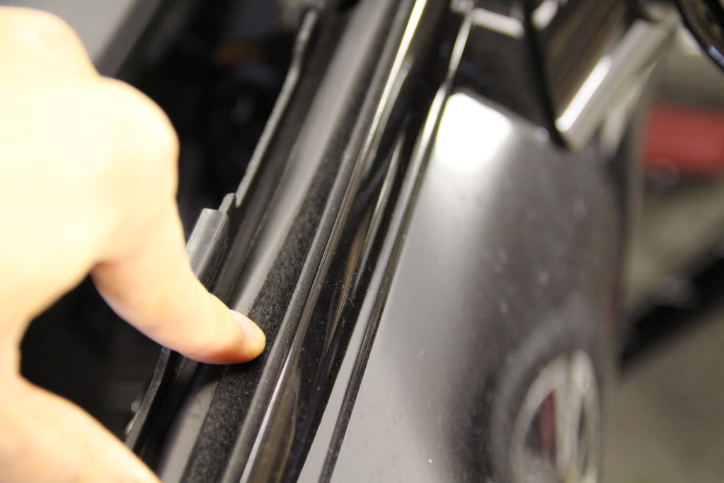

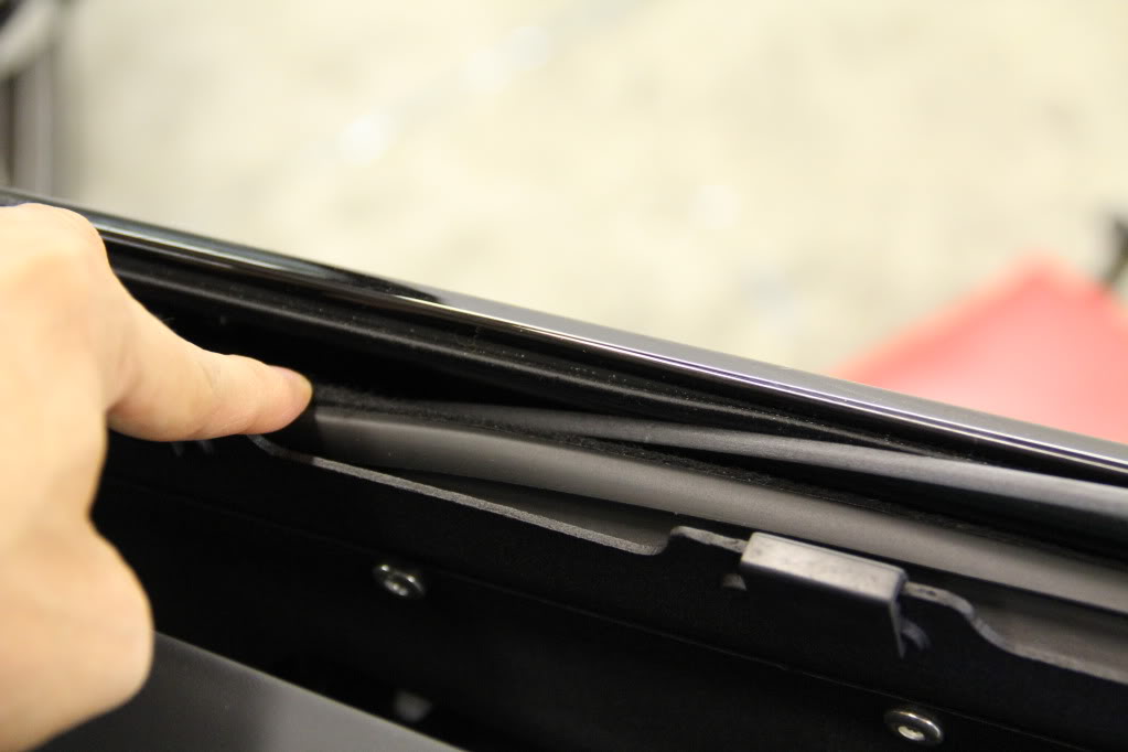

Originally Posted by rzundel
This tint issue is a confussing one. I spoke to my installer today. Very reputable tint installer here in SoCal. Does all the cars dealers in Beverly Hills Ferrari/Porsche etc. He said that he has done a lot of Panameras and you cannot properly add felt to these cars because the way the plastic guide raps all around the window. He seemed to know what he was talking about. He said unfortunately there really is not a sure bet on the Panameras that they won't scratch.
As promised, here is a Panamera GTS we just completed with Spectra PhotoSync 75 on the windshield and 65% on the sides. We also added tintguard to the plastic moldings on all four doors to protect the tint from getting scratched over time. As mentioned before, it takes extreme precision to get it right for the Panamera moldings because the plastic liner wraps around the entire frame of the glass.
