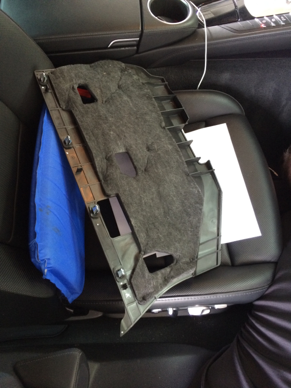

Cabin filter is under the glove box. This panel pops out and you can get to filter.
