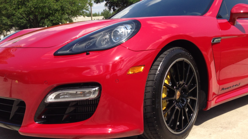

sorry to hear that, this is the sport design on my turbo S for reference...
