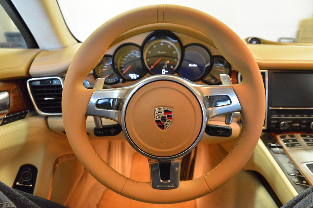

Since I got my Pany Turbo, I was disappointed with the steering wheel, the main issue being the paddles. I did the research and finally figured it all out. The whole install and parts cost me $1250, cheaper than what the Techart paddles would have cost after installation with Sharkwerks. What is funny, none of the Bay area dealers had any clue regarding the parts needed for the install.
The retrofit is pretty simple, you just need the steering wheel (Suncoast parts, paid $650 for a beige one they had in stock) and the multiswitch for the steering column (costs $228 MSRP, $159 with discount). Install was $360 at the dealer (2 hours install time).
Pretty happy with the feel and looks, cannot be happier. The display is now controlled with the additional switch/stalk on the right lower quadrant of the steering column. The only things I lost are the volume control and answering calls, everything else can be controlled with the switch.
BTY, anyone interested in my old multifunctional steering wheel in biege color?

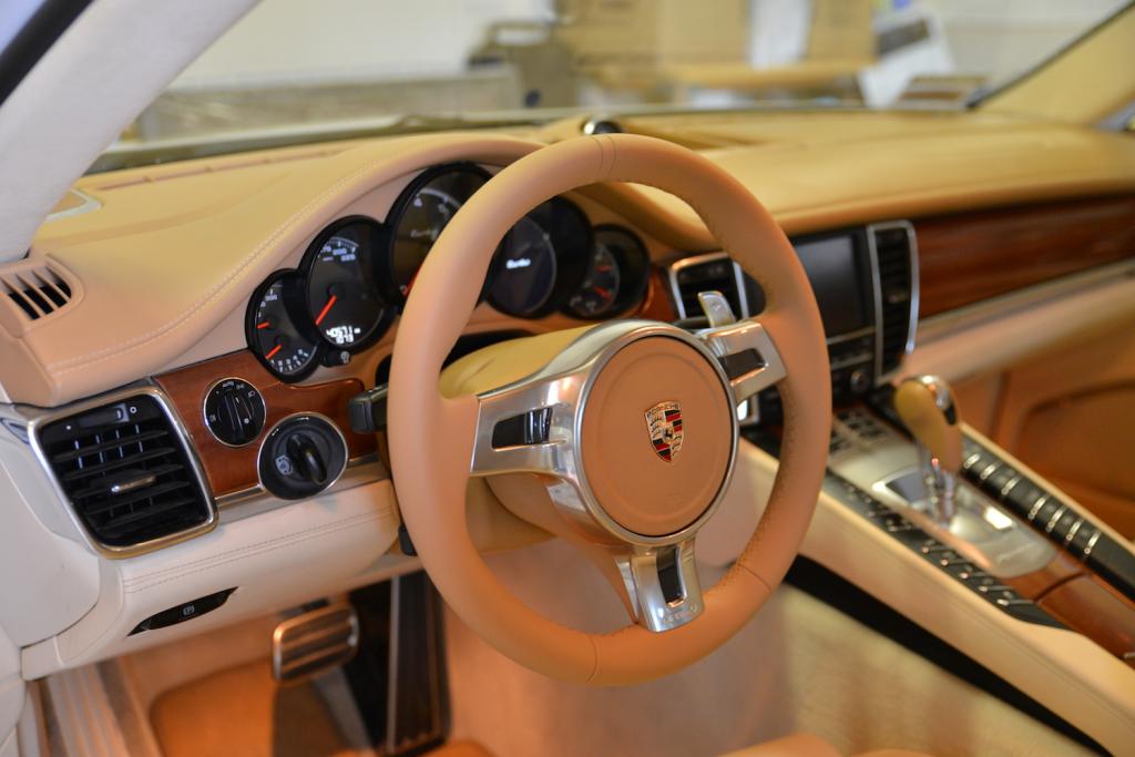

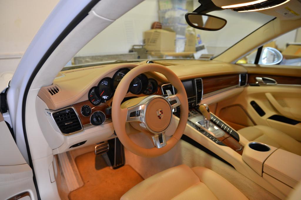

ID:	340766   Click image for larger version
ID:	340767   Click image for larger version

That looks nice
