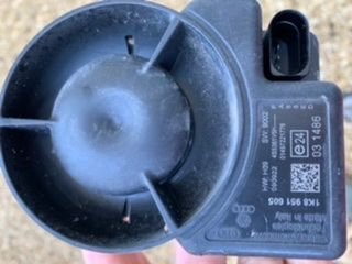

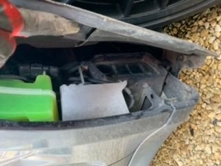

And here is mine in the same place (UK ‘10 PTT).
the alarm unit (made by Cobra, and as fitted to a plethora of VW group cars).
it is inside the aluminium box.
cant work out how to rotate images
