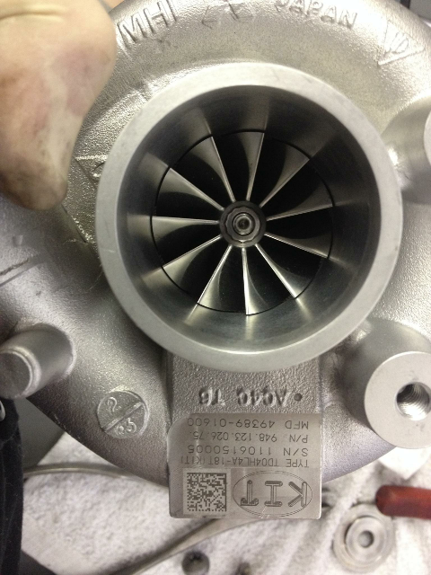

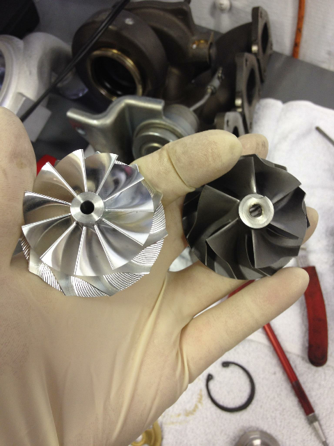

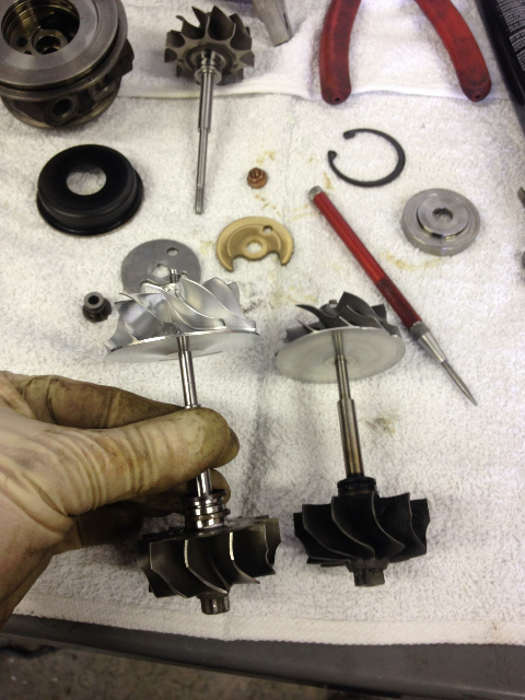

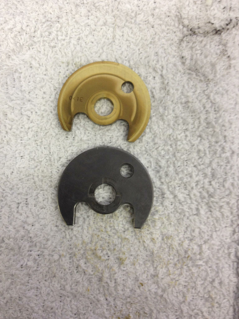

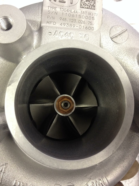

Now it gets dirty. Got a set of stock turbos upgraded to a 20t with a new aggressive exhaust wheel to unleash this beast. Can't wait to have vivid install these and custom tune it I'll post vids and more pix. Ard did an awesome job with the turbos so those interested in this build let me know got a good discount going. Making intercooler this week so will post those soon. I know a few that want some. Hope you all take the jump like I am and others. Questions so far lmk.
iI did this upgrade myself 1 year ago. The real world results are 680-700hp Expect PDK slippage issues. If you don't limit the mid torque.

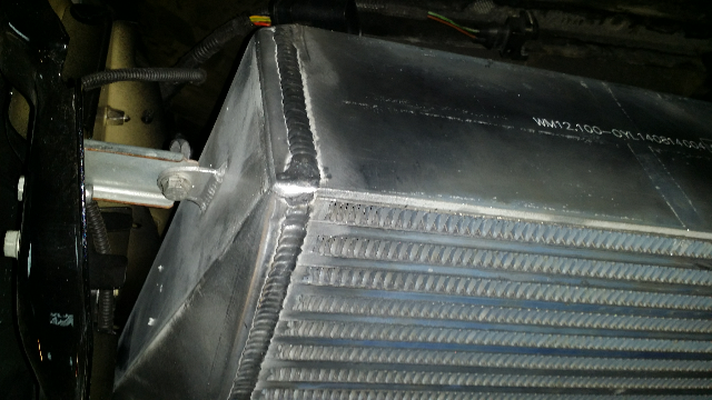

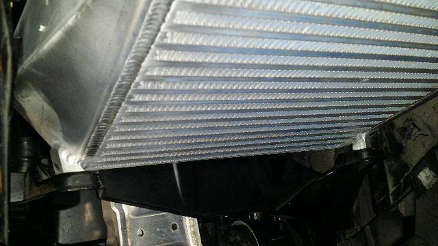

It has begun. These r gonna be awesome. They are gonna machine inlets to fit factory hoses. Can't wait til it's done
Old Sep 7, 2014 | 03:14 PM
benblack's Avatar
Joined: Sep 2013
Posts: 694
From: Oregon
Rep Power: 42
benblack is a jewel in the roughbenblack is a jewel in the roughbenblack is a jewel in the rough

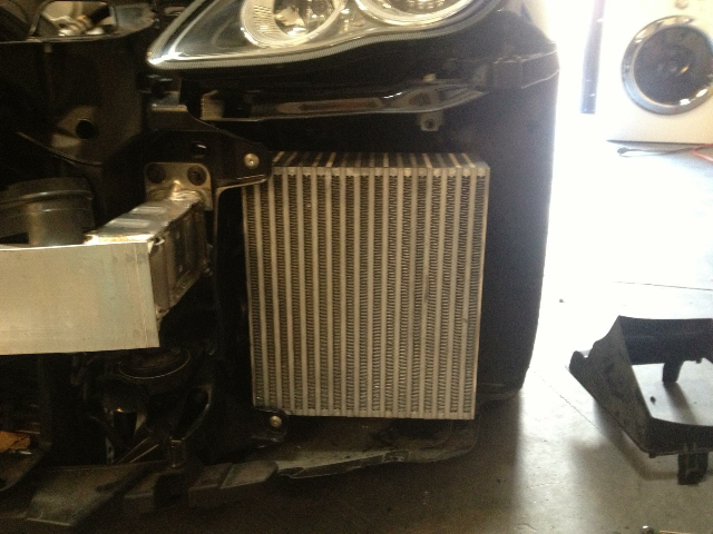

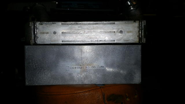

Coming along using factory mounts they are in solid. And needless to say the stock ones are tiny. More pics later when they are done. Cheers. I need another beer

Old Sep 8, 2014 | 02:17 AM
porschecayenne92's Avatar
Joined: Jun 2013
Posts: 1,107
Rep Power: 72
porschecayenne92 has a brilliant futureporschecayenne92 has a brilliant futureporschecayenne92 has a brilliant futureporschecayenne92 has a brilliant futureporschecayenne92 has a brilliant futureporschecayenne92 has a brilliant futureporschecayenne92 has a brilliant futureporschecayenne92 has a brilliant futureporschecayenne92 has a brilliant futureporschecayenne92 has a brilliant futureporschecayenne92 has a brilliant future
Thats double size of oem intercoolers o.O
Old Sep 8, 2014 | 07:49 AM
benblack's Avatar
Joined: Sep 2013
Posts: 694
From: Oregon
Rep Power: 42
4.5 inches thick.
