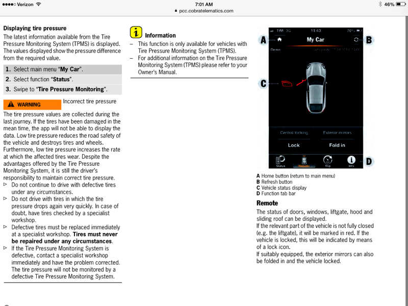

For those with Porsche Car Connect (US), are you able to lock / unlock your doors?
The manual says I should be able to (since I have the entry/drive option) but all I see is the "fold mirrors" option on the screen where I should also see lock/unlock. My phone is set up on PCC as "expert" mode which should give me all functions. ???

The only option I have is "fold mirrors," which is kind of useless. I can't imagine caring about doing that remotely.
Note the words "suitably equipped." I'm guessing there's a required option. I was expecting that PCC would let me turn on the heat or AC remotely, but that's only possible if you bought the "auxiliary cabin conditioning" option, which is $1500.

You are correct about the aux heat/cool. But for door locking it says it requires "entry and drive" which I have.
Guess it's time to call the dealer (of course they won't know either).

I'm having the same problem. I have a car with Entry & Drive, but I don't see an option to lock the doors. I called Car Connect support, and the rep told me she would have a tech get back to me. It's been two weeks and no phone call. She did suggest that it might be the dealer's fault for not enabling the feature during initial setup, but I was hoping to get confirmation before bothering the dealer with it.

After a few emails back and forth with Porsche earlier this year, I found the reason that my PCC does not have the lock option. It is based on build week and I missed it by 1 week. Here is what they sent me:
Why can't I lock my vehicle with PCC?
It is only possible to lock the vehicle remotely with PCC if the vehicle is equipped with options 7G9 "Porsche Car Connect" + 625 "Porsche Entry & Drive" + IY2 "MODELLJAHRSESZEITRAUM 2 (VON KW45)"
Vehicles produced before calendar week 45 will have option IY1 "MODELLJAHRESZEITRAUM 1 (BIS KW45)" and will only have the ability to view the vehicle lock status and fold in the exterior mirrors

FWIW... I allowed my trial Car Connect subscription to lapse, and then I called to renew. Once it renewed, the Lock capability suddenly appeared. Weird, but now I have it.

My build date is 3/14. I have no documentation on the week. 2014 Panamera Turbo S with Car Connect and Entry & Drive. Pressing the lock button in the app now causes the car to lock and arm the alarm.

I should be clear about one thing... The lock button wasn't in the app until a few days ago. Maybe they did something at Car Connect to fix it, or maybe it magically reappeared after my my account was reinstated. I have no idea.
