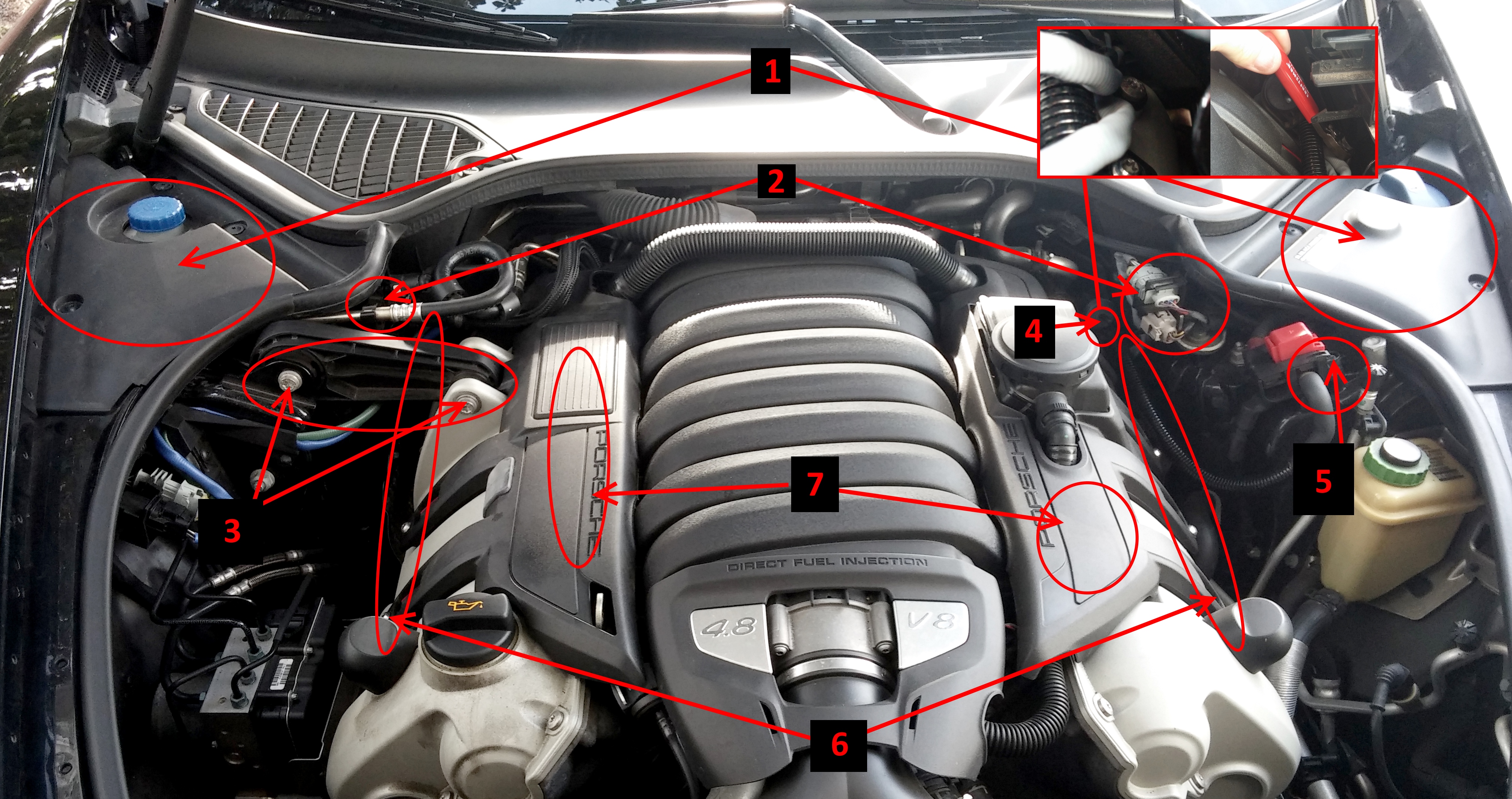

Originally Posted by rmjjensen
I just changed the plugs on my non-turbo v8. Honestly it was really easy but you will need some special tools that you can pick up anywhere. Also, the screws for the coils are aluminum and they need to be replaced.
It should take 1-2 hours the first time. If I were to do it again it would honestly probably take ~30-45 minutes to change all 8 plugs.
Parts:
-Spark Plugs - FGR5NQE04 (turbo has different plugs)
-Aluminum Screws (Porsche recommends to always use new aluminum screws)
-- Coils - 948-105-146-00 (Generally regularly available at the dealer)
-- Engine Torque Damper (I reused these parts)
--- WHT-004-595
--- WHT-005-204
--- WHT-004-635 (x2)

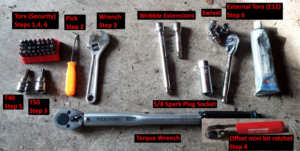

Tools:
You do not need all these tools but they will make your life easier. If you have all of this readily available the swap is extremely quick and easy. There is NOTHING difficult to reach / remove by having the swivel, wobble, and mini ratchet wrench. No cursing at all.
Attachment 471690
Torx bits - I don't remember the exact sizes. One required a security type.
Large torx - T40 & T50
External / Inverted / Hexalobular E12 socket
Pick or very small flat head
Wrench (adjustable or combo wrenches)
Wobble extension set (the wobble makes life easier)
Swivel socket
Socket wrenches
5/8 Spark plug socket
Offset mini ratchet wrench
Dielectric grease
Procedure:
Attachment 471689
  1. Remove the torx screws holding in each corner cover and pop them off.
  2. Pop the vacuum lines (passenger side) off of the black clip and use your pick to remove the black mounting clip completely. Remove the wiring harnesses (driver side) from the black clip and use your pick to remove the black clip completely
  3. Use the T50 bit and adjustable wrench to remove the two aluminum bolts. Slide the damper up and remove it.
  4. Use your mini ratchet wrench with the proper security torx bit to loosen the bolt that holds on the black plastic pathway blocking access to the farthest plug. Remove the screw by hand so that you don't drop it.
  5. Use the T40 and remove the screw holding the positive jumper post. This, in conjunction with step 4, makes it easier to remove the farthest coil and plug as you can now move the large gauge wire out of the way
  6. Remove the 8 screws holding the two decorative covers
  7. Lift up on each cover and slide them out to remove
  8. There should be plenty of clearance at all 8 coils. Remove the eight coil screws using the E12 socket. Be aware of how much force is needed to remove these screws - you will use LESS force to tighten the new ones. Note: I needed the swivel socket to take out the screw for the driver's side closest to the firewall (marked around the step 4 outline)
  9. Unplug the harnesses from the coils
  10. Remove the coils by griping with your thumb and index finger and rotating back and forth, then out. Inspect the boots for any cracks - if you find some, you'll want to replace that coil.
  11. Grab the 5/8 spark plug socket with the appropriate extensions. Slide onto the plugs, remove with a socket wrench. I did not need a swivel for ANY of the plugs.
  12. Place a new plug in the spark plug socket with the wobble extension. Thread it in by hand until hand tight. Attach the torque wrench and finish by torquing them to 22 lb ft
  13. Place a SMALL amount of dielectric grease on the tiny inner lip of the coil boot. Do not glob it on and avoid getting it into the boot. Reattach the coils to the spark plugs by pushing firmly into place.
  14. Install the ignition coil screws through the coils and into the valve cover BY HAND. Snug them up with the E12 socket ...barely! Do not "tighten" them - just snug them up. They will snap easily!
  15. Perform the reverse scenario to put the car back together ...might want to put the damper back on (with the old bolts - you'll need to remove it again to put the cover back on) and try starting the car first.
Hope I didn't miss anything - I'm doing this mostly from memory. Again, this is how I did it - doesn't mean it's THE ONLY way.

I did this the other weekend and it was pretty easy with the write up. Having a right angle screw driver helps with taking off the engine covers.
You need a pretty short (~6 inch) spark plug socket/extension combo for the driver side cylinder closests to the firewall.
I jammed a bunch of towels into the engine bay gaps as insurance against dropping any of those external torx screws.
