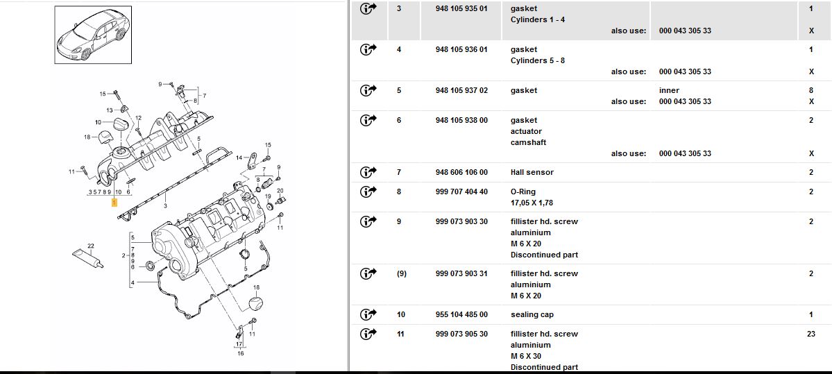

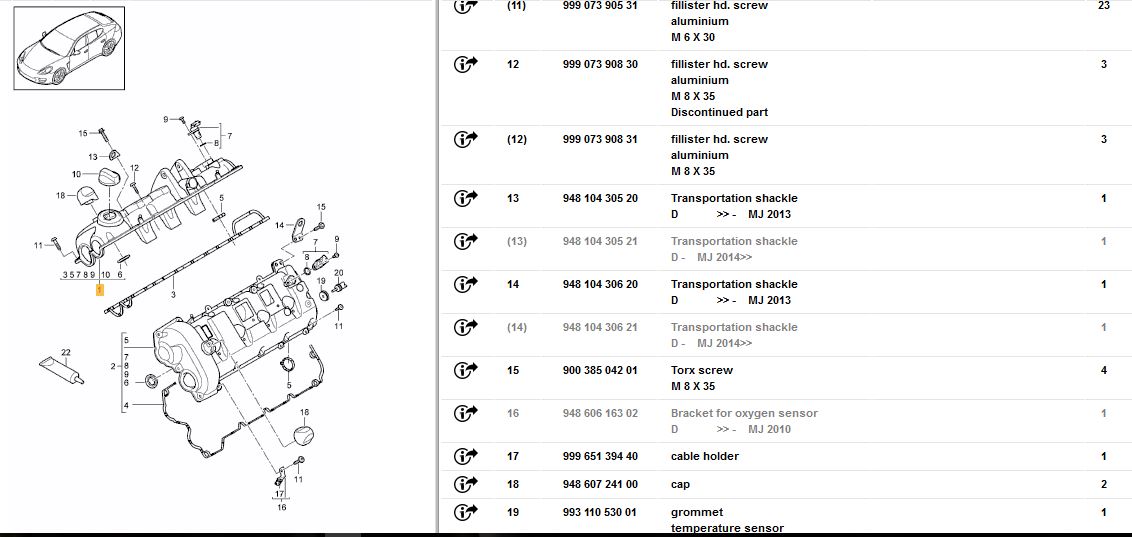

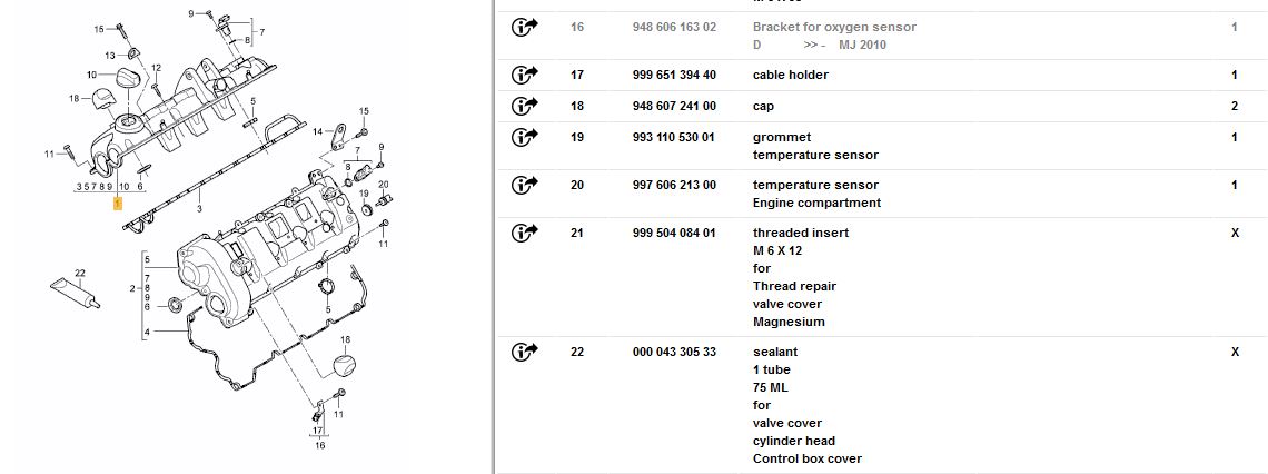

Originally Posted by HP41
The service manual also states that the screws should be replaced and not reused.
Someone knows which ones exactly ?
ID:	526259   Click image for larger version
ID:	526260   Click image for larger version
Old May 21, 2018 | 06:11 PM
  #51
HP41's Avatar
Joined: Feb 2017
Posts: 120
From: Michigan
Rep Power: 16
HP41 is a jewel in the roughHP41 is a jewel in the roughHP41 is a jewel in the rough
It's the screw that holds the spark plug coil in place. I know the dealership did NOT replace mine when they did the 30K spark plug change. I will be replacing them at 60K change.
Part #2 on this diagram.
Regards,
Chuck
2014 Panamera-4S
Old May 22, 2018 | 04:05 AM
  #52
negb's Avatar
Joined: Oct 2015
Posts: 480
From: E.U.
Rep Power: 30
negb is infamous around these parts
So only these screws 94810514600 ?
There are a lot of aluminum screws on heads covers, intake manifold.....
Old May 22, 2018 | 06:50 AM
  #53
HP41's Avatar
Joined: Feb 2017
Posts: 120
From: Michigan
Rep Power: 16
Sorry about the confusion - I was replying to the DIY spark plug job only. There are several screws that are suggested by the service manual to replace if removed.
This is the info I have for the S,4S (which is based on the V-8) for the head cover.
Chuck
