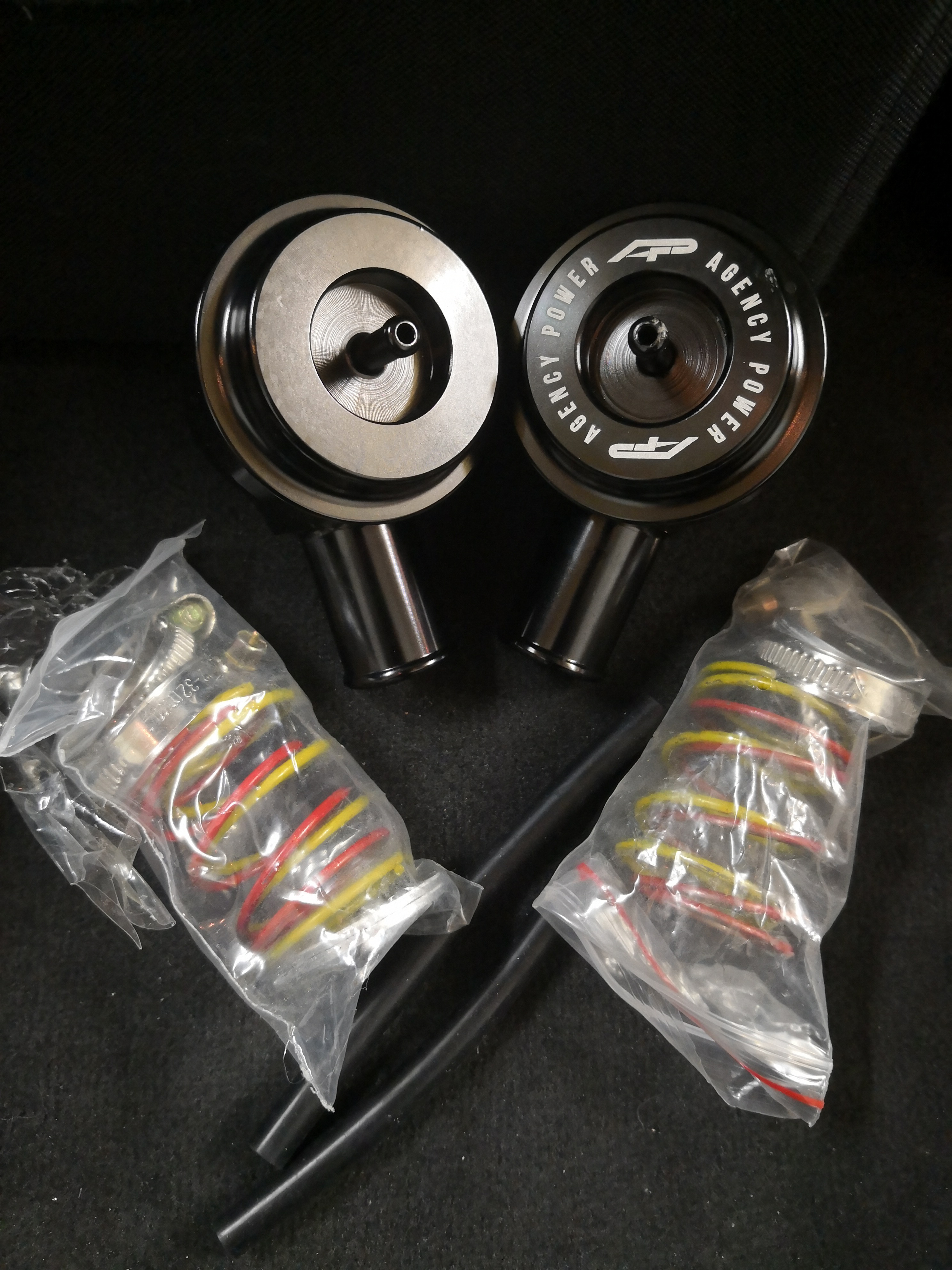

.... because you've got genuine product and me... one valve came event without logo; that's OK, but then what I see on aliexpress - exact setup !!! 20$ delivered to US ! vs 275$; and that seller is not providing springs ratings either (sorry couldn't find that DV on English version of aliexpress).
Proper companies providing ratings for springs and besides that they are standard ratings by colors, I just wanted to find out if anybody got the same Agency Power DV's like mine...
And one more thing: mine doesn't have 90 degree removable swivel connection for easy fitting, as the ones from aliexpress - another prove ......
P.S. about spings ratings:
http://www.titanmotorsports.com/bsptukit.html
http://www.econmancer.com/2008/01/fo...ation-and.html
