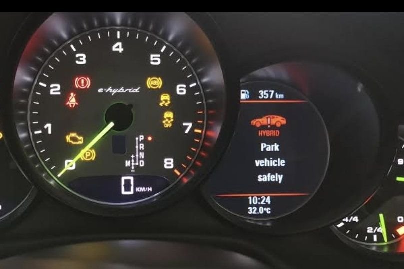

Hello I have Panamera S E-Hybrid 2014 plug in. I have same problem - on the dashboard show me warning - PARK VEHICLE SAFETLY. Cars give hand brade, electric motor stop, and cooling fan on engine begin runs. With the car can not moving. Have anyone tips how solved this problem? What is wrong?
Can anyone tell me how this problem should be solved?
