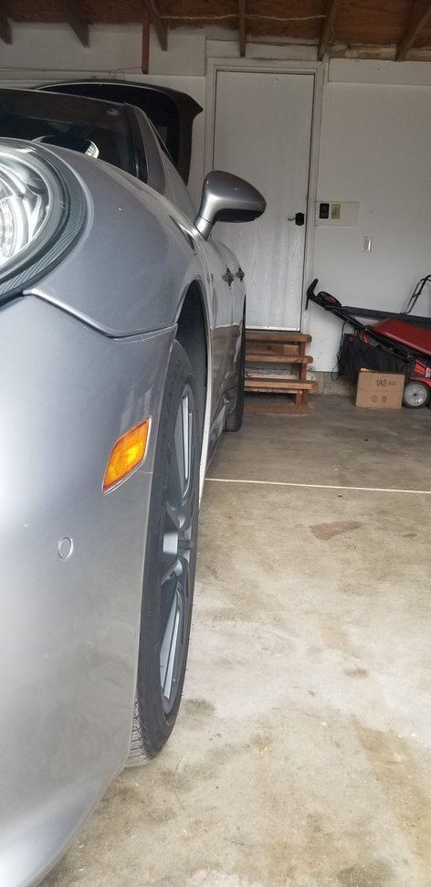

Just fitted some 15mm spacers and wow... they make such a difference visually! Fit the wheel wells perfectly now and zero rubbing. Well worth the small upgrade...

Thats exactly what I got, 15mm on all sides. This dimension appears to let wheels fill up the wells perfectly, without sticking out like on a truck. They allow the car to retain its high value look.
Hope you got longer lug nuts for them. The original size does not leave much room on threads to hold securely. I got black 44mm shank R14 swivel washer, to ensure nothing goes wrong.
Good choice. I bet you did not think 15mm would make such a difference, but after putting wheels on, you were pleasantly surprised.
Looks great.

Yep, actually got them from suncoast and they came with black extra long lug nuts! Was one of the simplest, but biggest impact things 😊

Looking good, it did make a big difference. Changing the lug nuts is the way to go!

I would imagine that springs would end up with similar heights to air suspension... but I am not sure. There is zero rubbing, even at full lock or around bumpy corners. It definitely makes a difference though.
I got my wheels balanced yesterday as well (one was over 1oz off!) as spacers do tend to accentuate any smaller issues like that.

I did a fair bit of research before and most go with a staggered approach for other models... 15mm rear, 7mm front. I did 15mm front and back (like ciaka I think, too) and it fits perfectly.

I am back in for a second wheel balancing... anyone had issues with adding spacers and juddering when at speed? Now I have them on, I am starting to hear some negative stories about cars with spacers.
Are they actually safe to do?

I have had spacers in other cars with no issues. I would say check that you tightened everything to spec, 96 ft/lbs and tighten by hand.
Hopefully you made sure the hub was clean and clear of any coarse rust so that the hub and the spacer line up with no gaps.
It is recommended that you go back and re-torque everything after driving 60 miles. I think you mentioned getting longer lug nuts so you should be covered in that respect. Good luck, and let us know how it goes...

My work commute is 40 miles each way so I will tighten again when I get back tonight. The tire and alignment dudes last night torqued to specs at 133lb? Seemed like a bit much to me at the time but trusted them. Also wirebrushed the hubs clean and wiped down with cleaner before fitting the spacers.
Either way, will check later.
