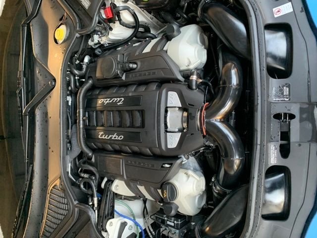

Just checked mine today. 12 PTT with just over 40k on it. My ideal has gotten rough and I have started throwing a p4012. This is what I found could this be causing the rough idle? New AOS is already in order, and I got a new down stream 02 sensor to try and fix the code.
