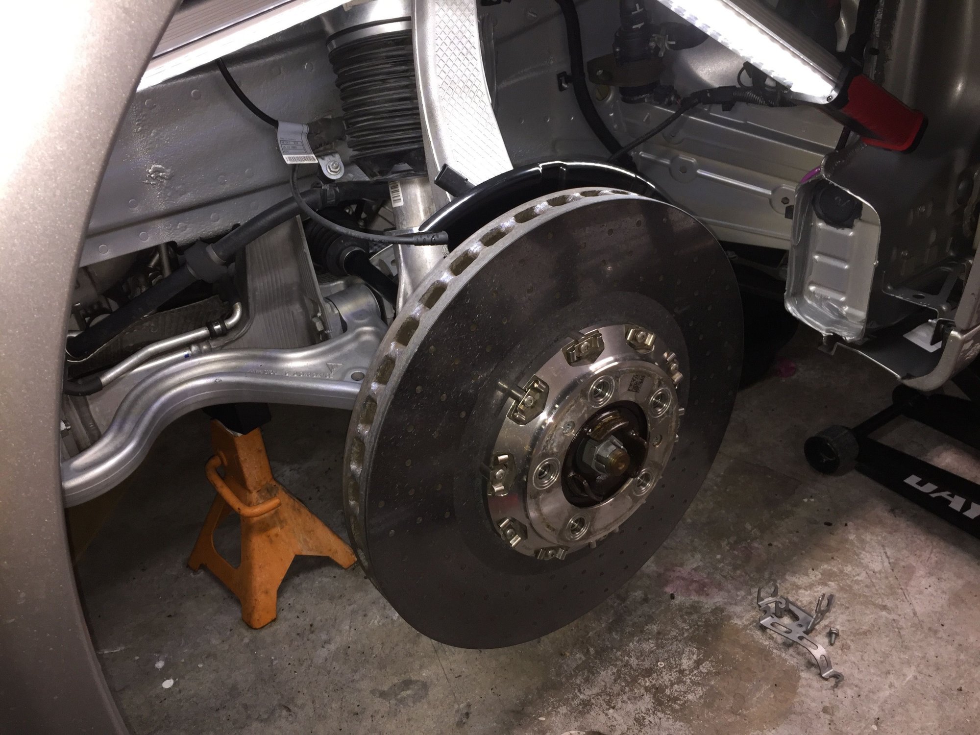

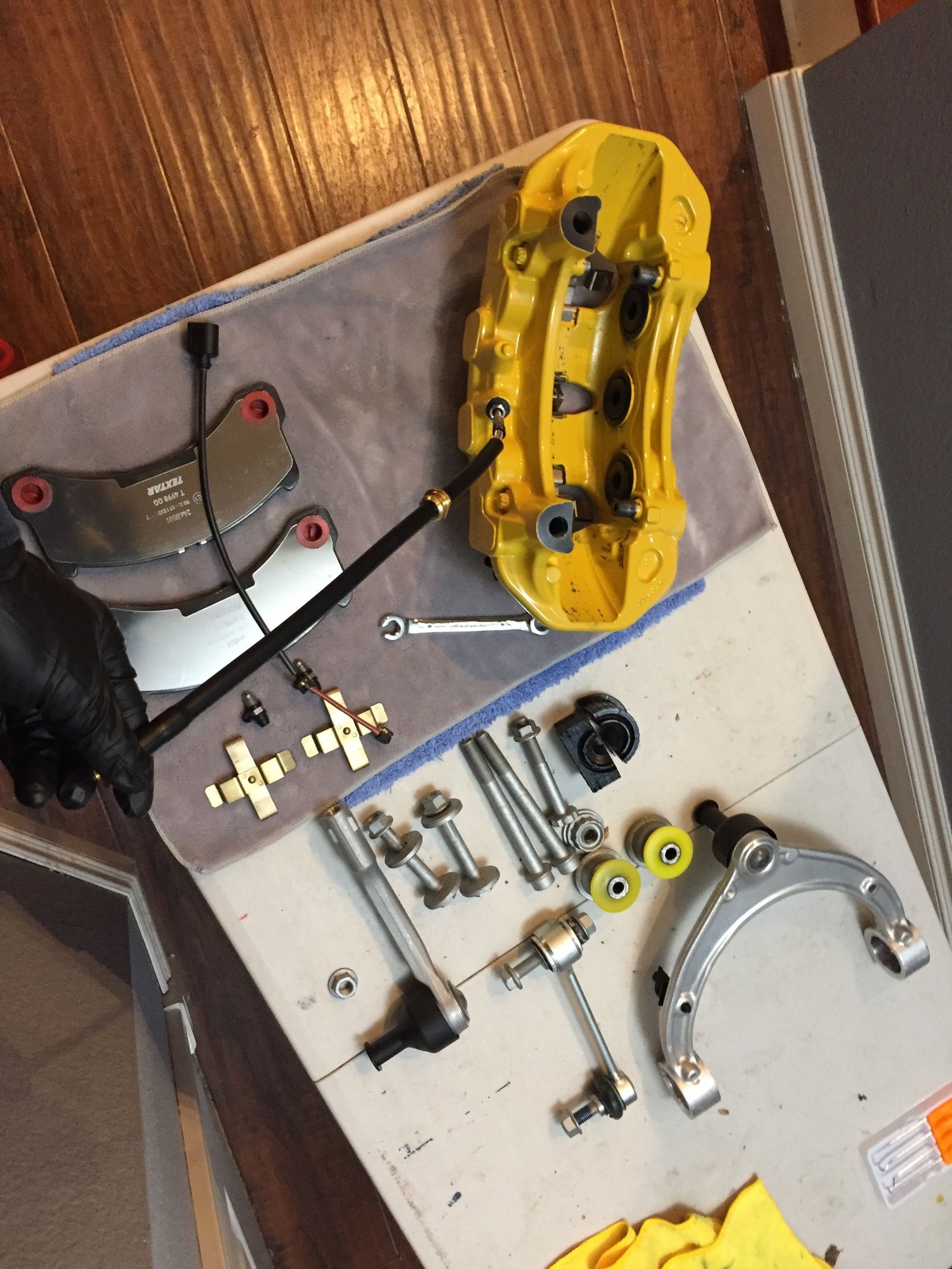

Dogwood, I have hit the 100k mile mark and Im doing a super thorough refresh of everything while simultaneously building up the car for more power and boost. I was planning on doing my transmission filter and fluid change a bit earlier than the 120k mile mark as recommended and thought this would be a perfect opportunity to do it. I recently just changed out the entire suspension arms on the car front and back and the car drives beyond ridiculous now, haha. I picked it up here, as they had it in stock and they always have it to me by the next day without any extra shipping charges. https://www.pelicanparts.com/catalog/SuperCat/4894/POR_4894_TRAUTO_pg2.htm#item8

I will actually post up a legit DIY for it, but to answer your question here so that you guys can get going on the project... The job is super easy! Although its not necessary to completely pull off that huge x-brace, I highly recommend you do as one of the surfaces of the bushing actuallys sits on that brace. You'll want to do a good degreasing of the entire bar and polish the surface where the bushing mates. Basically, to install the new bushings, all you have to do is mount the brace back on and have all the bolts screwed in by a total of 5 rotations. This will allow space for you to slide the top and bottom bushing sandwhiched between the sway bar. I highly recommend using this specific grease for bushings that prevent early wear. Once you have the bushing in place, just start screwing in the bracket bolts slowly and evenly and thats it. The longest part is the cleaning and removing of the underbody panel. You only need to jack up and support one side of the front, for me, it was easiest going through the passenger side with wheel off. Here are the updated part Numbers for this entire overhaul:
1)Upper Bushingx2: 970.343.792.06
2)LowerBushingx2:970.343.793.06
3)Sway Bar Updated Link: 970.006.903 ---> There are certain versions that also come with two nuts and a bolt.
4) https://www.amazon.com/Energy-Suspension-9-11104-FORMULA-PRELUBE/dp/B000MW5SJ4/ref=asc_df_B000MW5SJ4/?tag=hyprod-20&linkCode=df0&hvadid=312114638367&hvpos=1o14&hvn etw=g&hvrand=7200421033134348327&hvpone=&hvptwo=&h vqmt=&hvdev=c&hvdvcmdl=&hvlocint=&hvlocphy=9031580 &hvtargid=pla-493158597728&psc=1]https://www.amazon.com/Energy-Suspension-9-11104-FORMULA-PRELUBE/dp/B000MW5SJ4/ref=asc_df_B000MW5SJ4/?tag=hyprod-20&linkCode=df0&hvadid=312114638367&hvpos=1o14&hvn etw=g&hvrand=7200421033134348327&hvpone=&hvptwo=&h vqmt=&hvdev=c&hvdvcmdl=&hvlocint=&hvlocphy=9031580 &hvtargid=pla-493158597728&psc=1
The updated sway bar link is improved as it replaces your current link(which has two ball joints) with a single ball joint design with a regular bushing joint. This makes the car much more stable in turns and a vast improvement. Takes away the clunk.
And a piece of Advice.... so you dont freak out like I did.... When you get the new sway bar bushings and look at the diameter of the orifice and then look at the sway bar, your brain is gonna tell you that the bushing is too small.... It is not, haha. Also, place grease on the entire outer surface of the bushing as well as the mating surface to the bar and on the sway bar retaining ring.
