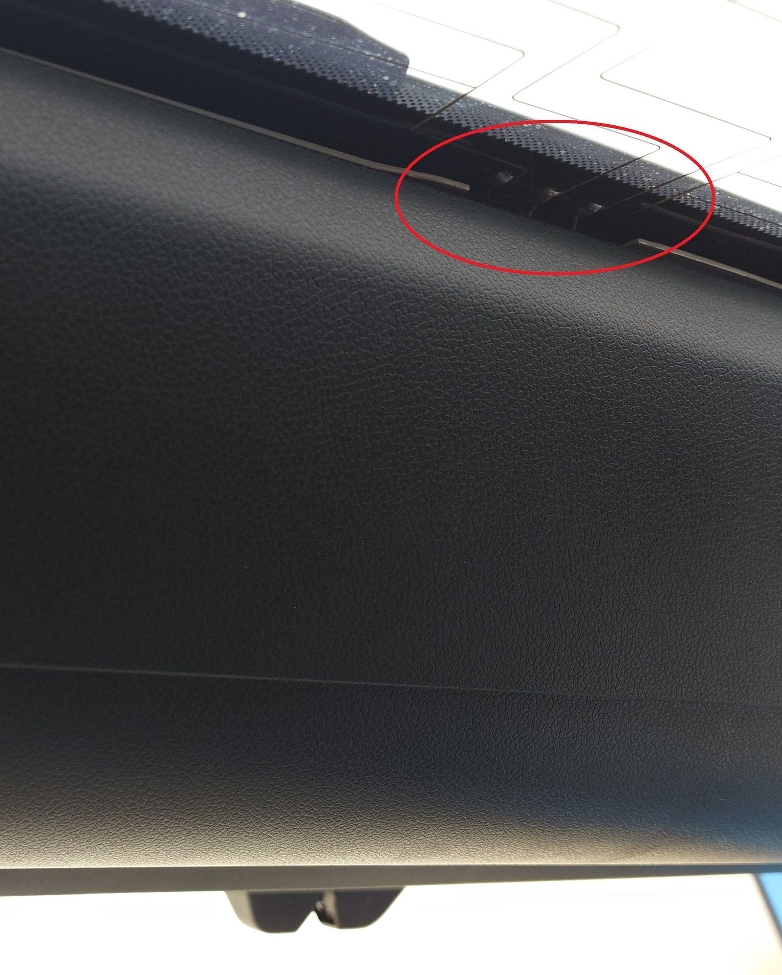

Glad this post was useful to you guys....BTW this YouTube video is on how to install this device but it's not very clear etc. Also depending on the year of your car look at the buttons to close and close/lock the trunk. If you see that it is removable with two indents to put a tool/flat head then remove it and you'll find another star bolt which needs to be removed. It doesn't show this step in the video. The control panel where the wires from this device connect are on the left side of the trunk after removing the panel enough to get your hands in. There are two connectors which you will pull off from the car and then connect to cables from this device and the device cable to the car. The first cable from the right has a slide lever which you move to the left and then pull the connector off and reverse when connecting. This unit from China has the exact same connectors when reinstalling. I was impressed on the build quality for only $69. Good luck.

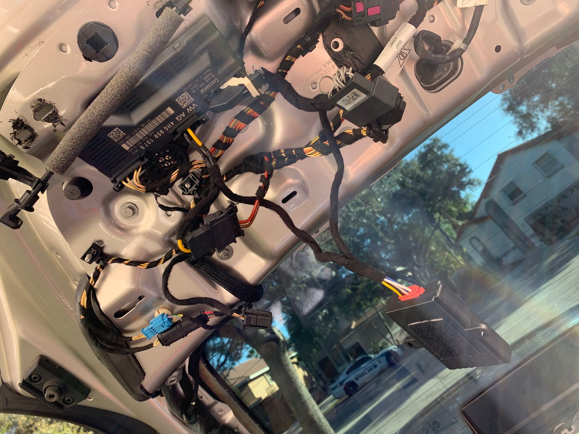

control module installed, all ok. thanks to FIRST_PORSCHE for guidance tips, just few small remarks:

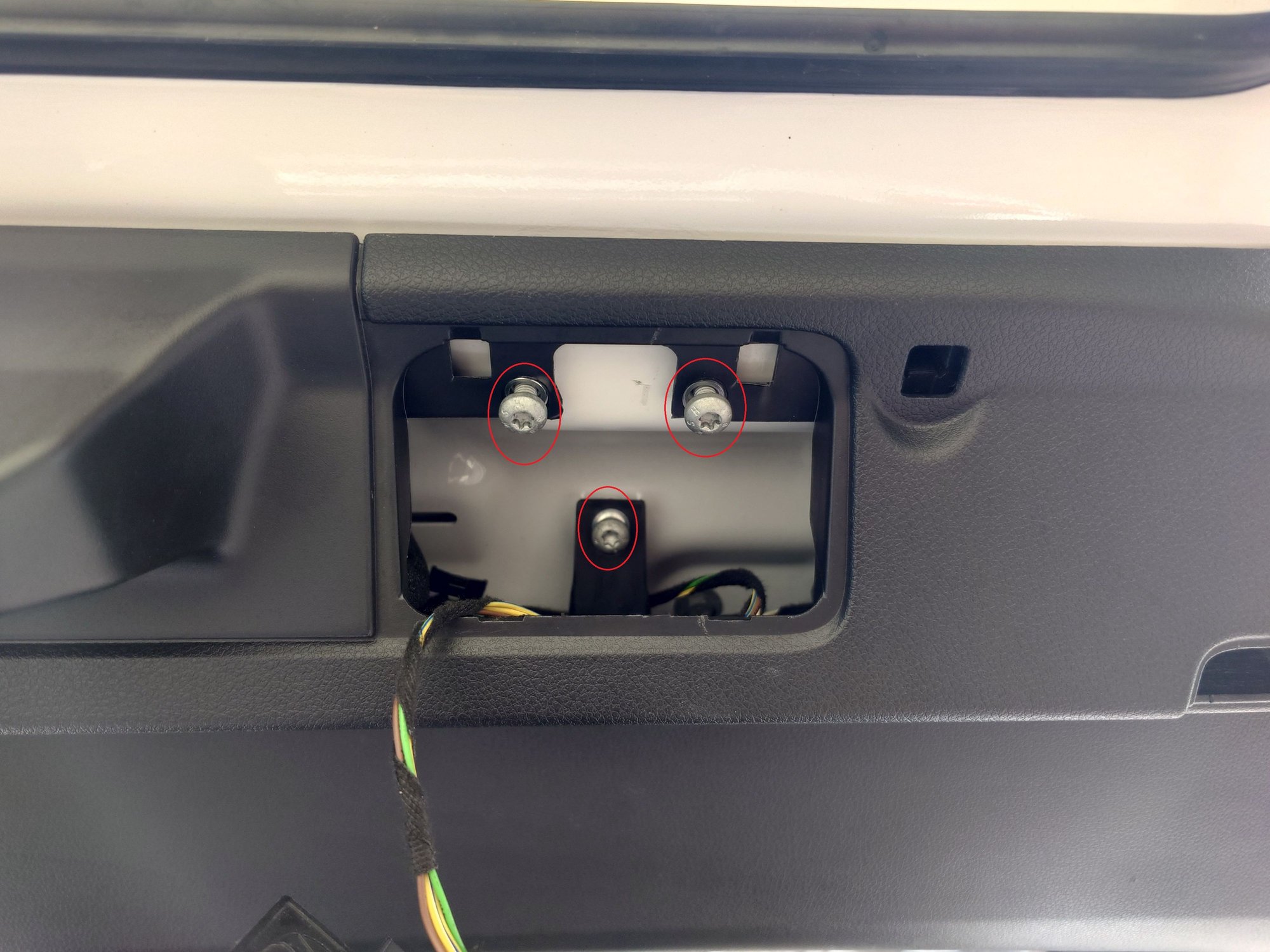

in my case there were 3 star bolts which had to be removed:

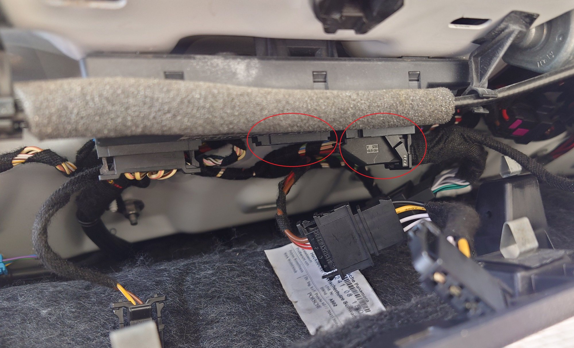

if to be more precise: first connector from the right and second (middle) needs to be removed and interconnected with new module:
and carefully with the whole plastic cover when pulling it down, pay attention to wiring going to rear window heating element

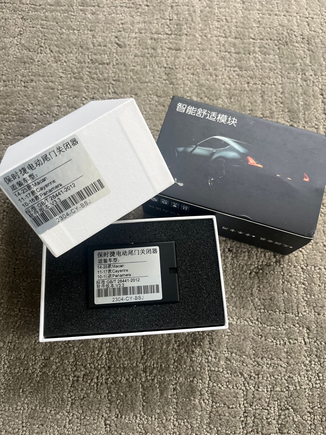

Mine arrived today! Ordered from AliExpress and came much quicker than I expected! I’ll install it in the next few weeks and hopefully everything goes smoothly. I’ll reach out to the group if I run into troubles. Thanks in advance!

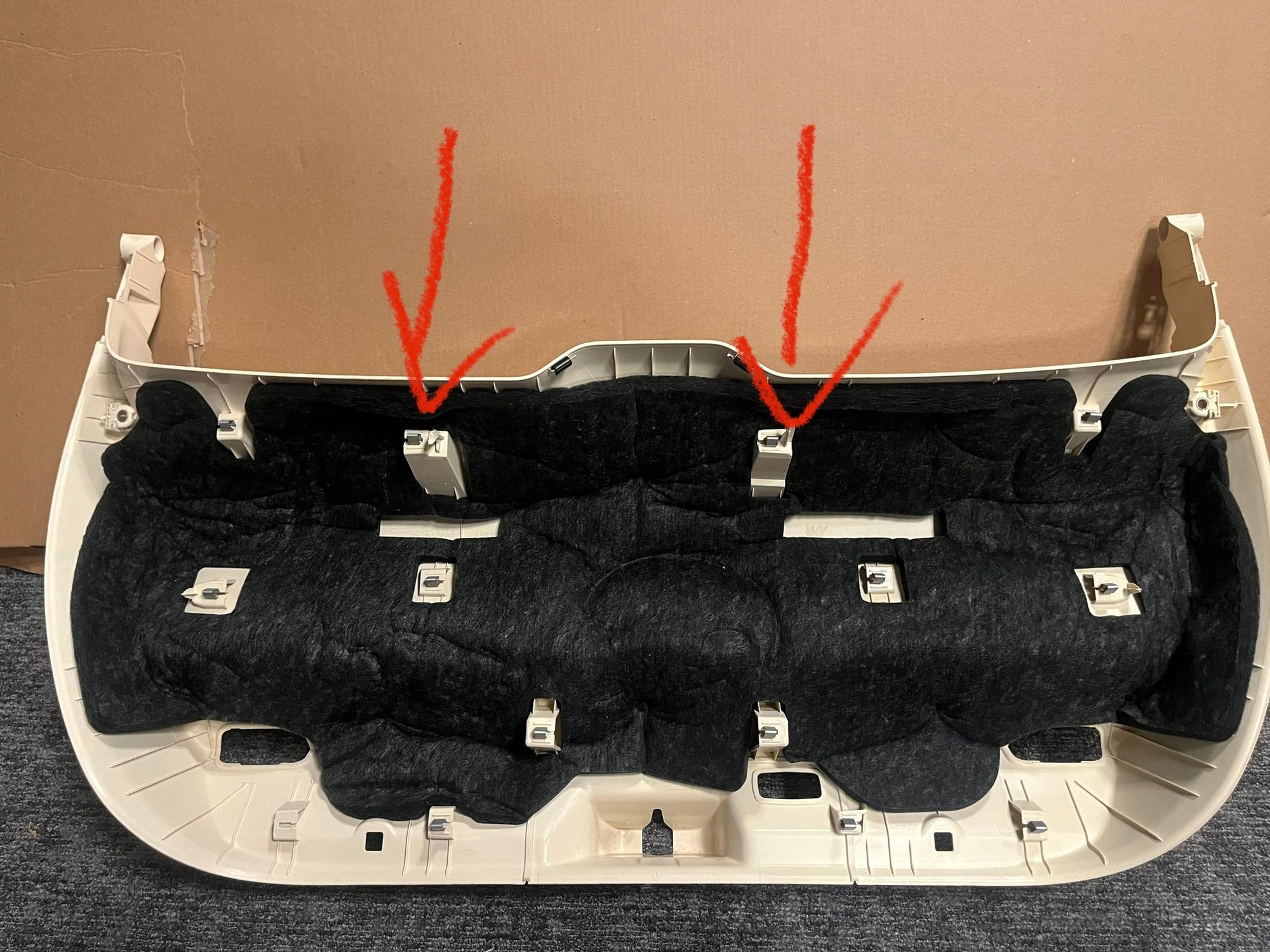

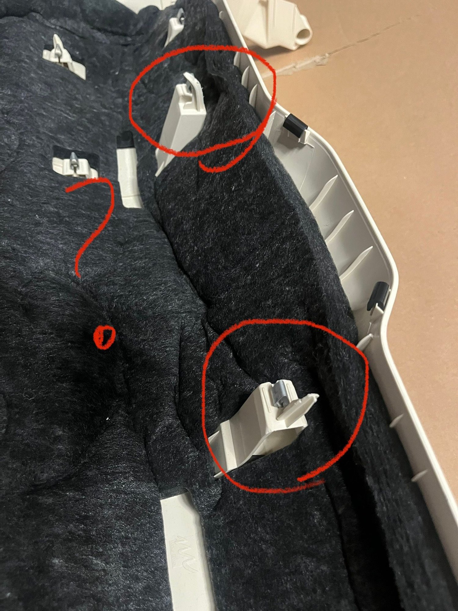

During the install, the entire plastic panel trim piece came down. For the life of me, I could not get it back in place. In the end, I had to remove it (there are 2 additional T30 screws on the sides under the middle trim pieces). I’ve watched a few YouTube videos showing the removal process but can’t find anything showing the reinstall. Specifically, I can’t figure out how to get these plastic pieces to engage? The other metal panel clips won’t hold until these pieces key into place?
Can anyone help?
Old Aug 18, 2023 | 07:44 AM
  #73
vkb123's Avatar
5 Year Member
Joined: Mar 2018
Posts: 372
Rep Power: 54
vkb123 has a reputation beyond reputevkb123 has a reputation beyond reputevkb123 has a reputation beyond reputevkb123 has a reputation beyond reputevkb123 has a reputation beyond reputevkb123 has a reputation beyond reputevkb123 has a reputation beyond reputevkb123 has a reputation beyond reputevkb123 has a reputation beyond reputevkb123 has a reputation beyond reputevkb123 has a reputation beyond repute
Thinking that maybe the “bent” plastic piece is actually supposed to be straight? I’ll check the FSM and the PET to see if I can see a diagram. Can anyone confirm this?
