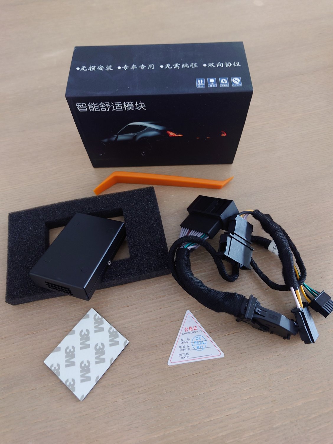

Originally Posted by lintdrummer
Just to update this: The seller suggested that I wasn't closing one of the connectors fully and it wasn't making a connection. He was right! All working perfectly now so thanks for the help and suggestions.
I also installed my dashcam today, integrated with the trim in front of the rearview mirror and a second camera on the rear window. The dome light and overhead console is a pain to remove and to reinstall but I got it all done in a couple of hours. I routed the cable for the rear cam through the headliner at the windscreen, down the a pillar, out to the rubber weather seal in the door, back in along the seam under the seatbelt height adjustment, along the rear door weather seal and again under the trim beside the rear headrest and into the upper weather seal on the tailgate. It's very neat with the only visible wire being a bit of slack between the camera and the weather seal on the tailgate. It's a FitcamX model. Looks good so far from the little test footage I've checked on my phone.
I'm glad to hear it's working now! That dash cam sounds like something i might do too... thx for posting an update

hi i've this module to close tailgate. I've buying it to aliexpress.
When i close my car the exterior mirror close too and when i put the contact they open.
All windows close too when i lock car. But if i don't want close the windows with i use my remote i push 6 time on unlock with drvier door open and the windows don't close when i lock car. Very good function. If i want close all windows i push 6 time on unlock button with driver door open

Originally Posted by Marc13190
When i close my car the exterior mirror close too and when i put the contact they open. All windows close too when i lock car. But if i don't want close the windows with i use my remote i push 6 time on unlock with drvier door open and the windows don't close when i lock car. Very good function. If i want close all windows i push 6 time on unlock button with driver door open
Hey @Marc13190! Just to confirm, when you press the “lock” button on the FOB your car locks and the sideview mirrors immediately fold?
Also, how did you find out about all these “extra” functions (eg. push button 6 times…)? Does it come with instructions explaining all these things?
Thanks!
Old May 25, 2023 | 10:37 AM
  #53
Marc13190's Avatar
Joined: Aug 2022
Posts: 131
From: France
Marc13190 is infamous around these parts
Hi yes when i close door the rearviews close too. The function (6 time) it's seller that give me this because on summer i don't wan't close windows.
