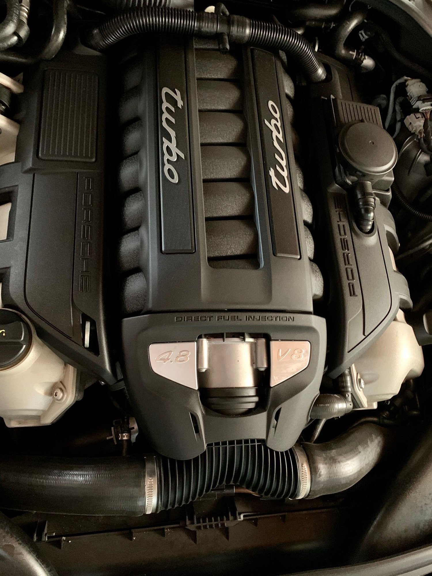

What do I need to remove to take a look

you could look without removing anything, but it will be a little easier if you pull the front cover - it comes right off, just pull up.
