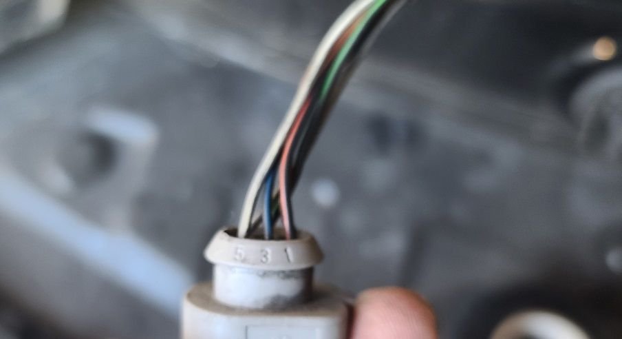

Hi guys! I am new to putting aftermarket DIY stuff on my 2010 Panamera but it's never too late to start right? I am rigging a aftermarket windshield mirror with reverse camera on my car but am having trouble figuring out which wire is my reverse taillight wire to splice the camera power red wire to for when I reverse. As you all probably know, the wiring harness has 6 wires labeled 1 thru 6 that go to one connector to the back of the taillight. I don't know which one it is and I rather not do trial and error and cut all 6. haha Anyone know which is the reserve wire for this car? I can't seem to find the answer anywhere on the forums or online. Any help is greatly appreciated.

do you have a multi-meter? you could measure the voltage on the leads and then have someone put it in reverse and find the one where the voltage appears
Sorry, no diagram.

The backup light is A3
