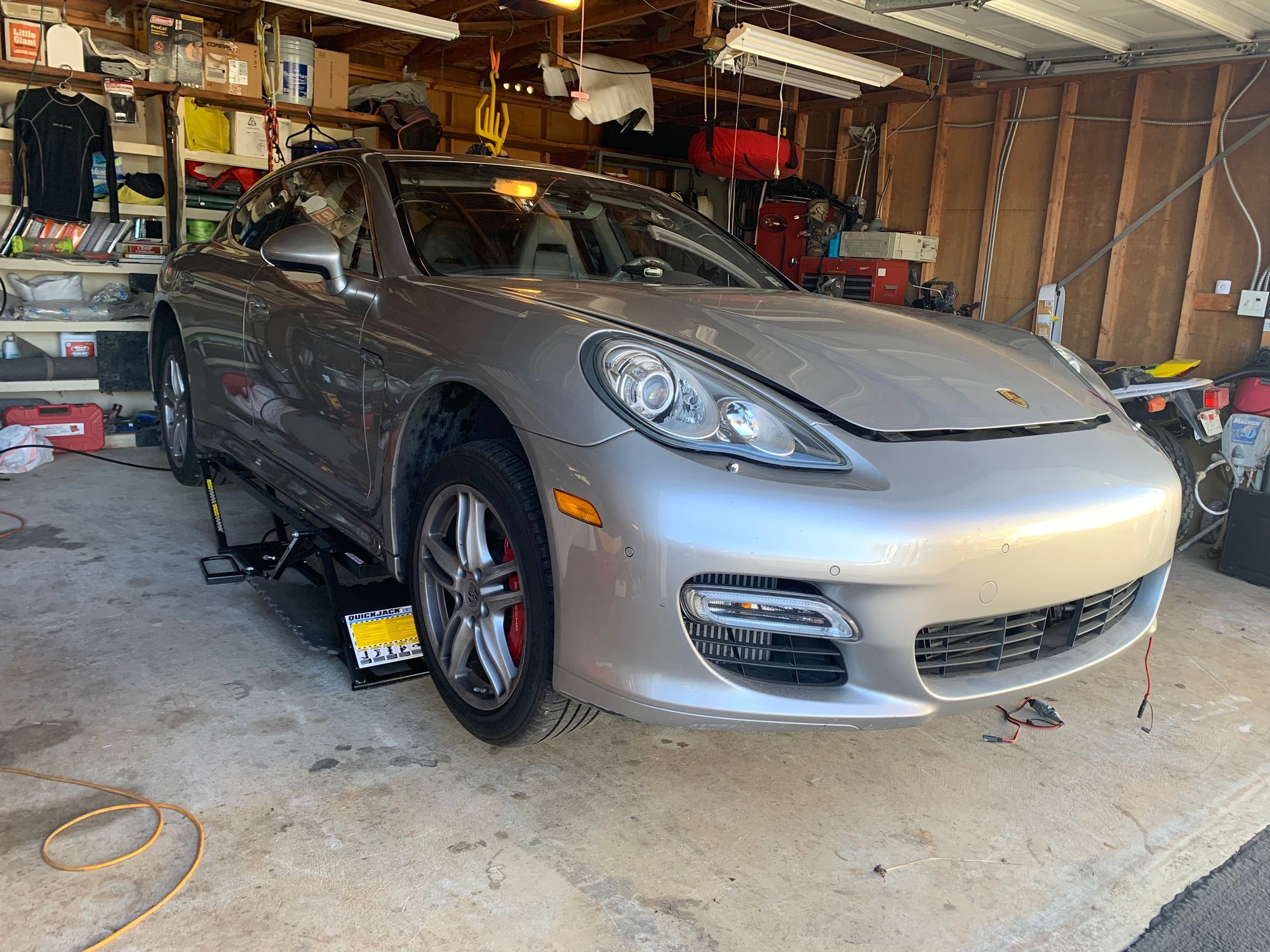

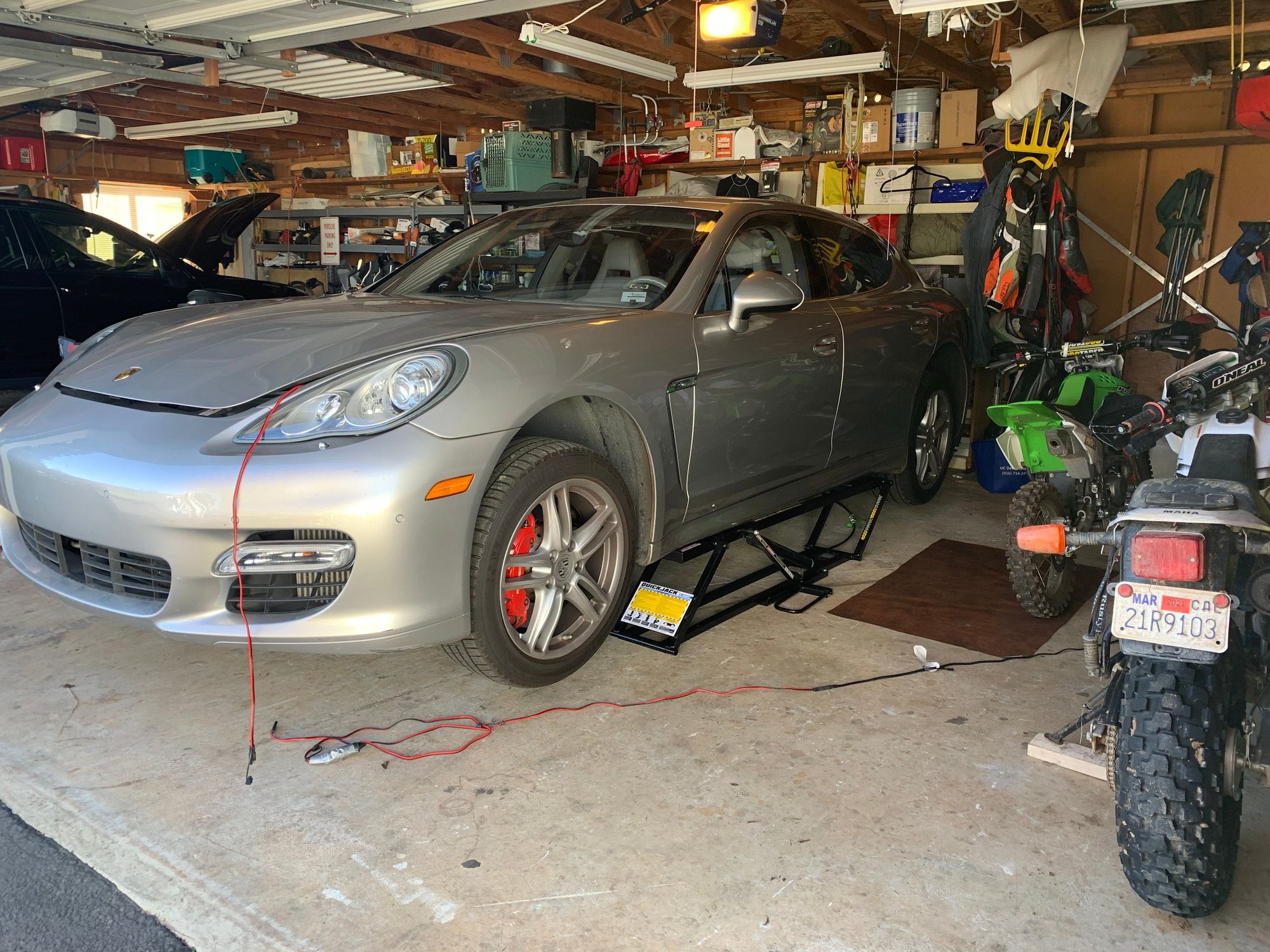

Thanks! This is as far as I have accomplished so far. LOL
At least quick jack works
I rather work on motorcycles instead of the Porsche. What a pain in the rear. Lol

Edit: Slap a jackstand under the rearmost upper lip of the quickjack when it is raised. The chances of anything happening are wildly slim, but better safe than sorry.

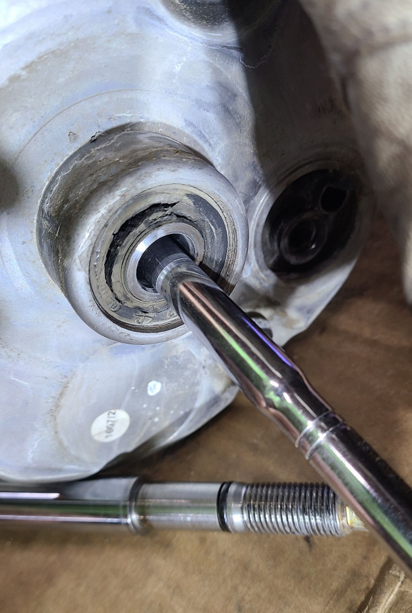

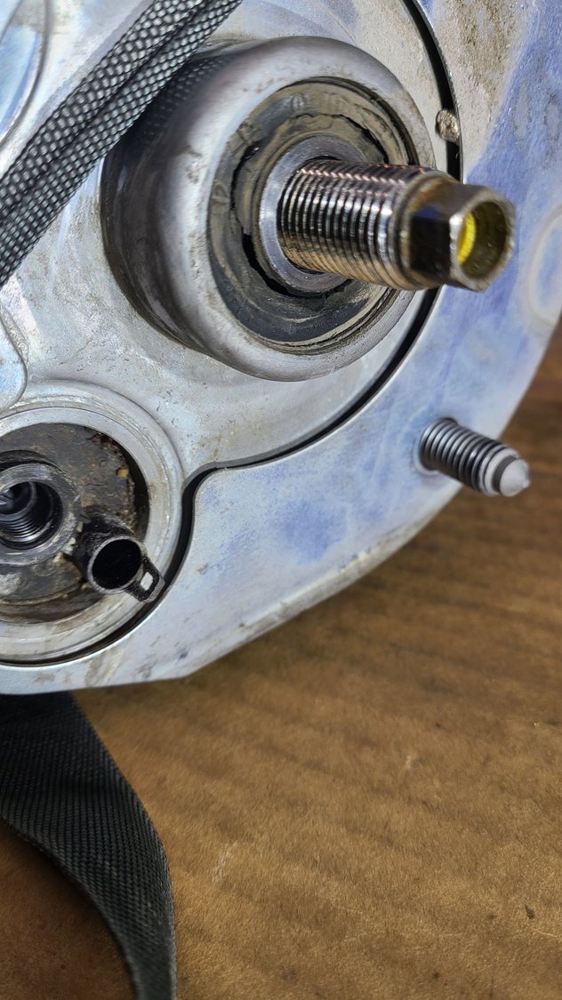

Pics! Severely cracked rubber with only 23k miles on it.
Hmm, wonder why this is leaking...
Old Feb 27, 2021 | 06:08 PM
shrike071's Avatar
Joined: May 2020
Posts: 207
From: Atlanta
shrike071 has much to be proud ofshrike071 has much to be proud ofshrike071 has much to be proud ofshrike071 has much to be proud ofshrike071 has much to be proud ofshrike071 has much to be proud ofshrike071 has much to be proud ofshrike071 has much to be proud of
LOL. Yeah, no big mystery there. Man, I've never seen one that bad. Sorry you got hit with the bigger repair!

It looks like the cracked bushing could be pressed out and a new one pressed in but I can't find any individual parts like that anywhere. So I guess I'll have to order new air springs. With the dry rot I've seen here I think new ones will buy some peace of mind.
