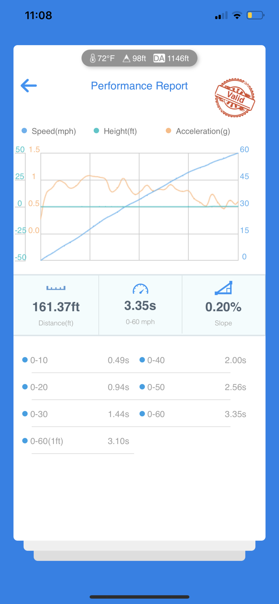

before installing the mid pipes my best 1/4 mile was 11.39 at a preped tracked (before I had the dragy), but usually it was a mid 11.5.
my most recent numbers after install of the mid pipes on straight shell pump 93.
* still fighting traction issues on the pilot super sports, I have a pair of 295 trofeo R’s I might throw on there or hold out for a set of R888 but I rather keep the OEM size because of the AWD system.
best 1/4 mile 11.1 @120
also ran a 11.19@124 not sure how I got an extra 4 MPH.
0-60 3.3 (I had a 3.2 but it was invalid in dragy because of the slope)

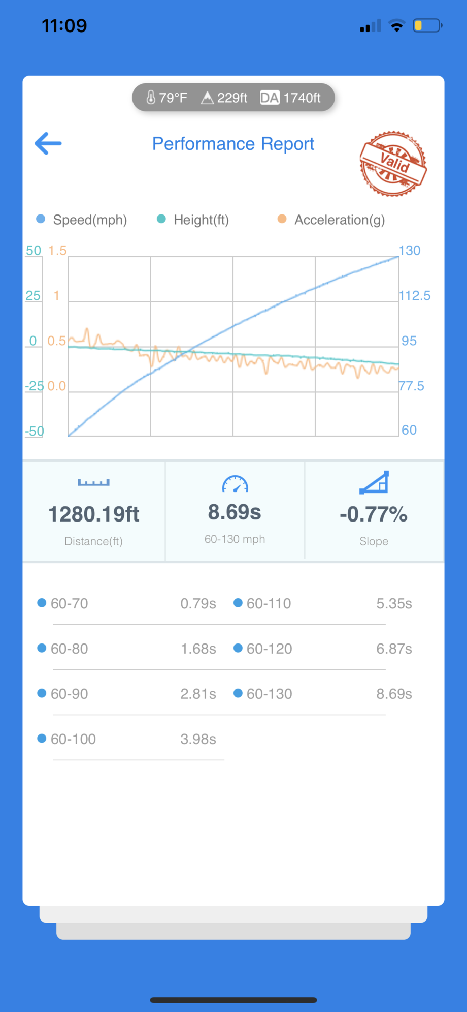

60-130 best was 8.69. This was surprising for me because usually yesterday it ran a low 9 on the only 60-130.
im hoping once I get some better traction I can get into the 10’s I have seen low 1.6 60fts at the track.
overall this car never fails to perform its an incredible car and a great car for the value. These cars a Engineered to be driven and Porsche has done a great job over building these cars to handle the power.
you can not really beat the value and appeal of the gorgeous interior with all this power.
here is the data from the dragy.
