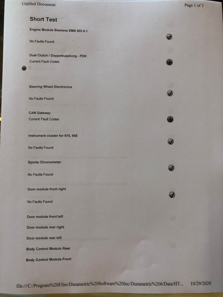

Guys,
I did my inspection and got some read codes I wanted to run by you .
800808 brake light switch signal implausible - any idea?
c13314 communication with slide/tilt roof (rear 1) - mechanic told me the fault for rear slide/tilt roof shown in photos is a ghost fault with a non -Porsche scanner. Not recognized with Porsche scanner.

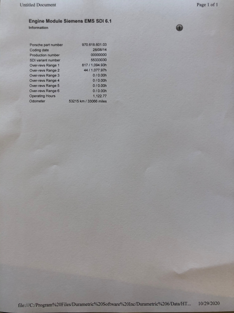

DME scan - looks good no over revs ignition 3-6
On short test I have an exclamation on PDK and on CAN gateway - Any idea what are these?

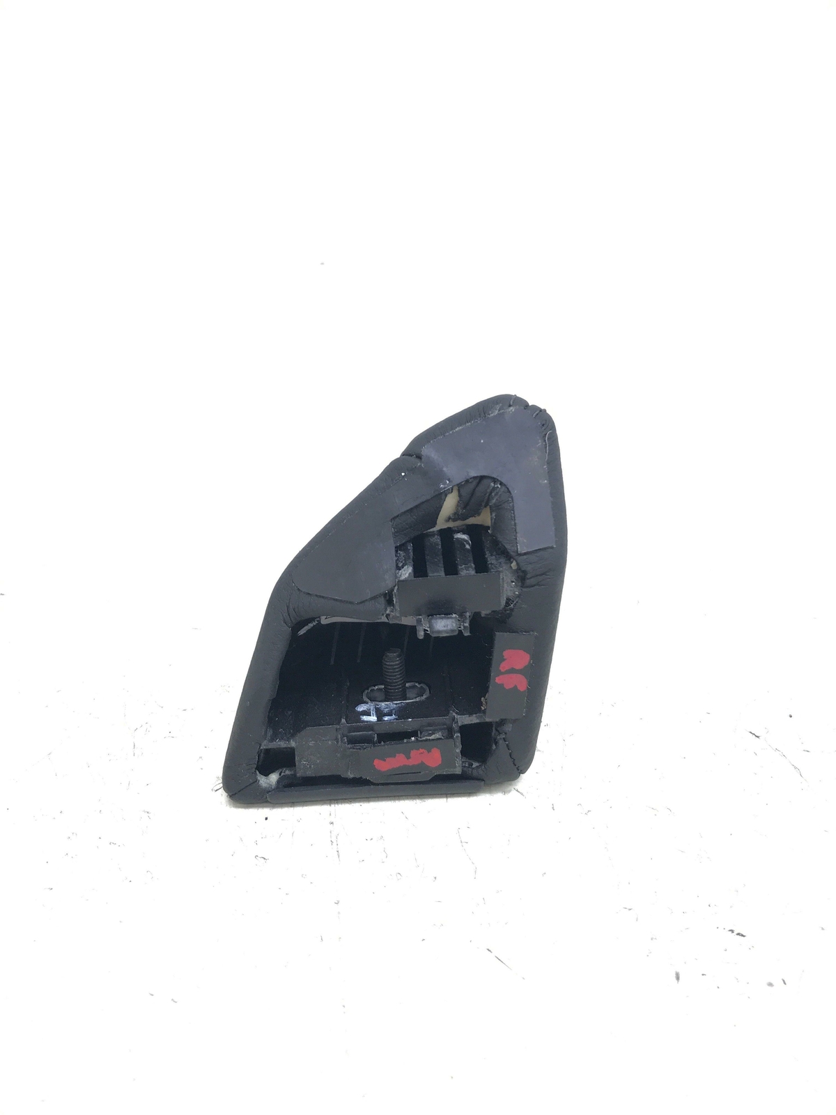

Last, there is a loose interior part by the door. - Easy fix?
Thanks !

There some photos on ebay that might help figure out how it's secured, here's one..
https://i.ebayimg.com/images/g/kFkAA...s3/s-l1600.jpg
I searched on Panamera armrest end door and switch to the image results

There is a torx that holds the arm rest extension piece - both of mine were loose and easily tightened. Good luck!

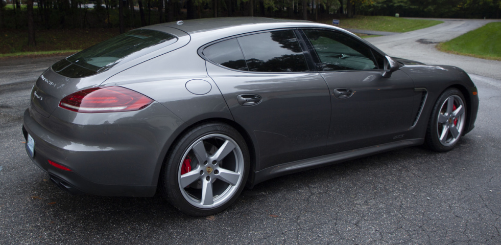

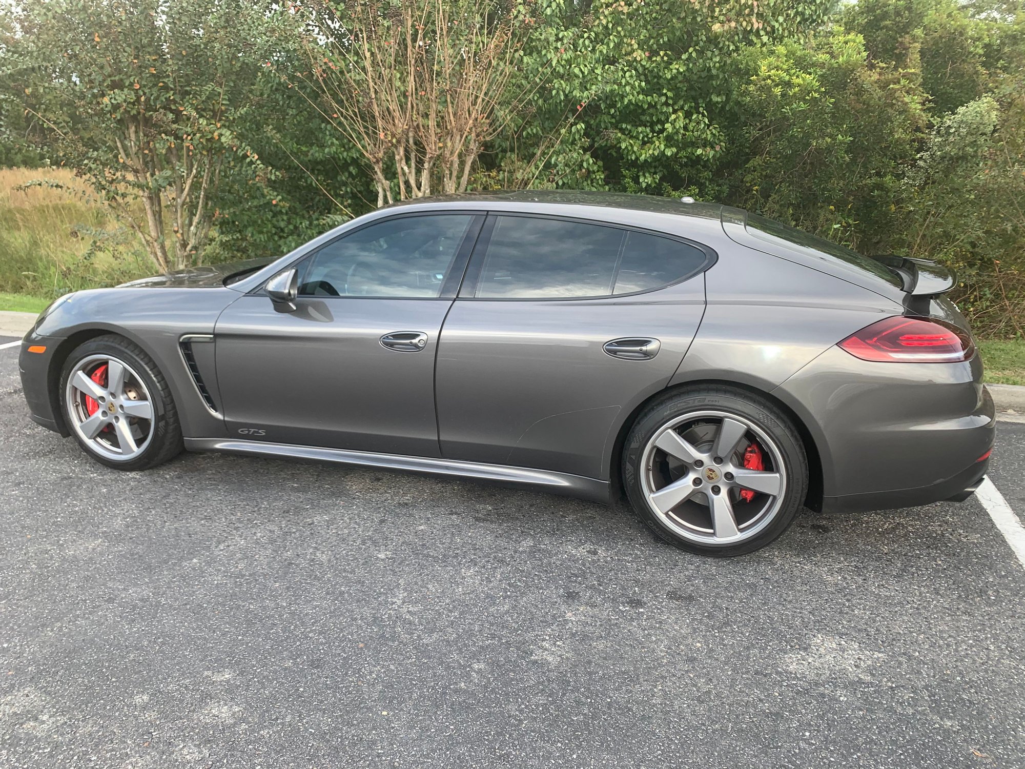

Guys thanks for all the help and especially Mike for responding to my questions! I was able to drive this beauty home 2015 gts 33k miles from Richmond to Miami 1000 miles . Never a dull moment so much torque , and fun 😀 First time Porsche owner and I love it !!!
