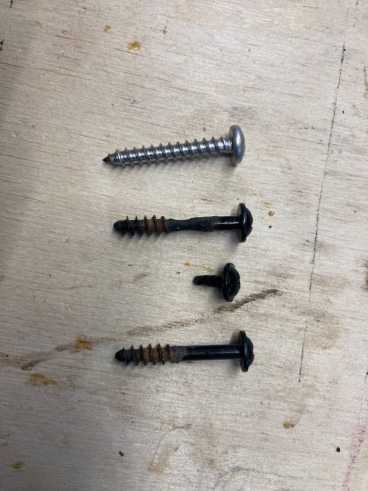

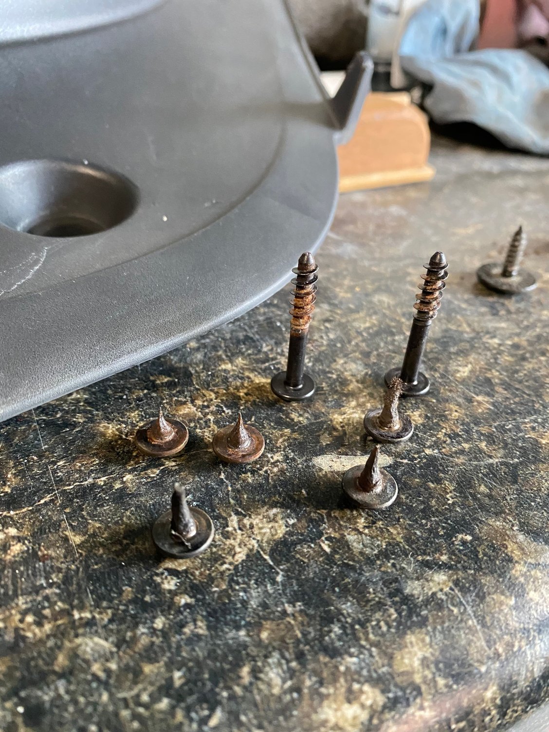

All but three screws that hold the air box together were corroded beyond recognition. I tapped it and added new screws but I’m going to order another one to replace it.
What was left of my screws.

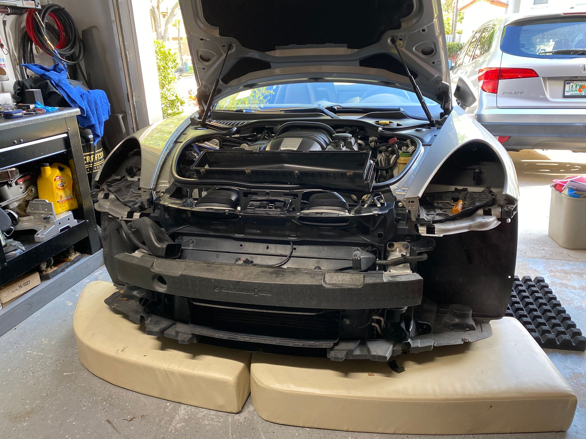

Was actually very easy to remove the bumper.

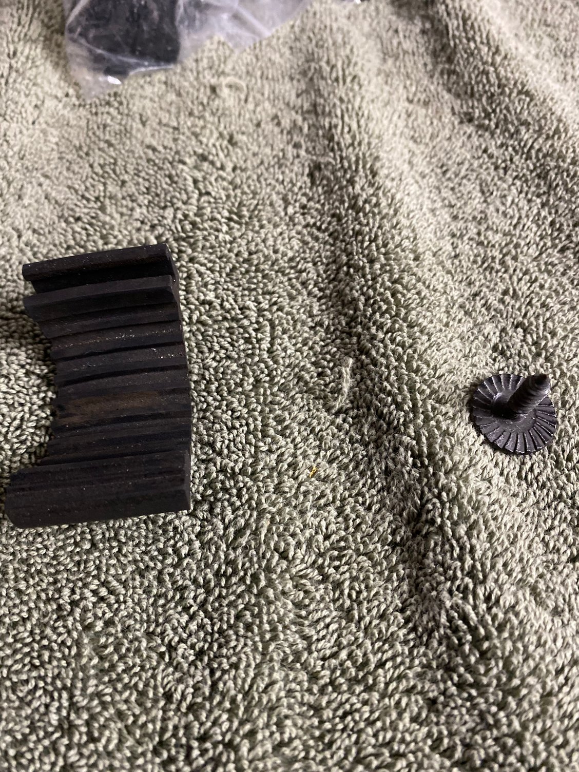

Had one screw which I found where it went and this other part left over. I couldn’t figure out where it came from. Can off the drivers side when I pulled the bumper.

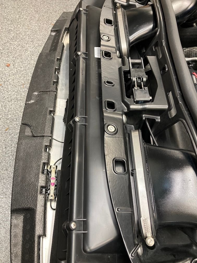

I did this same job (air cleaner) this past week. Exact same issue --- only the center 2 screws in front were corroded completely - I was able to remove the other 6 carefully. Only the front ones were significantly corroded. Replaced with SS screws. Did the same drill out for the two that were broken.
I did slightly drill out the top section of the air box so the screws would properly pull the airbag back together when tightened. (Since they were fully threaded)

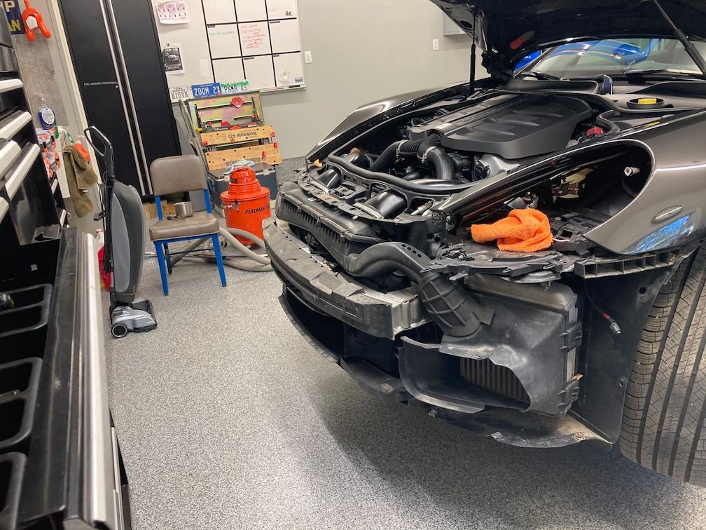

I did take the time to clean out the radiator, intercoolers, and other "hidden" front end areas.

new SS screw , front corners, front center, rear
new screws in place

Yeah, I vacuumed and cleaned my radiator are too. It was insane the amount of leaves and debris that was in there, jammed in the sides especially.
