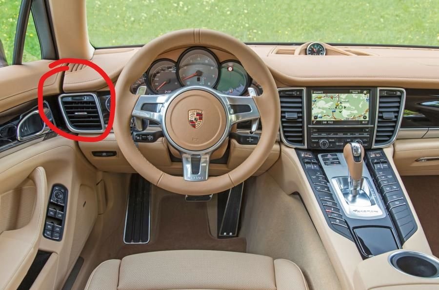

Old Jul 2, 2020 | 02:36 PM
mlrtime3's Avatar
Joined: Apr 2020
Posts: 9
From: NYC
mlrtime3 is infamous around these parts
Opening this back up, I hear rattling coming from the area circled in the picture (although it's hard to tell exactly where), it happens when hitting any kind of bump in the road. On the highway it is constant rattling if there are any bumps.
Any ideas where this is coming from?
Old Jul 5, 2020 | 07:52 AM
OEkun1's Avatar
Joined: Mar 2016
Posts: 550
From: Phila
Rep Power: 35
OEkun1 has a spectacular aura aboutOEkun1 has a spectacular aura aboutOEkun1 has a spectacular aura about
My suggestion would be to see if you can replicate the noise by tapping/smacking the dashboard while not driving...it could be something broken in the vent. Worst case, pull out the vent to check back there.
