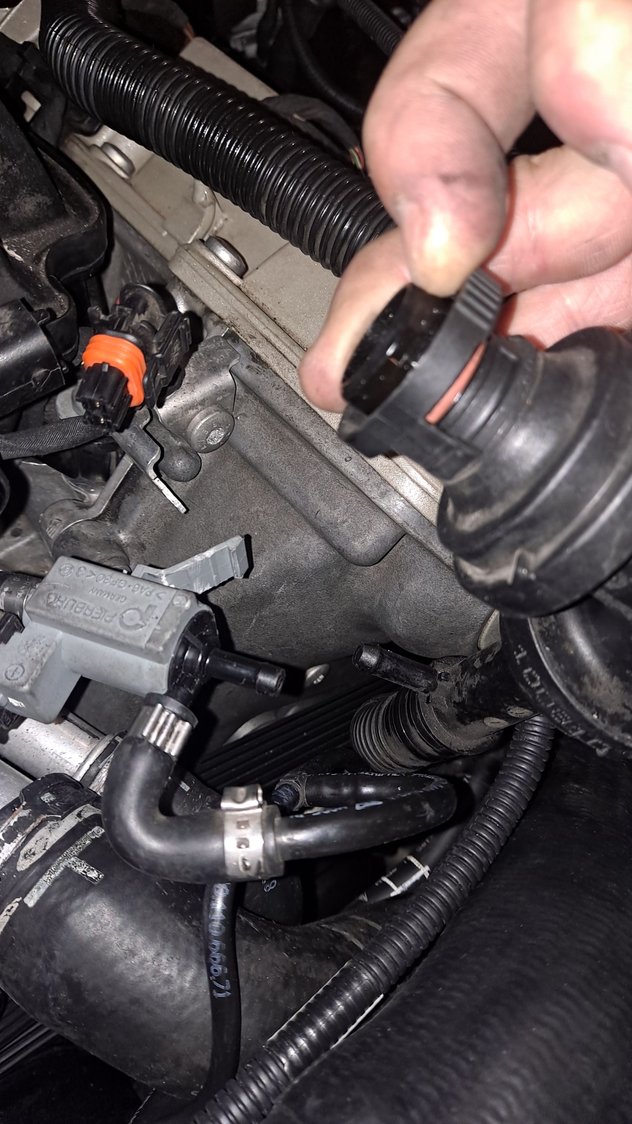

This is the 2nd time now I stopped going to the dealer because they returned my 2011 Panamera TT with missing fuses in order to make me come back. Now this independent shop tests the car for a turbo leak sends me the car black no hose at the cycle valve or the manifold next to it.
some one please see the pictures and tell me where to reconnect? I would guess they plug into eachother, they are different sizes though. I better ask here. I bought the repair manual, it helps but not enough thanks.
These two connections are right next to eachother. The new codes after they did this was related to overboost reduced power and pressure ahead of the Tb.

Almost your 1st pic #2 hose, I see the drawing of a small line there. It's removed or tucked in somewhere being held by the other end I hope.

My picture here I still need to connect number 1.

Number 2 is supposed to be missing cause I found it on this other thread called missing vacuum line.

Here she is. My best guess is to leave that turbo solenoid disconnect. If so my scanner fault code for improper pressure ahead of throttle valve is electric.

Thanks guys. Yes these images are better. I saw an engine picture that showed the boost solenoid also unplugged. Just need 1 TT owner to validate this finding please. Thx

I think they all are missing. When I took off my manifold I thought it was disconnected but it was like that before. It a check valve maybe vents to atmosphere.
