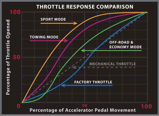

The term OP is looking for to describe the car moving without pedal input is "creep" in industry terms. In traditional torque-converter automatics this was a natural effect, in modern hybrids and dual clutch systems this must be designed in and "tuned" and can vary a lot based on what each manufacturer considers ideal.
The sluggish pedal is a totally different phenomenon. That is the "throttle mapping". Below is an image I snagged from a google search (i.e. just a generic example, not an actual Porsche throttle map). It is simply a ratio of how much the computer tells the throttle to open based on how much torque the driver requests (how far down he pushes the A-pedal). The only thing that products like Sprint booster do is to exaggerate the curve of the throttle map to something like "sport++" with a large initial slope and a large "knee" where the throttle response flattens out in the second half of travel. Basically they take a throttle pedal that travels 4 inches and make it only use the first 2 inches of travel, so that when you push the pedal down 1 inch you say, "woah, this is so much faster!" but it really isn't any different than if you had just pushed your pedal down 2 inches before installing the sprint booster.
Probably similar to HP41, I strongly dislike this kind of artificial non-linear throttle response. I drive with engine map in "sport" as I find it closest to linear (linear = ideal IMO). If I want more torque, I press the pedal more, and I want the engine response to be equally proportional at any point in the pedal travel.
question for you, so i have that same "creep" issue on my panamera, when i am backing into a stall sometimes i dont get the smooth "creep" effect when letting off the acceleration....a normal torque converter will give me a good/consistent amount of vehicle movement as i let off the brake pedal but with the panamera sometimes as i let off the brake pedal the panamera barely moves and i have to press the accelerator to get any movement but if im backing into a tight stall sometimes its too much movement when pressing the accelerator (because i have to press further down and there is a delay in getting the vehicle to move) i get the jerky/lurch effect cause the acceleration wasnt smooth. Hope that makes sense. Would the sprint booster fix this issue? Not sure if original poster has this same issue.
