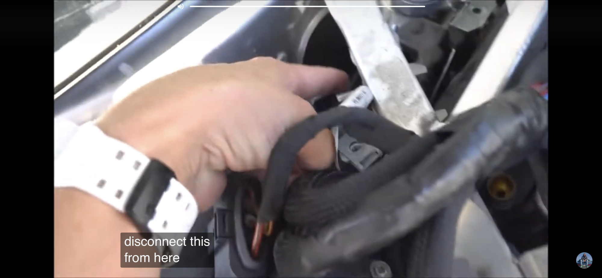

Removing the wiper assembly and have these two connectors on the passenger side bracket. I already broke one and spent 2 hours trying to remove the other one and scouring the interweb, but don’t want to break it.
anybody know how to properly disconnect this??
From JZchen back in 2020..
https://youtu.be/5c8HB07AaLw?si=ysv9yw4NE3DyN073 17:00 mark

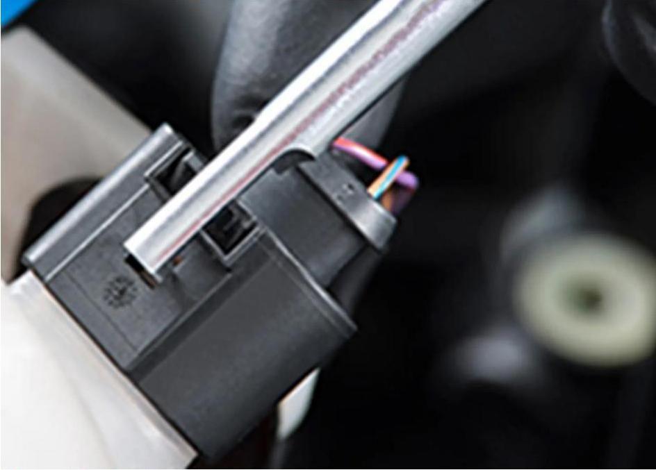

Hi for connector you need have this tool :

Thanks for the reply Marc. So, I'm able to disconnect the male D connector to the female by compressing and pushing the tab down then pull. But my issue is the female D connector is secured to the steel bracket arm via the broken clip that JZchen is holding in my first picture. do you think that connector will help remove this from the harness on the steel bracket arm.

Hi the first tab is broken but the second is ok it's possible that tool can pull out the connector.
You can make un tool with a screwdriver and you twist the end of screwdriver with pliers
