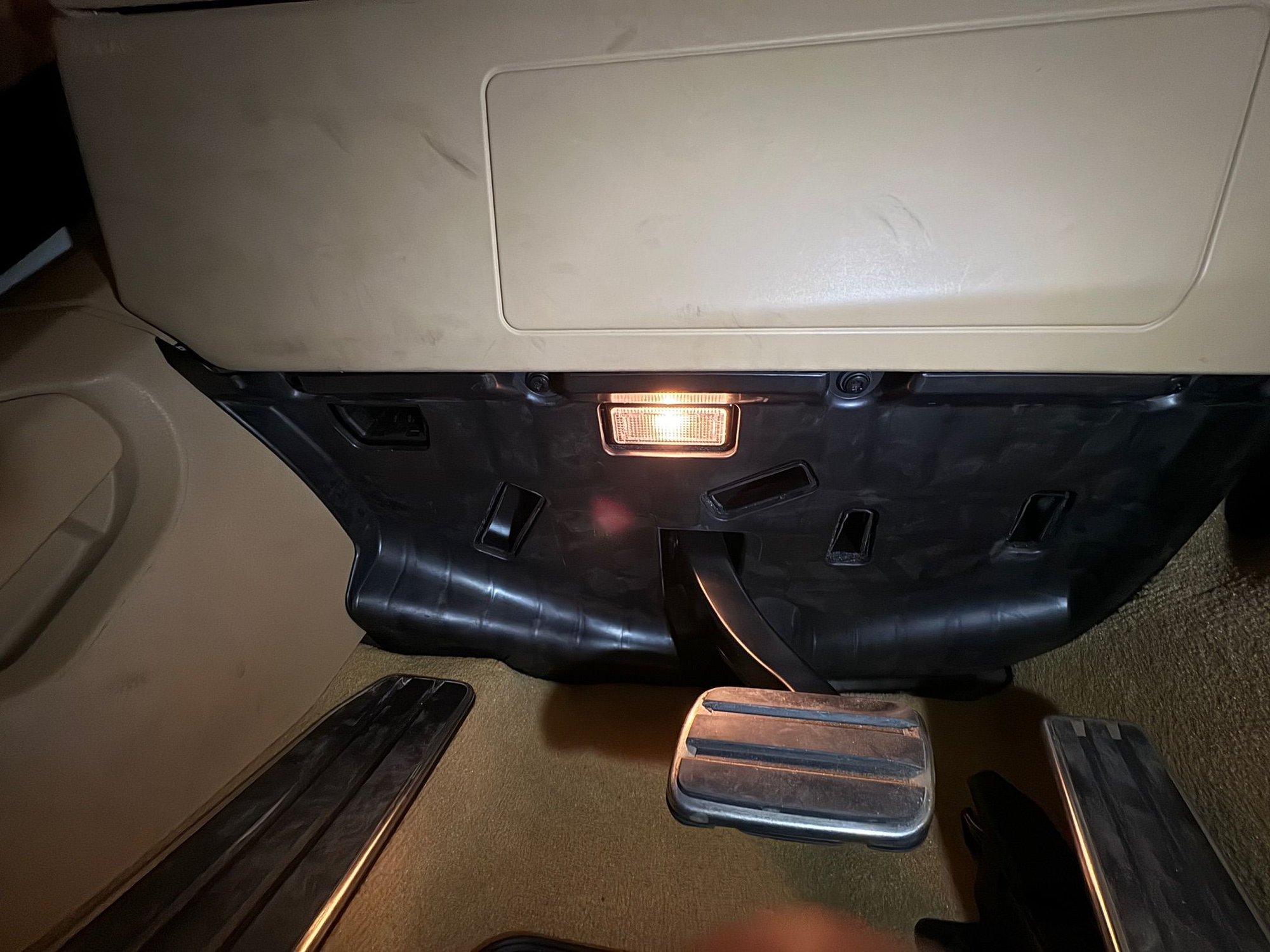

Where is the 970 port to connect to iCarsoft V2.0 scanner
I brought an iCarsoft V2.0 scanner for 2016 Panamera. But I can't find any port under the steering wheel to connect the scanner (see attached photo). Where is the port? Is it behind that soft plastic yellow panel?
Thanks,
Photo taken from floor of driver seat

For 970 is here :

Just checked. But that hole is empty at least for 2016. Do I have to remove that black panel?

Yes i think you need remove the color trim
Look THIS

I removed the panel and found it. It must be push all the way in during the service or emission test.
