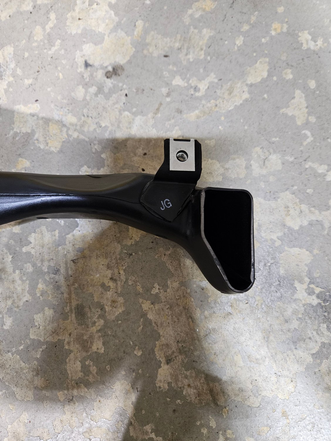

    There are 3 visible screws (T-15) that come out easily. But wait! The 4th screw decided to play hide-and-seek. It’s lurking behind a plastic vent tube.
  2. Deal with the sneaky vent tube.
    To remove the tube, unscrew the bolt (T-20) near the footwell light (look up for it). Slide the ducting to the left and pull it down. Don’t let it win. You’ve got this.

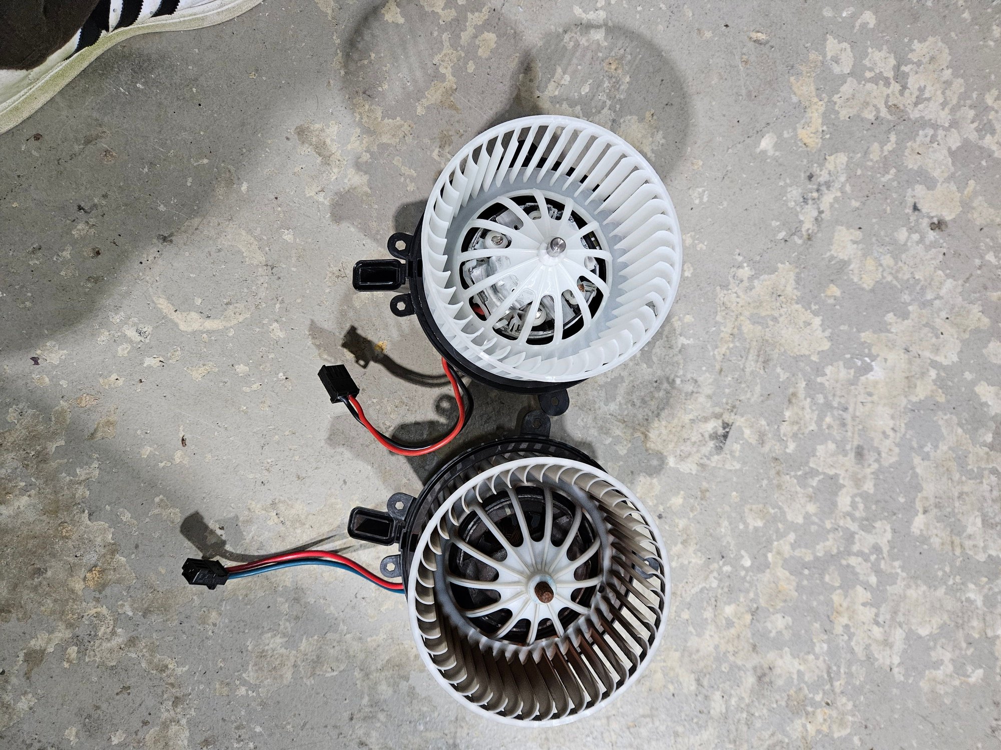

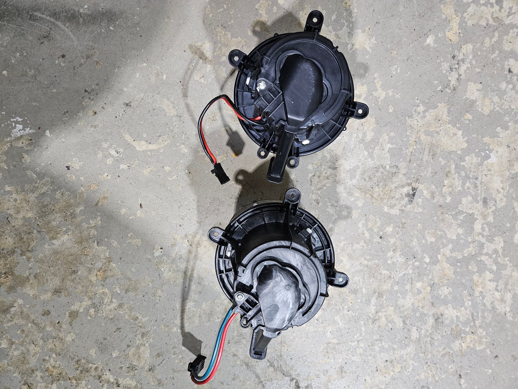

New vs Old
New vs Old
Vent tube which needs to be removed

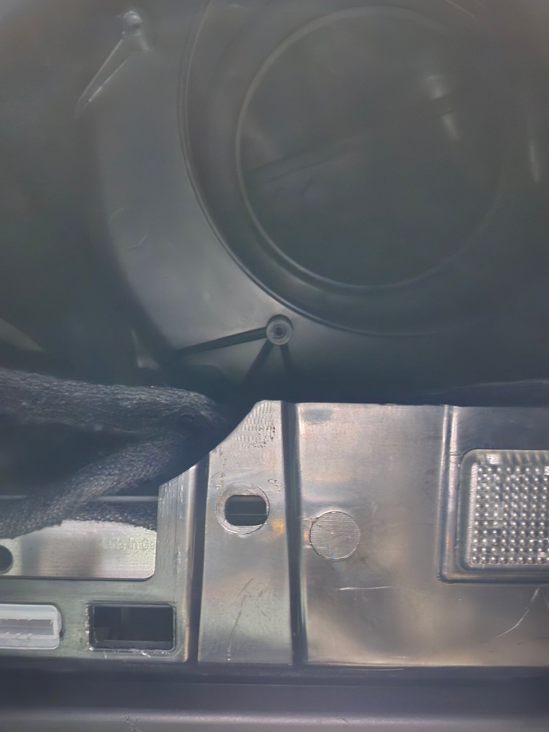

T-20 screw goes in here...
...through here.
...through here.
