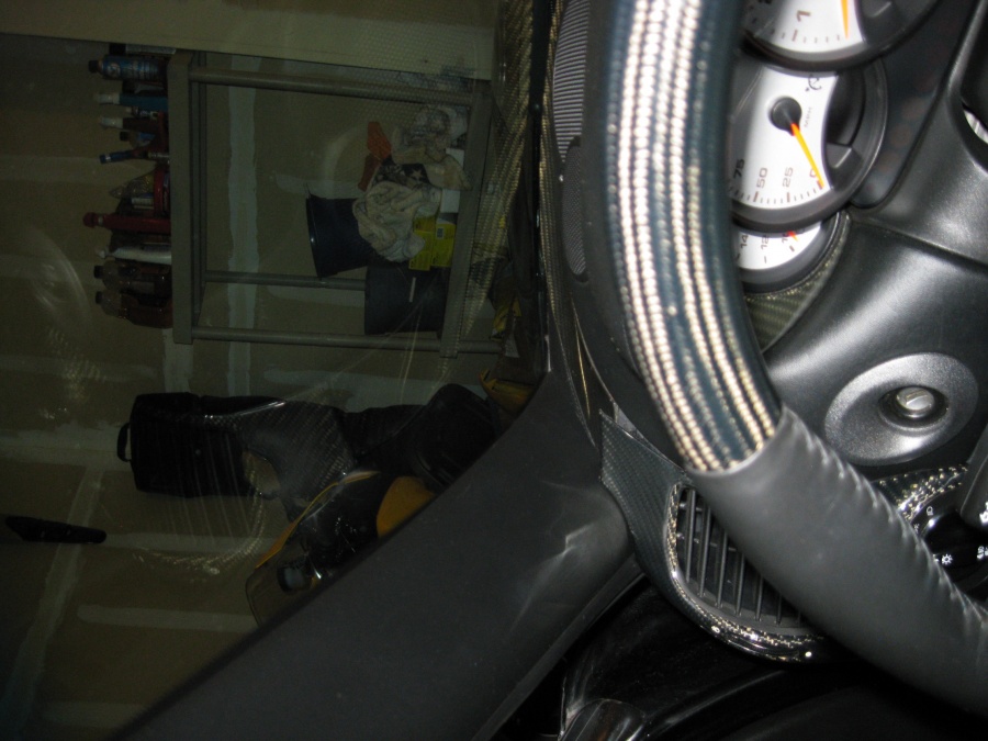

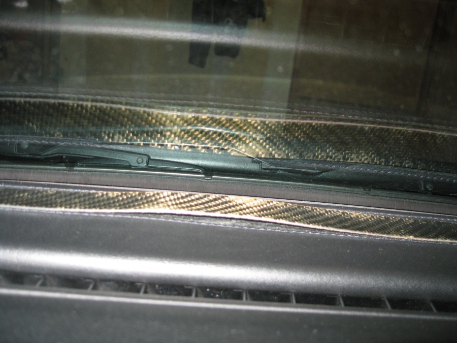

Well I've had my carbon fiber in my 996 for quite a while. Some of the dash trim is peeling back and coming undone. What should I do in this situation? My cf consists of Gemballa and factory pieces so buying new ones is very expensive. Is there a particular glue/epoxy that works best? If figured if I do the heat treatment plus some kind of glue, it wouldn't be perfect, but at least it would look decent. Any input is appreciated.
depending upon how deteriorated the current piece is and how complex the curves are id maybe consider fabricating the piece myself. im not familiar with the dash of your car; could you possible upload a image or link us a generic one from google or the likes? if the piece has larger radius curves this could very well be a beginner's project. the difficulty often comes with pieces that have tight radius bends because the fabric's weave becomes distorted and naturally wouldnt rest in the position your asking it to setup.
as for repairing the current piece. typically when polyester resins and epoxies cure the top layer becomes that of a waxy based one. the problem is then the finish if left raw will be less transparent and also if addition coats are added they wont bond well with the other layers. having said that if you plan on trying to restore the current piece id recommend wet sanding to clean it up thus promoting better adhesion with next coat of resin/epoxy. you can go to a lowes or home depot and get polyester based resins that will work but id advise spending a little extra and getting an epoxy based system. if i recall correctly the expoxies are a less toxic to our bodies when inhaled(should use a mask regardless) and also they tend to have a clearer finish and most the time are more resilient. because of the various expoxies available its important to get one that is well suited for your particular job. i lack the knowledge to recommend a specified type to look for but most manufacturer are happy to explain this all to an open minded customer.
at this point could you post a image to help us better assess the chances of a diy'r being able to pull it off first time.

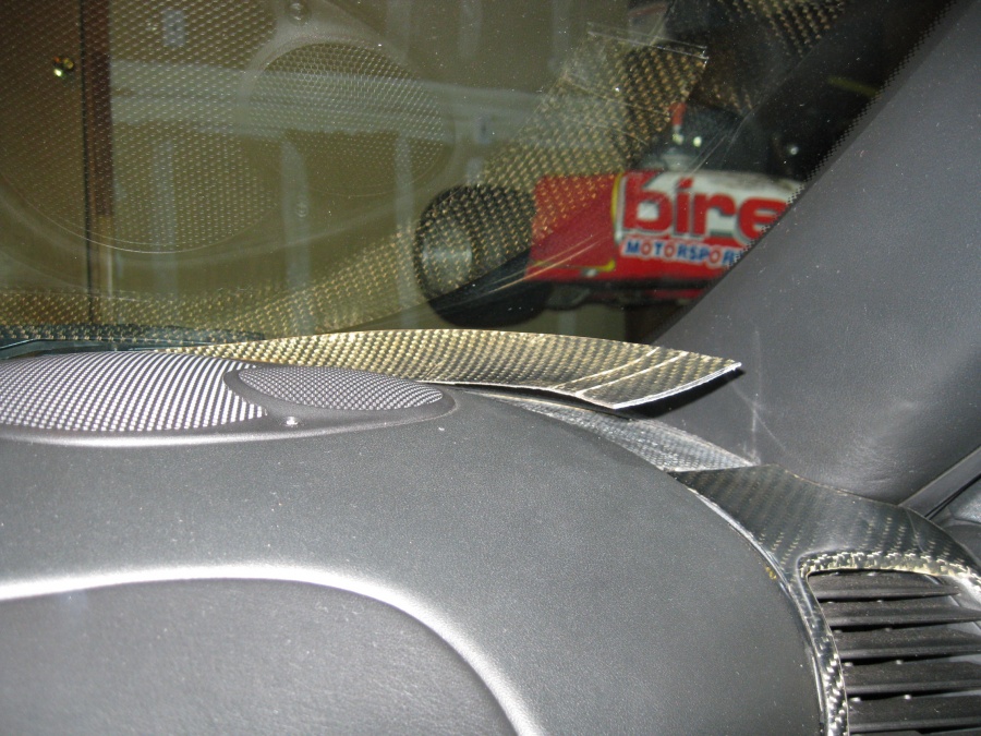

with the exception of that last image with the cf lifting near your gauges the fixes are something i think a typical diy'r could tackle successfully. the last piece being the exception because of the more radical radius's involved relative to rest of pieces.
i believe the reason the pieces tend to lift is because the expansion rates of the materials being different; cf and the dash/trim pieces. having said this im not sure id try and fix the current problem areas without removing the trim pieces because of the mess that is inevitable. the downside is that the manipulation typically required to extract trim pieces will undoubtedly make more problem areas; possible suggesting doing the job all over. im not sure the quality of restore your after but i foresee different colors amongst the new pieces you would try and make and that of the pieces that have been exposed to uv light the last x number of years. if you can tolerate the imperfections a little longer id suggest having someone look at it and possible get a quote to repair. id imagine that most porsche owners time is worth more than mine and theres would much less anxiety involved in having someone else resolve the problem.
i think a realistic fix would involve the removal of the plagued trim pieces and some localized heat (110degrees fahrenheit maybe more than enough depending upon epoxy used) to help make the cf more malleable(sp?) to prevent cracking. than youd need a system to help keep the cf tight to the trim as the adhesive cures. a vacuum chamber comes to mind. this is also the typical way the composite industry will form pieces. i believe those pieces can all be repaired but maybe someone else with more experience would suggest otherwise. if for some reason the pieces need to be made and you have a desire to get the best overall look is suggest having all pieces made again. the alternative is to then wet sand all the remaining good pieces down to the cf and than apply a new top coat this will remove most/all of the yellowing uv damaged cf. if you do wet sand just go carefully and when the milky residue turns a gray it indicates youve burned into cf. if this is a project youd consider im sure the forum can provide addition tips; ill hold off on any more till i hear your game plan.
this project has the potential to provide much satisfaction should you be successful but it may also kinda be out of the question because the time involved. what is your time worth?

exposing most interior's to the sun's rays will result in whats imaged above. one can drive sparingly during high sun and spend copious time applying protective products to exposed surfaces or they can accept the risk and enjoy other elements of the car; perhaps lateral and longitudinal agility.
