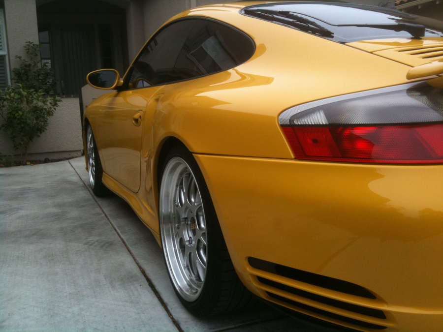

Hi guys,
I just got a set of 19" BBS LM-R with 15mm spacers for the rear only which was recommended, but the wheels look too tucked in. I like them to be flush with the fenders. I'm planning to move the rear 15mm spacers to the front, and get 20-25mm spacers for the rear. Any suggestion or recommendation? I've been searching the forum, but it seems like the most people use is 20mm for the rear.
thx,

Great looking wheels, but they could be pushed out a bit more. Sent you a PM with some comments/questions...

You know the offset of the wheels? they do look a little chicken leg. I would spacer's from Champion or Hnr , make sure they are hub centric.

Here is the wheel offset and i'm using 15mm H&R Trak spacers in the rear currently.
19 x 8,5 et55 (235/35/19)
19 x 11 et63 (315/25/19)

That's because BBS doesn't make the LM-Rs in a more aggressive fitment than those that you have.
You have two options:
1. Reverse Lip - Pretty hard and you can mess up your wheels in the process if you have no idea what you're doing. It looks sweet though! Might be a little TOO aggressive for you.
2. Run spacers. With those offsets, you can run 21mm H&R Hub Centric Spacers and it should be fairly flush with the fenders.

Thanks Eddie. I'll choose option #2.

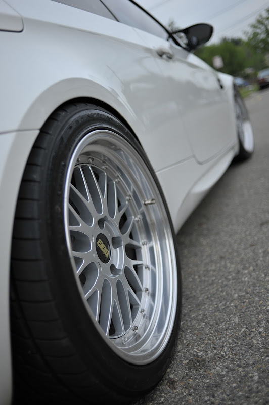

This is not recommended by BBS and you can royally screw up your wheels doing this if you're not careful - but there's plenty of guys that have done Reverse Lips on their LMs and LM-Rs.
Here's one - You won't see LMs come like this from the factory! :
There's a few brave souls that have done this on Porsches as well. Oh and there's a member (HighCard) selling his set in the Classifieds right now! The whole Reverse Lip is a bit hard to do and if you get it wrong - you have a leaking set of BBS wheels!
