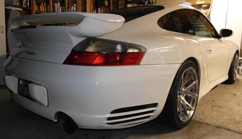

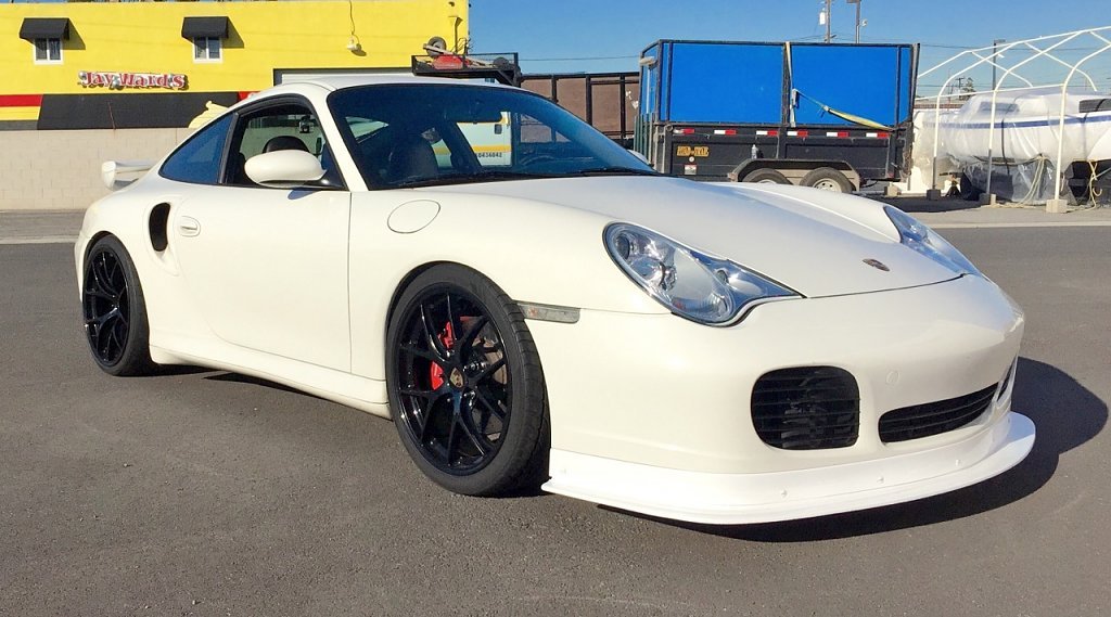

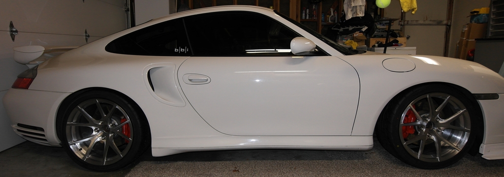

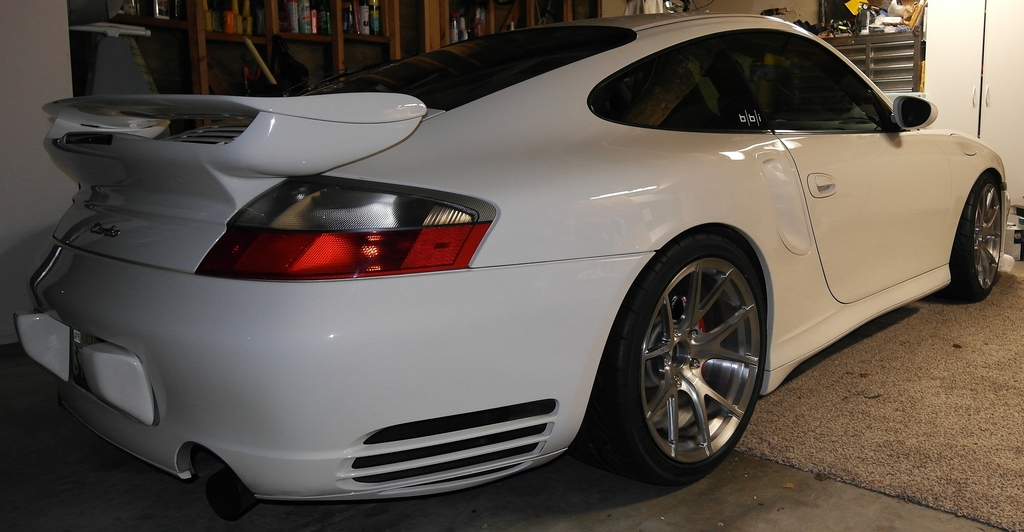

18 x 8.5 et45
18 x 11 et38
Stock tire sizes (for now). Pushed out an additional 7mm front/rear.
Ball seat.
