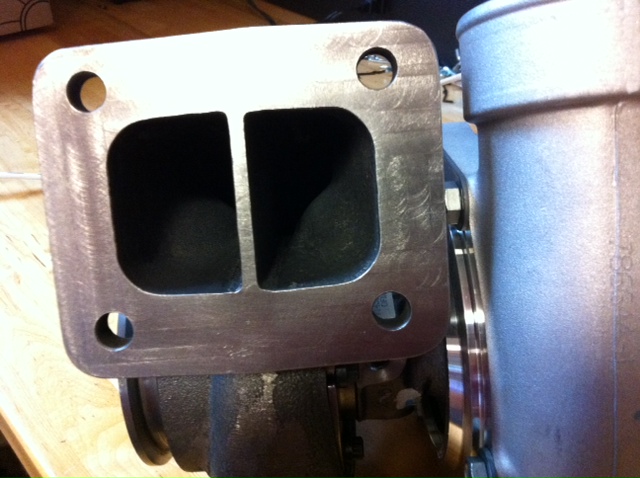

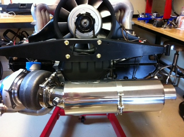

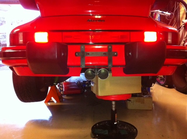

I went with GSF IC, TiAL WGs and Rarlyl8 headers & GT3 Muffler setup:

Captain, that center outlet is going to be bad assss. Are you just going to run a straight pipe directly from the turbo? The Muffler you had pictured allows for a passenger side dump. The Zork Tube we offer allows for a center dump below the stock valence, but since you already have the piece cut, the Zork might work best and you can customize tips to fit.
Leadslinger and 9eleven we have all products in stock for your 930's. Our mufflers will fit the stock turbo and the K27 if you have that installed, here's a video of our '87 Slant with the products installed:
http://www.youtube.com/user/Fabspeed...13/fPg92WBcy-8

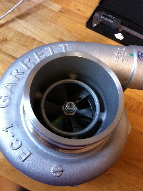

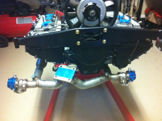

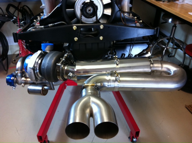

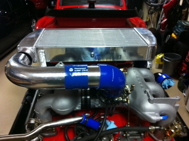

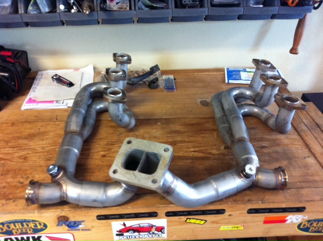

Thanks Joey, here's what the whole setup looks like:

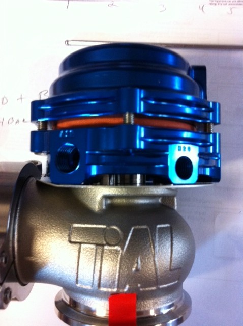

Wow! That looks sick! What turbo are you using and why are there 2 wastegates? Is that because of the exhaust? How much horsepower do you think you are producing at the crank?
Thanks!
I decided to go with the Garrett GT3582R twin scroll matched with true split headers, so 2 waste gates are needed...one for each bank.
Shooting for 500 at the wheels
