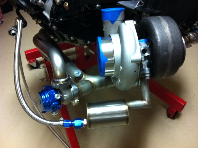

reclocked turbo
re-reclocked turbo for best drip tank fitment

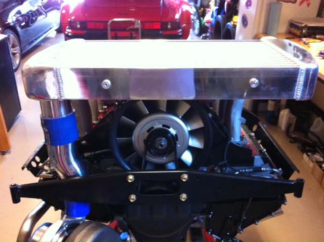

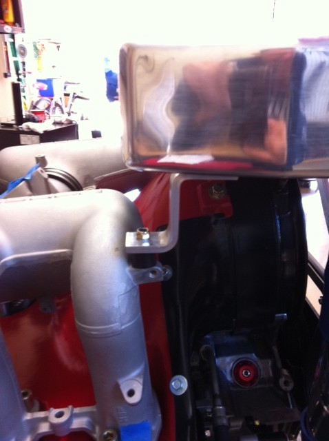

IC fitment
This IC should be big enough

That's a whopper. Are you planning on street car or track. Heat sink much less of a consideration if car is not tracked.
Old Nov 1, 2011 | 12:00 PM
  #127
CaptainCalf's Avatar
Joined: Jun 2010
Posts: 212
From: Chapel Hill, NC
CaptainCalf is infamous around these parts
no track, just a sleeper car for the street

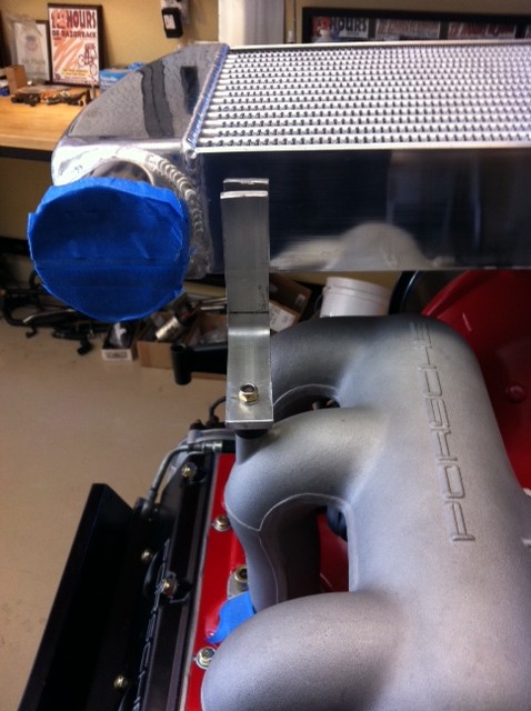

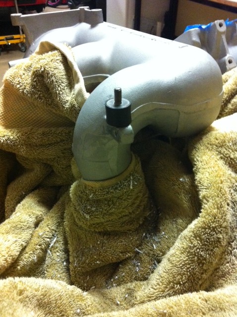

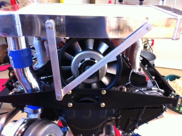

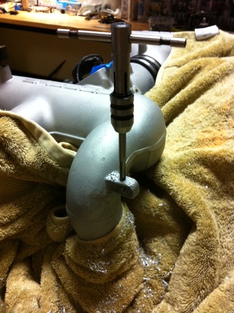

IC Mounts
fabbed up some mounts for the IC outta 1/4" Alum bar and drilled and tapped the Carrera intake for an additional bonded rubber mounting point.

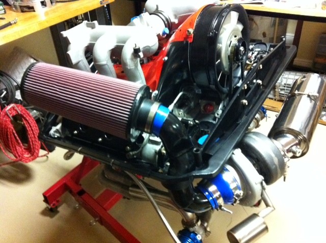

Air Filter
Is this K&N too small?

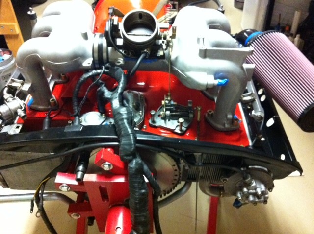

3.2 throttle body
I reconfigured the 930 throttle plate to work with a 3.2 throttle body

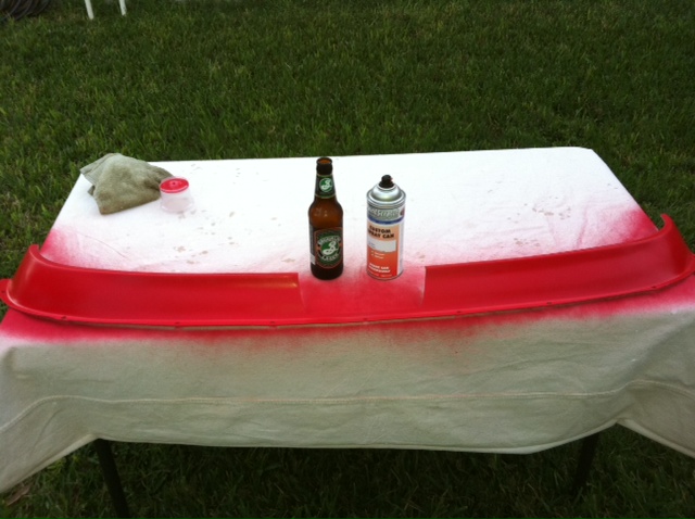

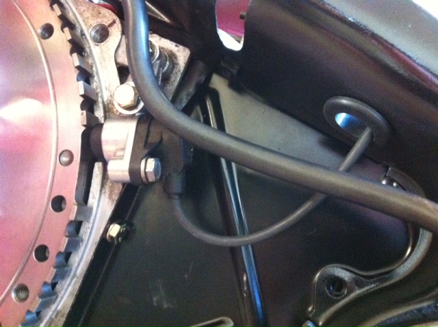

GT3 Valance done, crank pos sensor and IC plumbing sorted
more progress

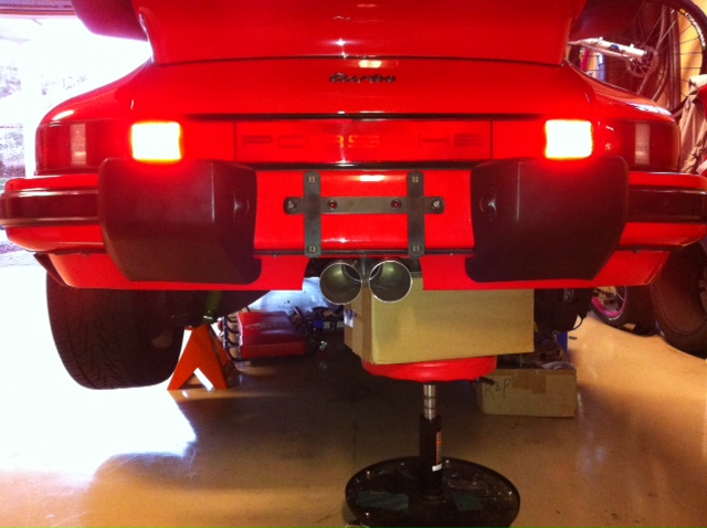

Really nice! I love the exhaust out the center
