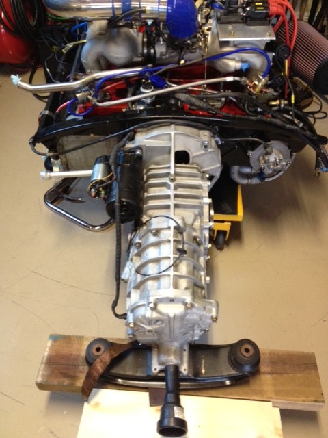

Motor & Gearbox mated
One step closer to done

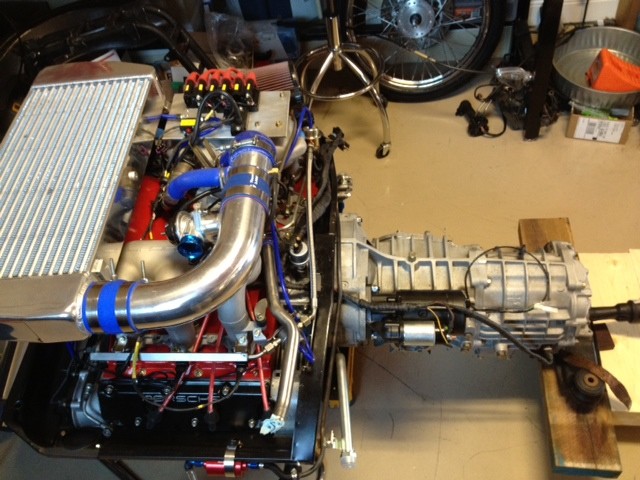

Motor is in!!!

Starter wired and muffler mounted. Fresh air intake next then fire in the hole!

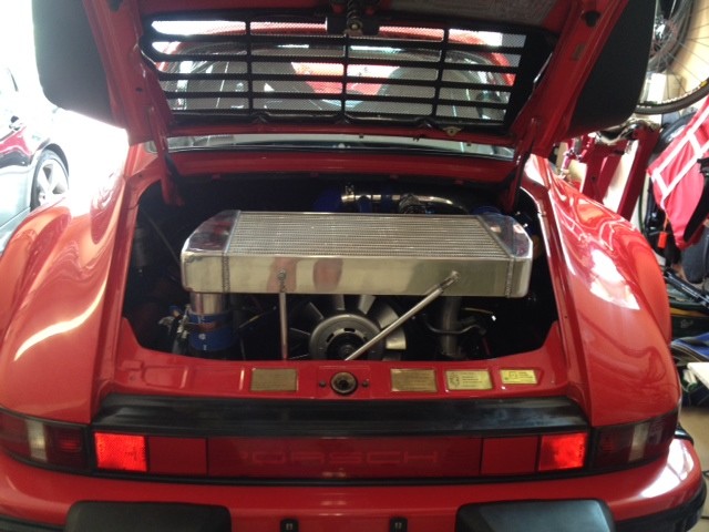

Pic update
Here's a pic of the motor in the car. It fit's but there's not much room for anything else

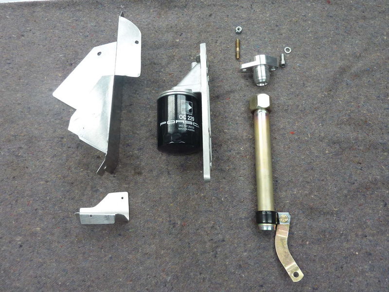

Leak found!
The motor mounted thermostat failed and filled the motor mounted oil cooler with cold Joe Gibbs BR and popped it like a zit! I don't know how you guys feel about this cooler, but I think it's a weak link and plan to add a 3.6L/993 filter console there instead.
I will need an oil inlet adapter, so please show me some ideas
Here's an example of the Smart Racing Kit looks like:

CaptainCalf is infamous around these parts
Originally Posted by Slik560
So you're going to substitute the oil filter console for the stock oil cooler? Won't removing the oil cooler cause heat issues? [Porsche novice here, and not a 930 expert by any means]
Maybe, Maybe not
If you sit in stop and go traffic in FL in the summer sun then yes I think you'd need to add the cooler back on cuz it's prolly good for 30 degrees of cooling while sitting, but if you plan on tracking the car or running down the back roads then the cooler up is more in play and if coupled with a set of Elephant Racing's finned oil lines should do the job w/o the motor mounted cooler.
Porsche stopped using them on 3.6L air cooled cars and they didn't use them on their race cars that I know of. Ever wonder why?
However, if my theory proves wrong I'll just add a second cooler up front cuz I really like the idea of a 2nd filter there right before the brgs and since the motor mounted coolers are such a weak link I prolly wont ever run one again
