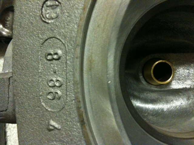

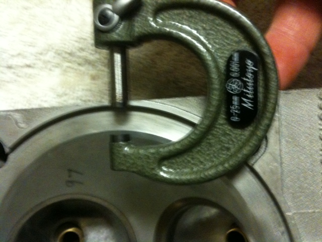

Fire Rings
Anybody know if I have room for fire rings in these cylinders & heads?
8-8.5mm for head width
2.5-3mm for cylinder height

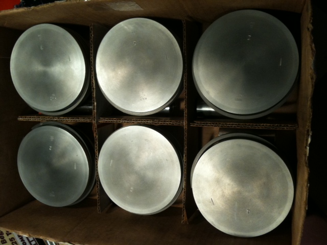

Bearings R Us
conrod & main bearings

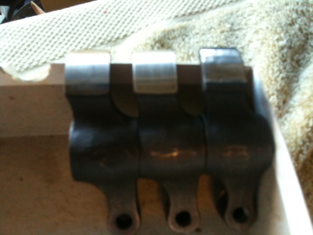

more pics
bearings, case & stand

more pics
rod brg clears are good, turbo pump is clean and rockers need resurfacing

Piston ring to land clears all well within spec
more progress

you're not going with 3.4's ?. As it was explained to me, main reason why Ruf went to 3.4's is that the cylinders had fins all around which was better for cooling. If stock ones are perfect I guess it is a good money saver.
Old Apr 7, 2011 | 09:21 AM
CaptainCalf's Avatar
Joined: Jun 2010
Posts: 212
From: Chapel Hill, NC
CaptainCalf is infamous around these parts
Fins
If these Mahle's weren't so bullet proof, I'd be upgrading to 3.4s after their 24 year 120,000 mile life, but they are absolutely metallurgy masterpieces
