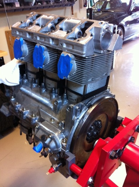

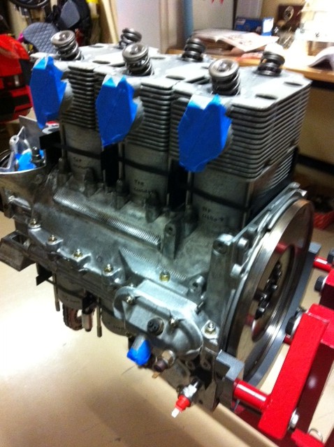

3 of 6 heads on!
I got my hands dirty before work today!

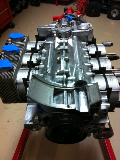

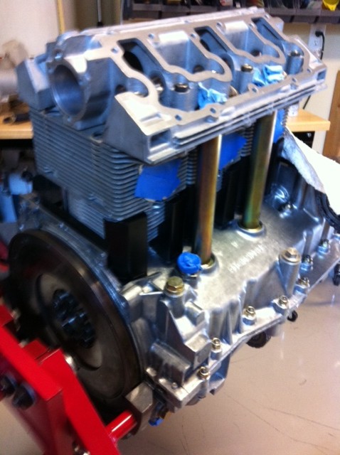

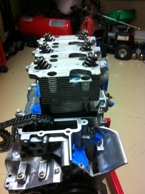

More pics
I made a little more progress this weekend

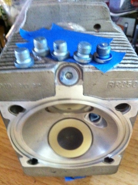

Air Hole Plugs for heads
If you ever have a need to fill those pesky little holes in your heads on the exh side use mercedes tranny plugs! An ole race car builder told me about them.

you should tag weld those in. When I used to track my 930 I would have a bag of them with me because they would constantly fall out when the car got really hot. (which is always in FL on the track). They should be permanently plugged !!!
I used green sleeve on them so we'll see if it holds

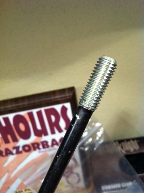

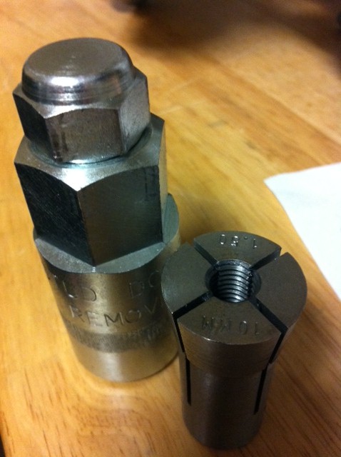

Thread Chaser
using an old head stud I made a M10x1.5 thread chaser which I matched up with a Snap-on collet and it worked great

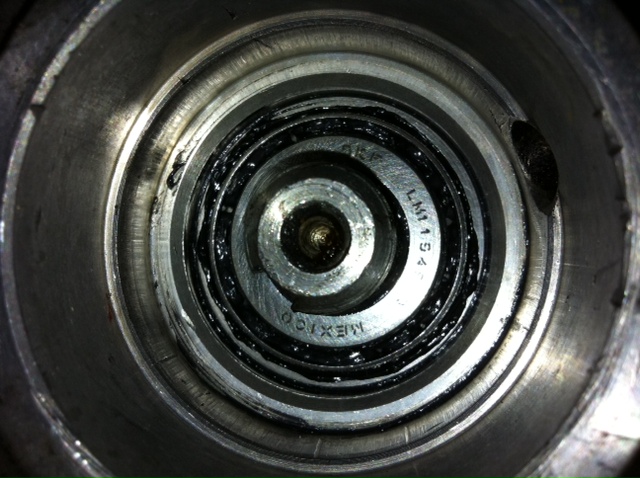

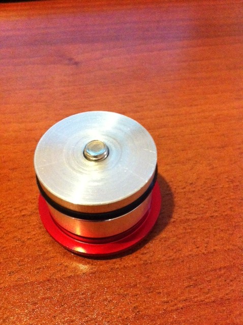

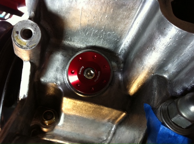

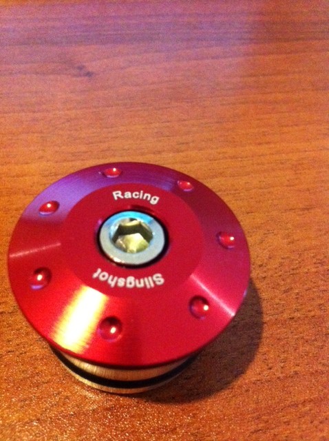

distributor MIA
Since I wont be needing the distributor anymore I had a 30mm hole to fill in the case. I found an Italian motorcycle frame plug that fit nicely

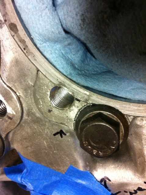

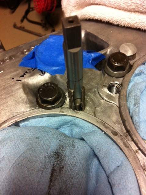

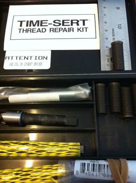

Case saving measures required
I've got 2 iffy head stud holes in the left case that I'm going to repair with Time-serts, so progress is slowed a little. One of the holes wont hold torque even with green sleeve and the other holds with green sleeve, but if I'm gonna fix one I'll fix both while I'm there

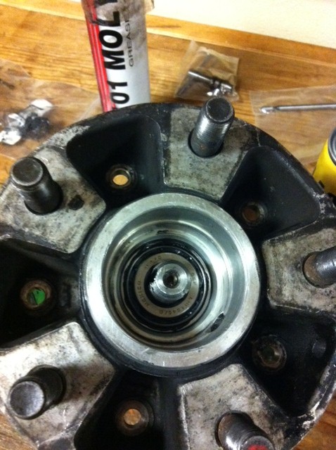

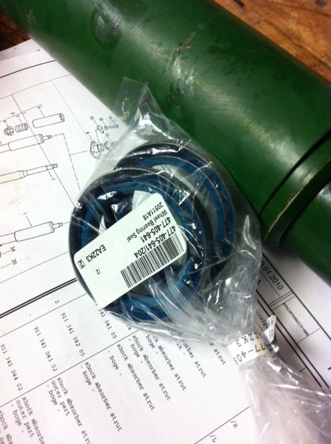

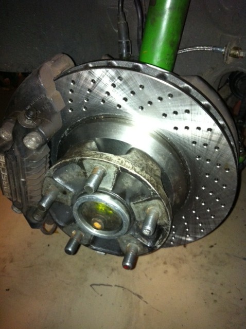

Front end progress

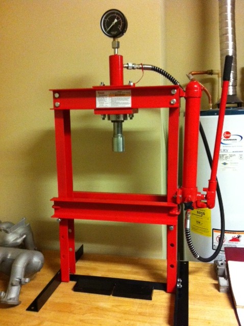

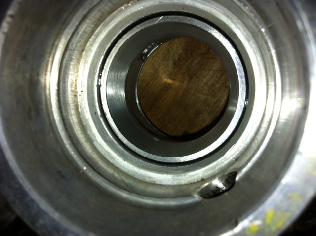

The wifie asked if I'd PLEASE try not to make any banging noise in the garage early on Saturday mornings, so I decided to buy a silent banger
This Grizzly 10 ton press made short work outta the front brg race installs
Can you give me some more info on that plug? It looks like a nice clean solution.
Bill
Bill
Here ya go!
http://cgi.ebay.com/ebaymotors/29mm-...Q5fAccessories

Case drilled & tapped for time-serts
I finally got everything together I needed to drill & tap the case for time-serts. It took a little while to figure out how to dill & tap with precision w/o using a drill press, but I gotter done so no porcupine case here

New Front End Finished!
I'd rather build a motor any day then work on 24 year old front suspension parts, but it's done now so I can get back to the motor
That is very nice. Can you tell me where you got the frame plug. I will be needing one as well.
