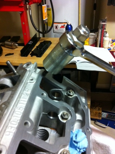

Homemade M8x1.25 thread chaser
Needed to clean out some cam tower threads. If you don't have a collet stud holder you may wanna consider chasing down the Snap on van cuz it's one of the best tools I own

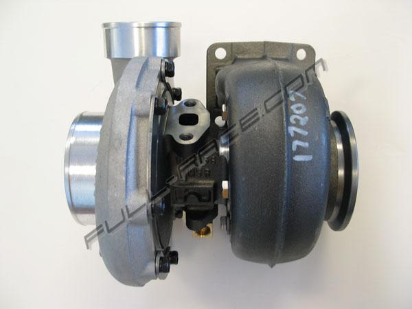

Turbo
After much debate I finally narrowed my search down to two that were both great fits on a twinscroll 500hp EFI 930. The two are the Garrett GT3582R and the BorgWarner S300SX 83-75.
The BW won me over due to it's dependable journal brg with oil only cooling setup. The fact that it can make up to 310 ft-lb of torque at 2000 rpms and 5 psi of boost helped me with my decision as well as the 487 ft-lbs at 4000 rpm at 15 psi of boost...hope I can keep it between the ditches

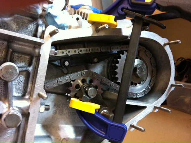

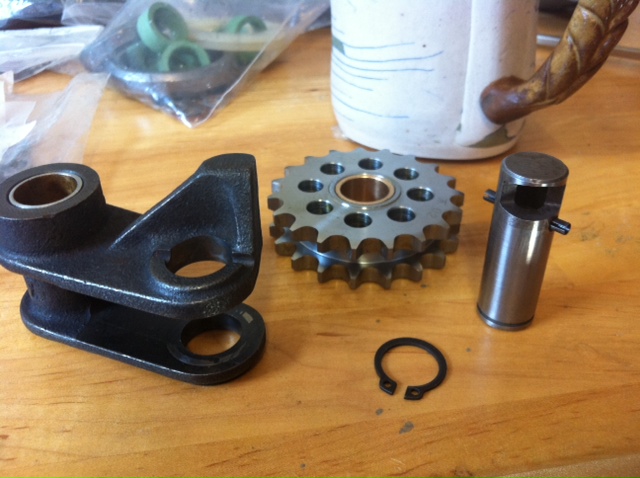

Cam Chain Housings
Today I bolted the two cam chain housings onto the case.

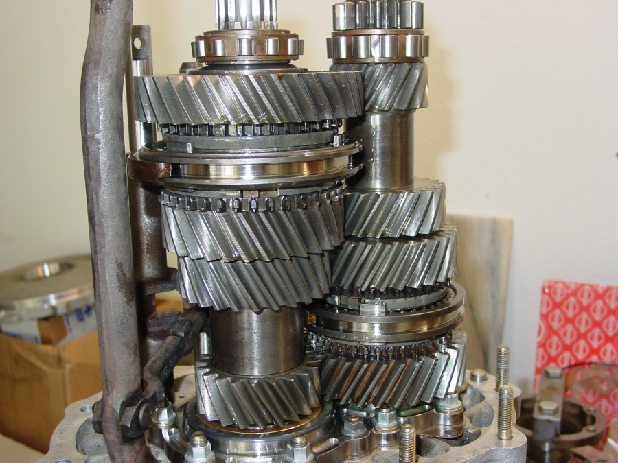

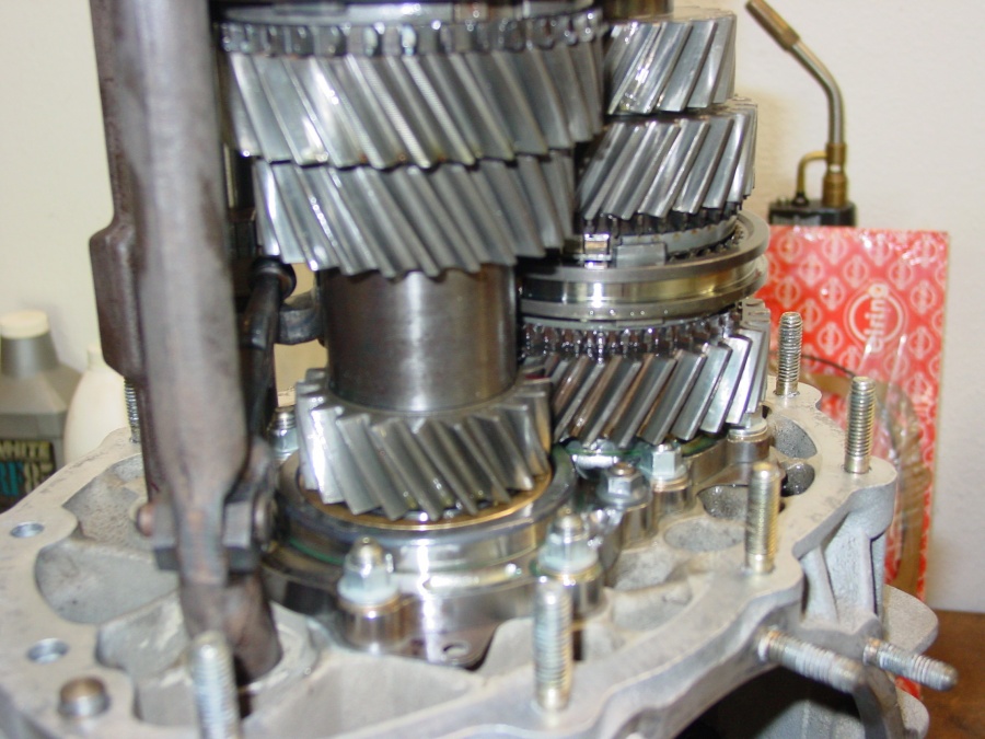

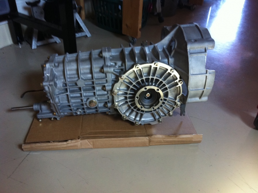

930 4speed gearbox
here's some picks from the darkside...glad I have a good tranny pro to do this for me cuz I just don't have his level of skills

are you putting steel synchros in while you're at it ?. I did on mine, more preventative than anything else, but since they are in there anyway...
Yep and pretty sure all the 1987 930 gear boxes had the Porsche steel synchos. Additionally, those synchros don't like the new super slippery synthetics, so a gallon of high dollar Swepco dino is going back in there too

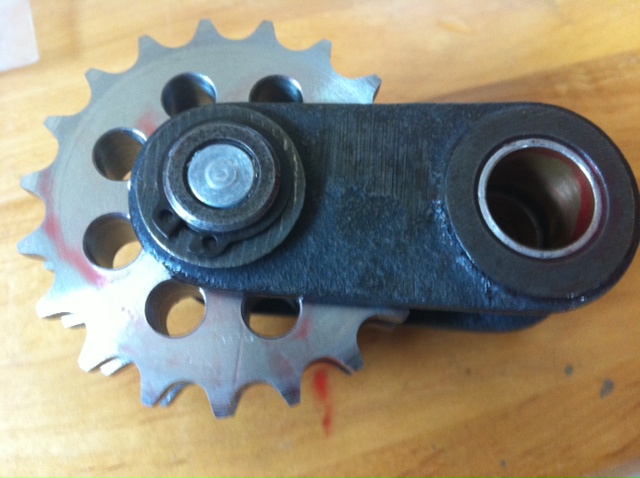

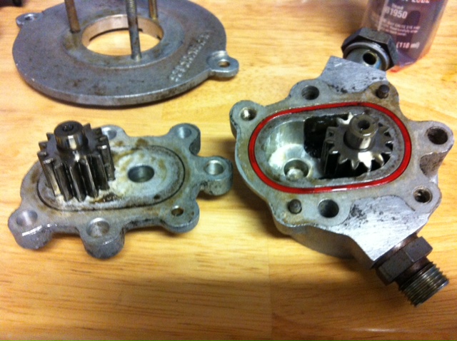

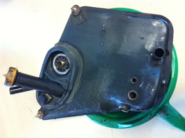

2ndary/Turbo Oil Pump, Oil Tank and Lines all out for cleaning & rebuilding
The pump requires 2 new seals, o-ring and a new drive pin/dowel, but otherwise looks great.
I think the trick will be to get the oil lines for the forward oil cooler off the thermo/pressure junction w/o messing up the aluminum threads on the housing.

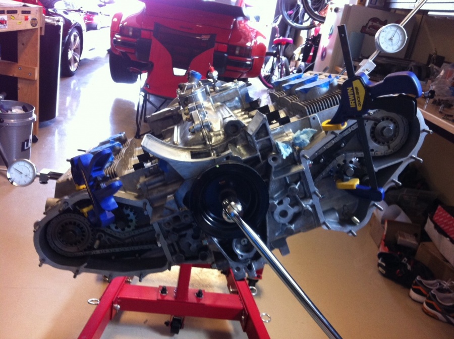

More progress
cam chain sprockets parallel and left cam timed...right side next

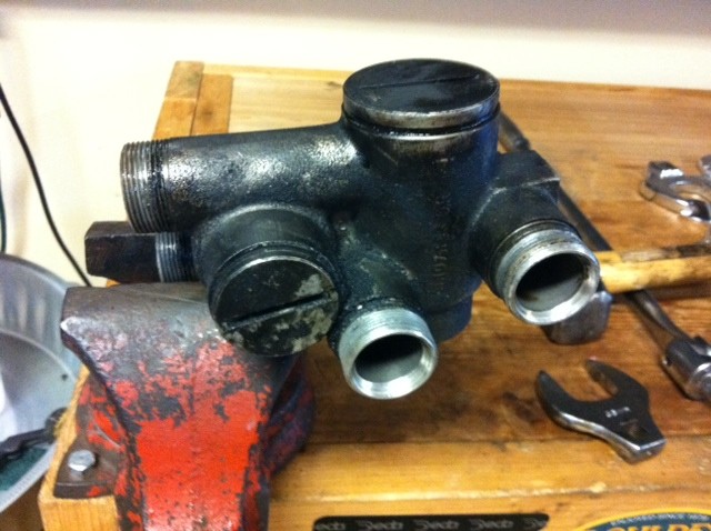

Old Sep 7, 2011 | 08:27 AM
  #105
CaptainCalf's Avatar
Joined: Jun 2010
Posts: 212
From: Chapel Hill, NC
CaptainCalf is infamous around these parts

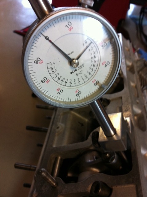

Cams timed and f'wrd oil cooler thermo out
Cams are timed and thermo is out for a good cleaning
