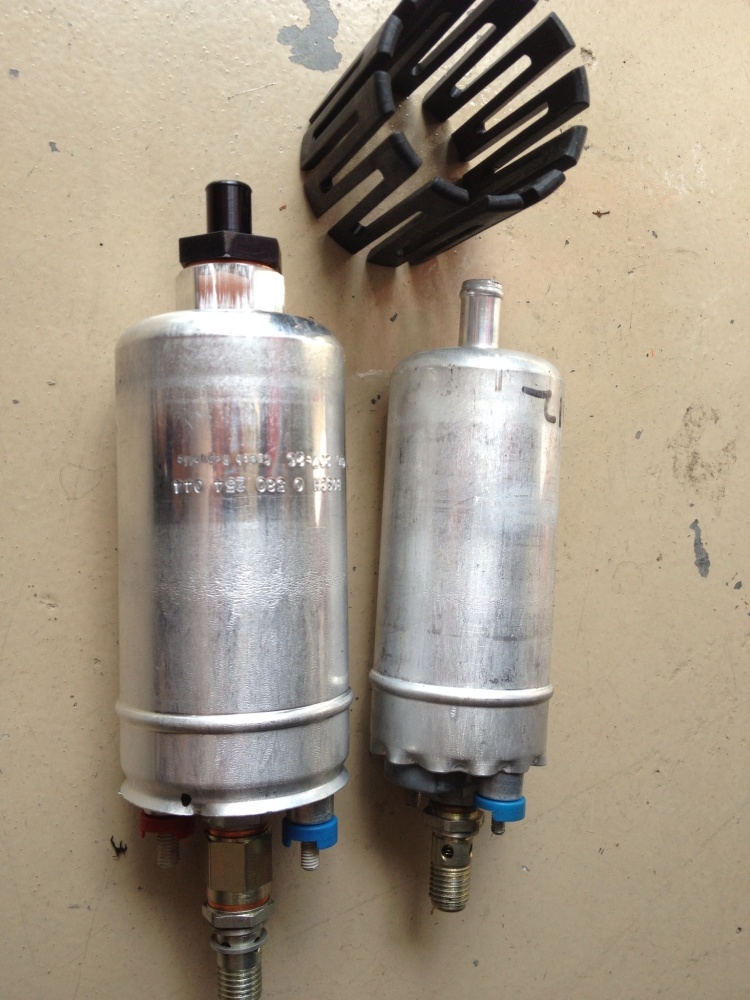

Bigger fuel pump required
In order to run 1.2 bar of boost with acceptable AFRs I had to add a new Bosch 044 racing fuel pump up front. It's about twice the size of the OEM pump and will surly get me a speeding ticket

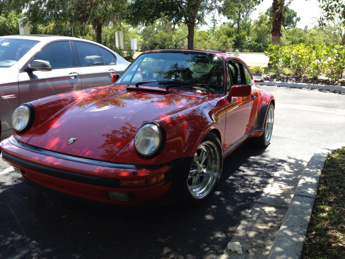

1st drive to work this year
This car is crazy fast at the low boost setting of 0.08 bar. Hi boost is set at 1.2 bar but I'm afraid I will get in trouble with the authorities if I use it

Old Jun 7, 2013 | 10:43 AM
  #229
ECS Tuning - Porsche's Avatar
Joined: Mar 2012
Posts: 9,607
From: Wadsworth, OH
Such a pretty looking car
Old Jun 8, 2013 | 06:48 AM
  #230
CaptainCalf's Avatar
Joined: Jun 2010
Posts: 212
From: Chapel Hill, NC
CaptainCalf is infamous around these parts
Thanks! It's the results of 2 years of blood, sweat & beers:-)
