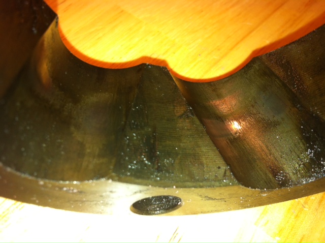

CV Joints

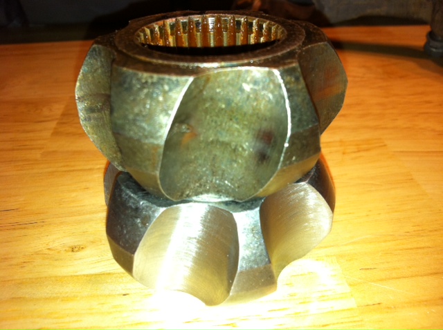

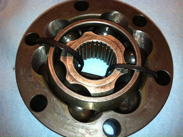

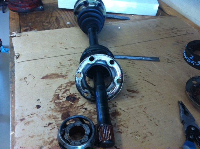

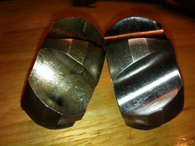

After tearing down all 4 CV joints I found that only 1 of them is reusable. 3 of them have deep grooves & pitting in the races. I will try to resurface the best looking joint and reuse it along with 3 new ones.

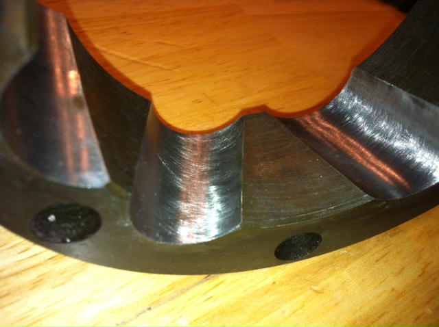

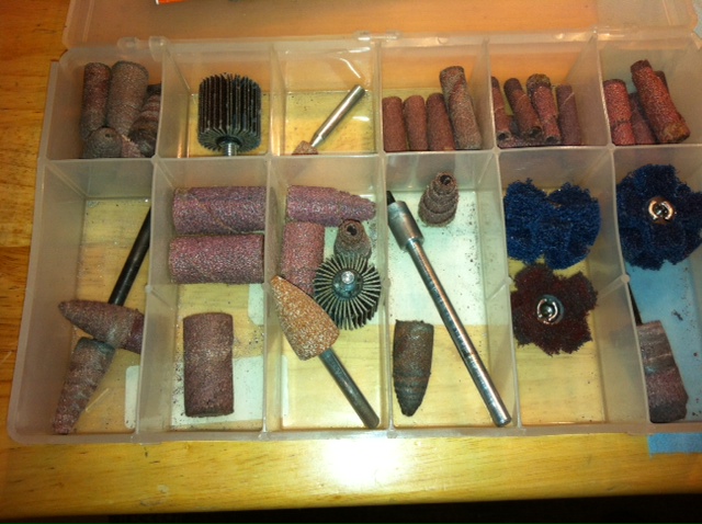

detailed cv joint
pics of my detail kit and pics before and after detail inner & outter races

one more cv joint pic
detailed & ready to go

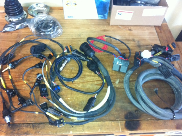

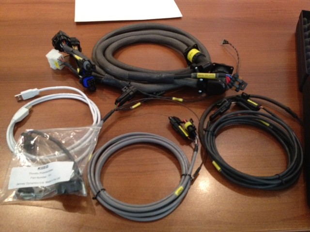

Got most of the remaining EFI parts in
Now I just need some fab time in order to get these parts installed

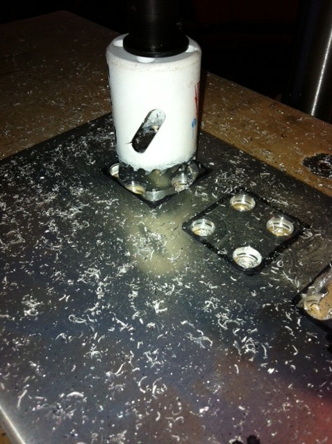

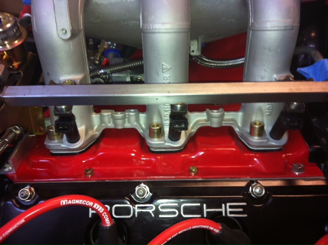

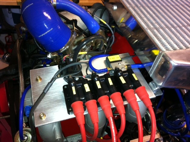

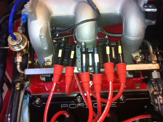

Fabbed up a sensor and coil shelf
Most of the sensors and the coils are mounted...just a few more boxes of parts and I'll have everything needed to put this baby on the road!

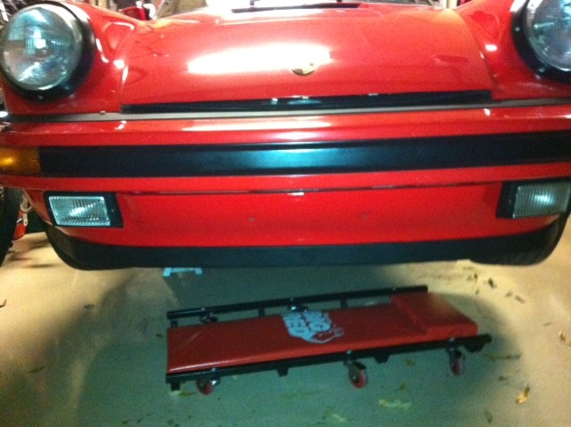

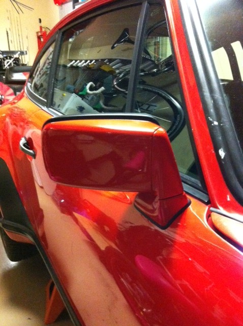

So in the meantime, I've done some body work to keep myself busy...painted both the flags and the front valance

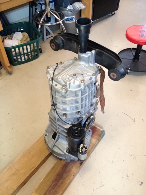

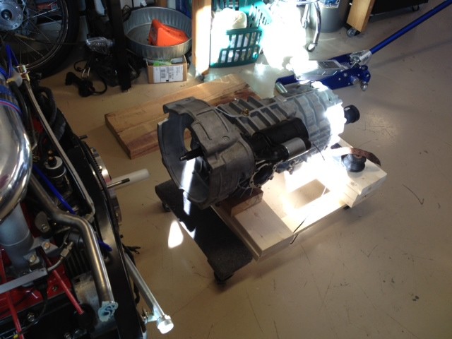

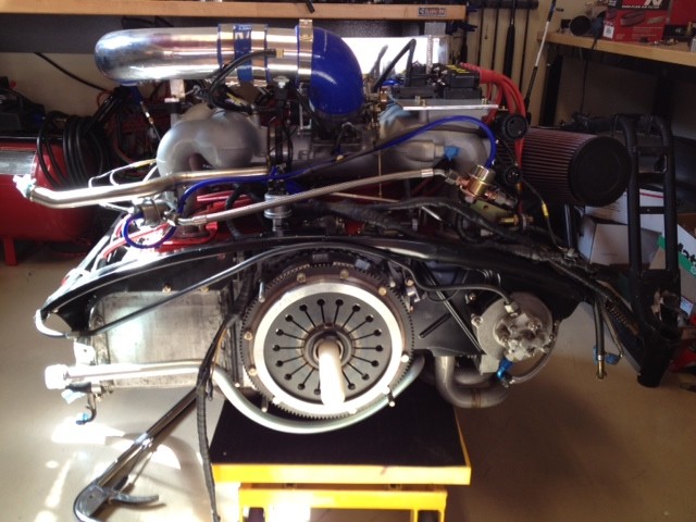

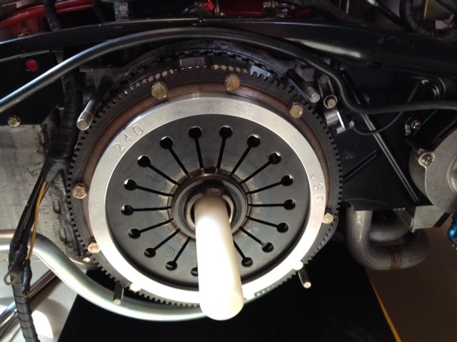

Gearbox on dolly
I had the gearbox up and ready to mate with the motor when realized that 3 of my 4 studs were the wrong length. Two were about 10 MM short & one was about 20 mm short. New studs ordered from McMasters and if they get here this week then I will try to get the motor back in the car this weekend after a year of rebuilding both the car & motor. Guess there's worse things to do with your time & money

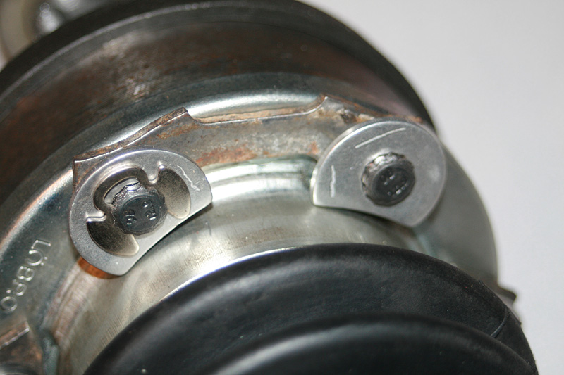

Stage 8 CV Joint Fasteners
I ordered a set of locking CV joint bolts so I don't have to worry about the bolts backing out after being torqued
Dan at Ideola is very customer oriented: http://garage.ideola.com/prod-Stage8.html
