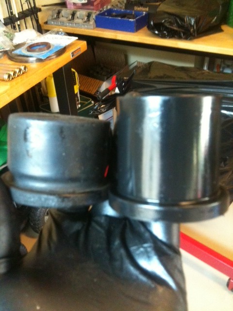

What Valve Spring Height stack???
Can anybody tell me what valve string stack height to use with SC cams
UPDATE: Talked to John at DRC and have his matching springs to be set at 35.5mm

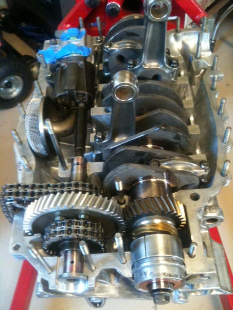

today's progress
almost ready to button up bottom end!

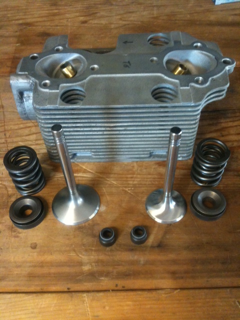

Heads getting assembled
2 down and 4 to go

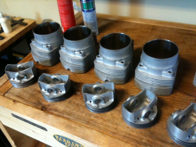

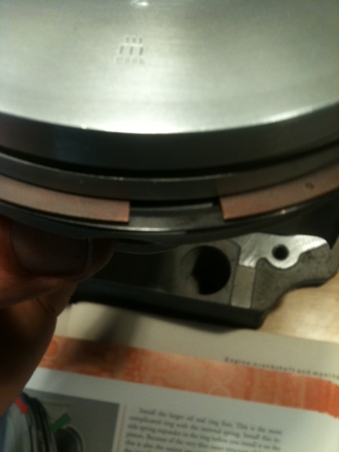

Movin on...heads done ring gaps next
Tonight I ringed 3 plugs and I'm using a gapless CR in the 2nd groove to improve the seal...

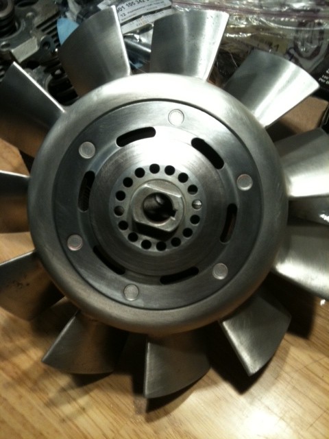

clean fan
ready for paint

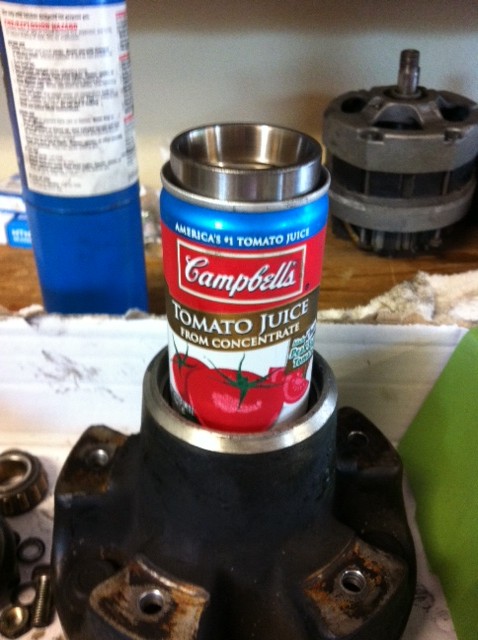

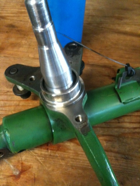

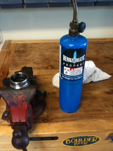

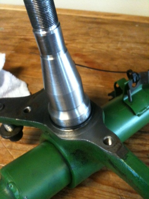

New Front Wheel Bearings & Races
The inner race walks right out with a flat end punch, but the outter is more difficult and requires thermodynamic manipulation. I used a torch to gently heat the hub/housing and that helped, but to make it real easy I then used a cold can of tomato juice to cool the race too. Once cooled the outter race walked right out.

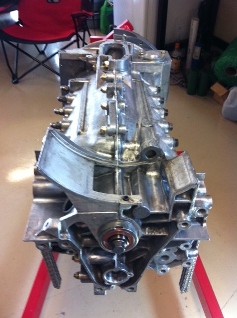

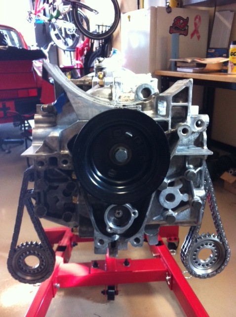

After 5 long years the cases meet again:)
If you ever watched a stupid chick flick with your wifie you know how it is when two hard cases come back together after 5 years apart...it's like magic
