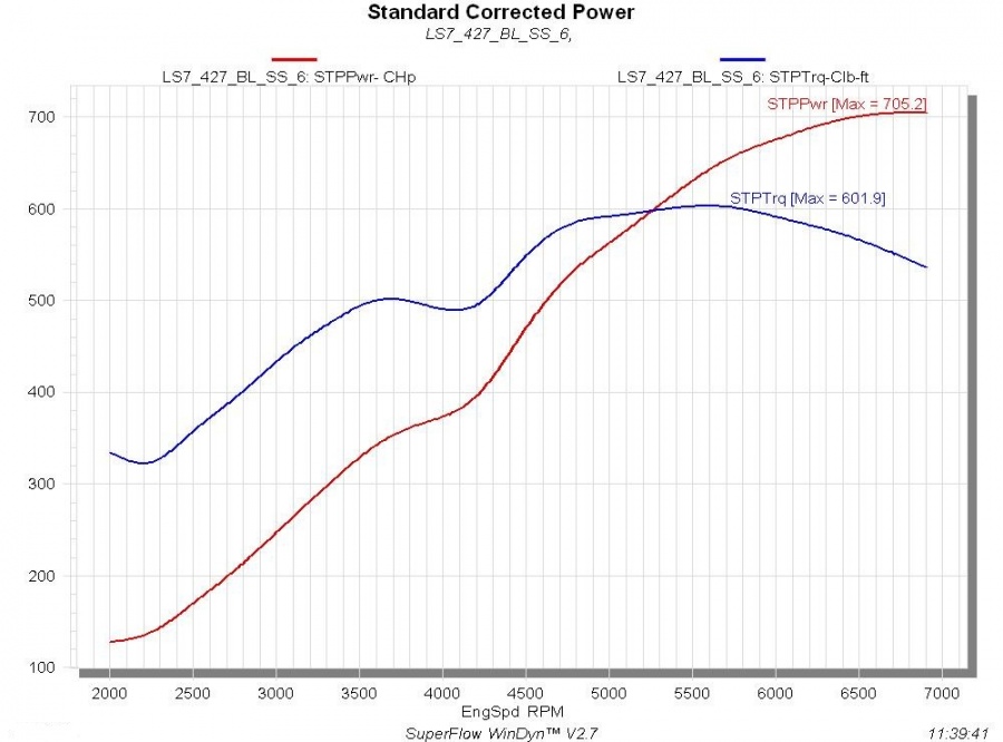

yes this swap is not for everyone, but is not a 32 ford. the car has upgraded components throughout to suspension, brakes, etc. it has been lightened extensively including aluminum hood, lexan in all windows but the front windshield, lightweight interior, no ac, no radio, no sound deadening, etc. the front and rear bumpers or covers are original ruf pieces. i used livorsi gauges which take signal input from the ECU and feature additional digital reading in the face of the tachometer and the gps speedometer.the mast motorsports drive by wire ls7 motor develops slightly over 700 chp and is a hundred pounds lighter than the 500 chp turbo motor it replaced. the car weighs in slightly over 2300 pounds with much better balance and considerably more power than before.
