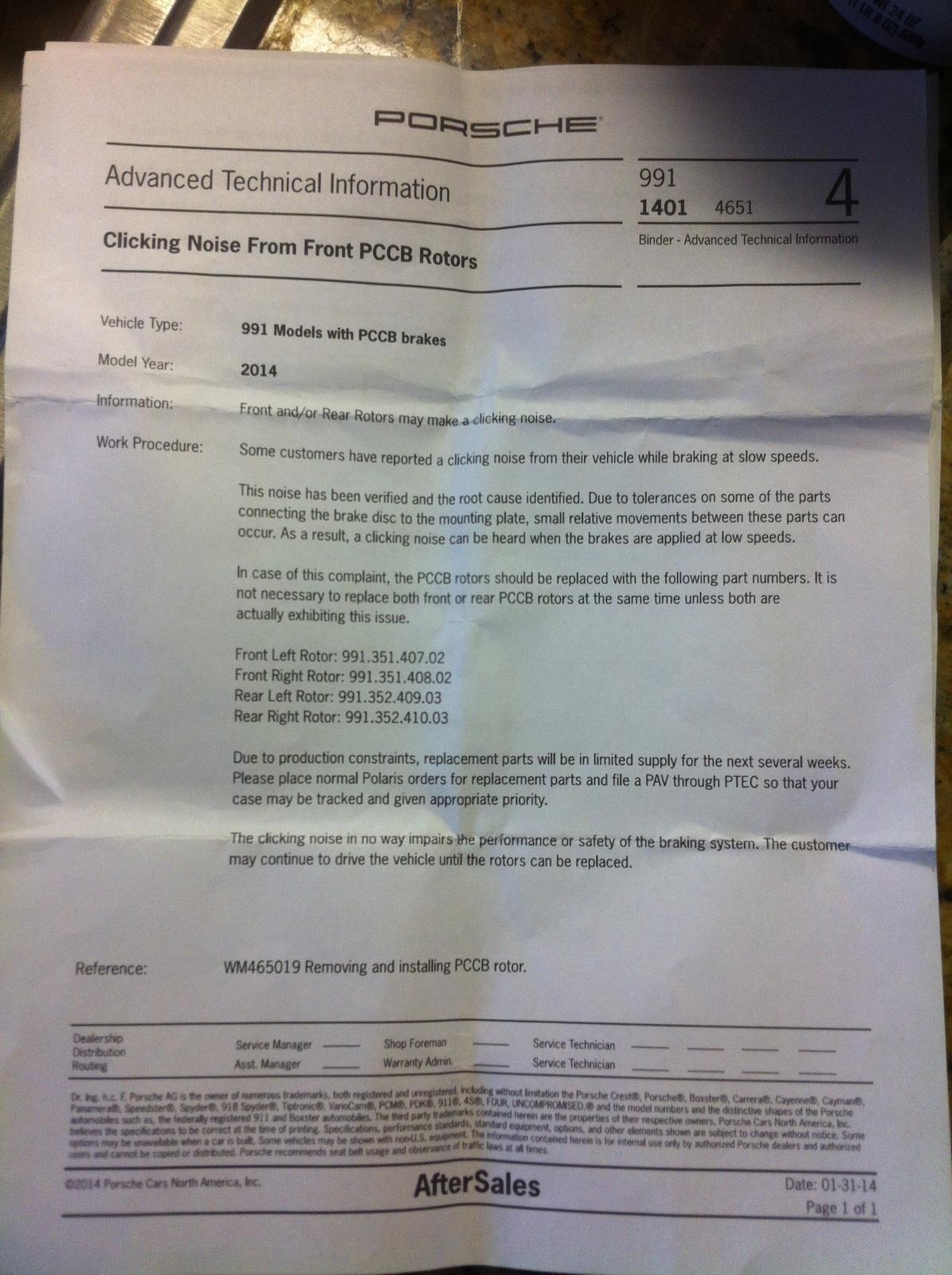

At 300 miles my new TTS Cab has started making clunking noises as the car slows to a stop. As it stops there is a rapid audible clunk-clunk-clunk, etc. coming from the front. The car is safe to drive according to the dealer who says it's brake rotors and has ordered new ones. They skirted the details about what is actually happening though. Does anyone have any ideas about what the actual fault could be?

Thank you, that's me over there. Posts there show the problem is known by Porsche and they have a document describing the problem and solution.

I have the exact same problem. My dealer said it's fine and normal but it's still annoying as hell. Will someone please shed some light on it.

Here is the Porsche Technical Info on this issue. Not fine and not normal but supposedly still safe.

I have the same issue as well as some other friends here in the UAE.. will see what the dealer says about it..
