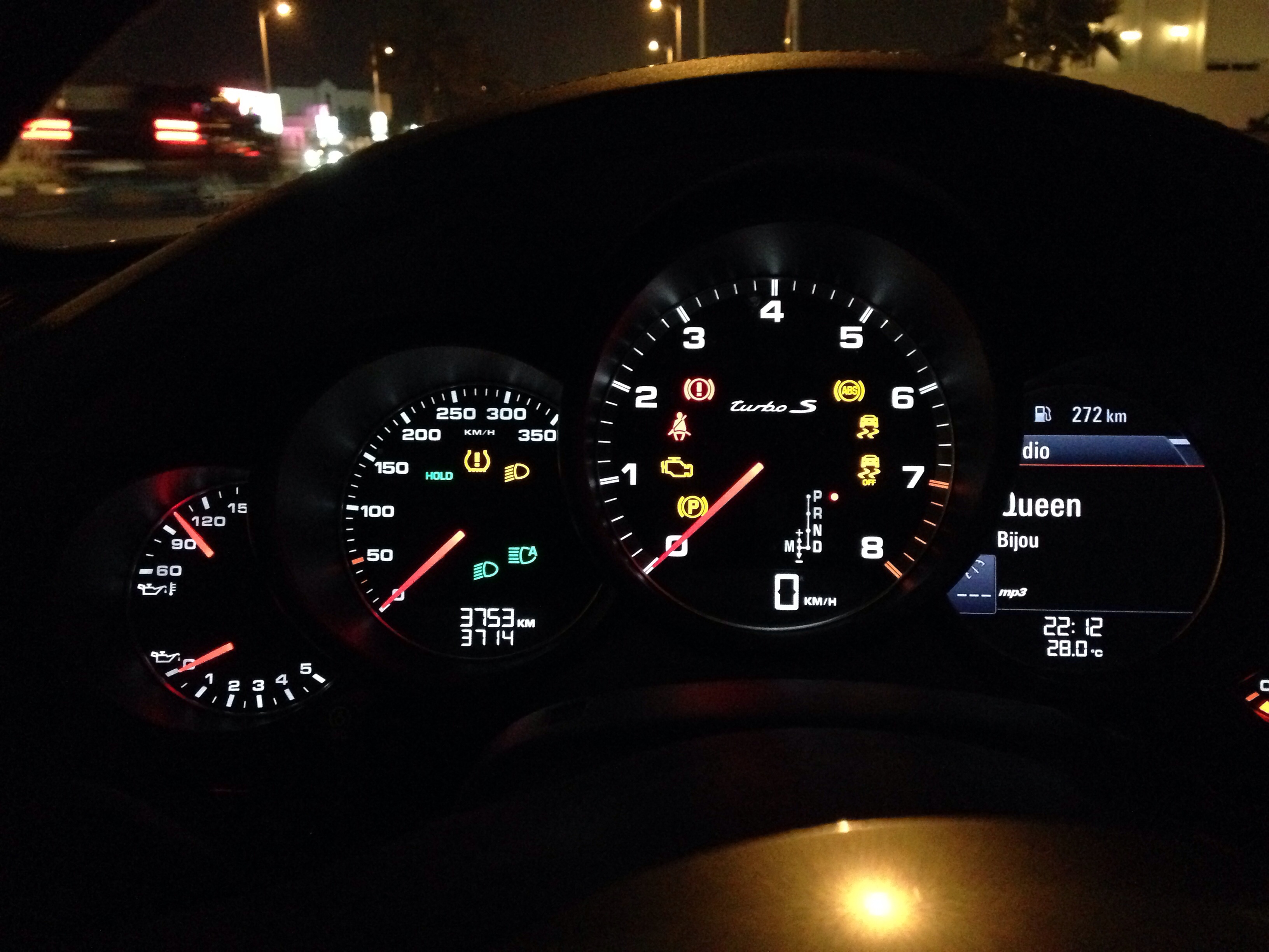

All lights just turned on again

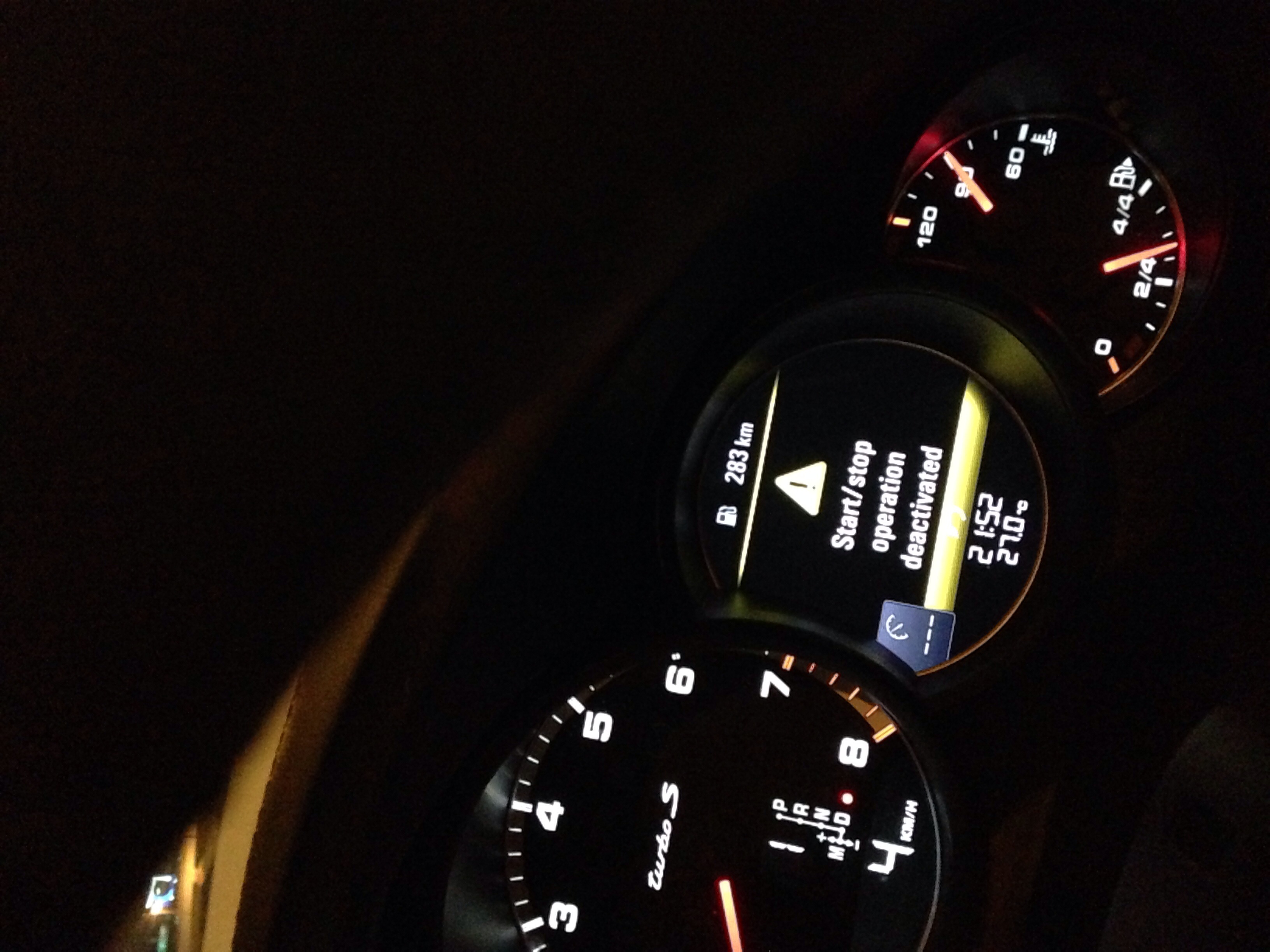

Definitely the on off system

seems like a new battery fixes most things
I'm thinking that too. I'm taking it tomorrow morning. But what does the battery have to do with disengaging the automatic start/stop function?

Turns out to be an impulse sensor on the crankshaft which is faulty. The car is in the workshop and it'll take several days to receive the part from Germany :'(
What does "on the crankshaft" mean? Will they need to open the motor for repairs? That would be discouraging to say the least.

Crankshaft positioning sensor..... when it goes bad car feels like it has a loss of power...will not accelerate etc
