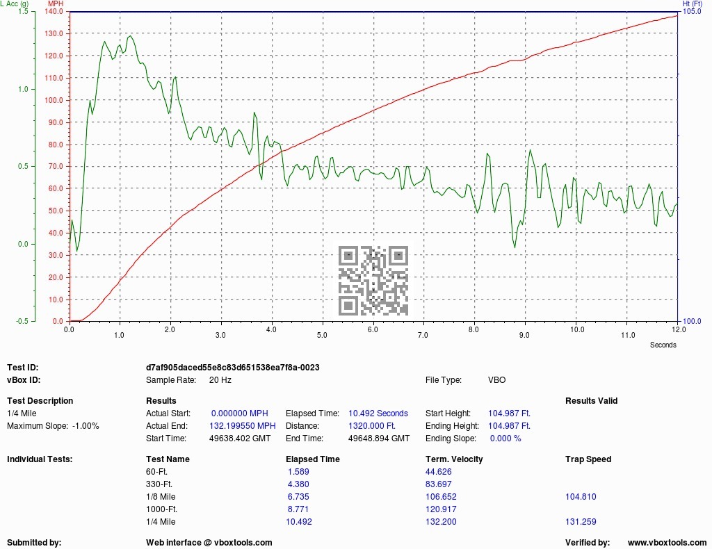

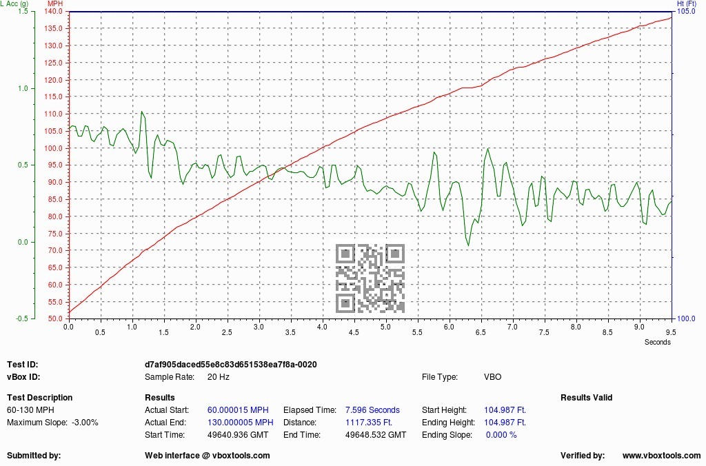

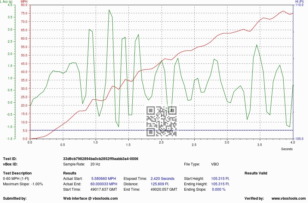

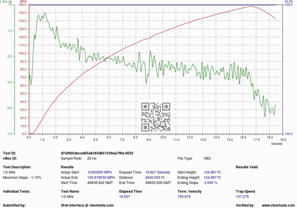

Got her over a 1000 miles this week so went back for testing of LC . I made 3 runs, two with aero down 3rd with aero in track setting , unfortunately only the 0-60 run data was there for aero down due to an error (data stopped recording). Interestingly it looks like track aero has little effect in the 1/4 mile, after looking at the data I actually lifted before the 1/2 mile point thus the trap was higher than my end velocity oops. Car was full weight , half a tank of gas , stock zeros at 38/48 psi , DA was + 500 with temp at 68 and as always 0 slope and 93 octane. Despite warmer conditions the imbedded in the quarter 60-130 broke into the 7.5"s and the trap was up to 131mph ! This thing can flat out move.

Nice thanks for sharing OP. The 991.2's seem as strong as some tuned 991.1's.
But I'm having a hard time understanding the plausibility of some of the data.
The G's obtained on that 0-60 mph run for instance. I've never seen anything so choppy beyond the 30mph mark on a pdk Turbo. Getting beyond 1.5 G's at 50mph and over 2 G's at 60mph means the car is making well over 1,000 HP.
Next, check out the elevation. On every single run, the starting and ending elevation is 104.987, except for the 0-60 run where the starting and ending elevation is 105.315. I've never seen this looking at thousands of vBox results. Particularly on your full have mile run, which did not get a variance of even one inch.
Maybe Pencilgeek and check out your files to see what's causing this.

The 2.4 0-60 run was in a separate spot near my test road it wasn't from the 10.49 run that's why it's different . The test road is absolutely flat for miles it's pretty awesome . The road is quite bumpy in spots and the v box was mounted on my glass roof but the g's have nothing to do with the GPS data . At any rate the g's on the 10.49 run are as expected which is where all the other data comes from . I have tested multiple multiple cars in this location and the data tracks . The 10.8 no LC run was in the opposite direction in the same spot .

Here is the 0-60 from the 10.49 run, sorry for the confusion.
