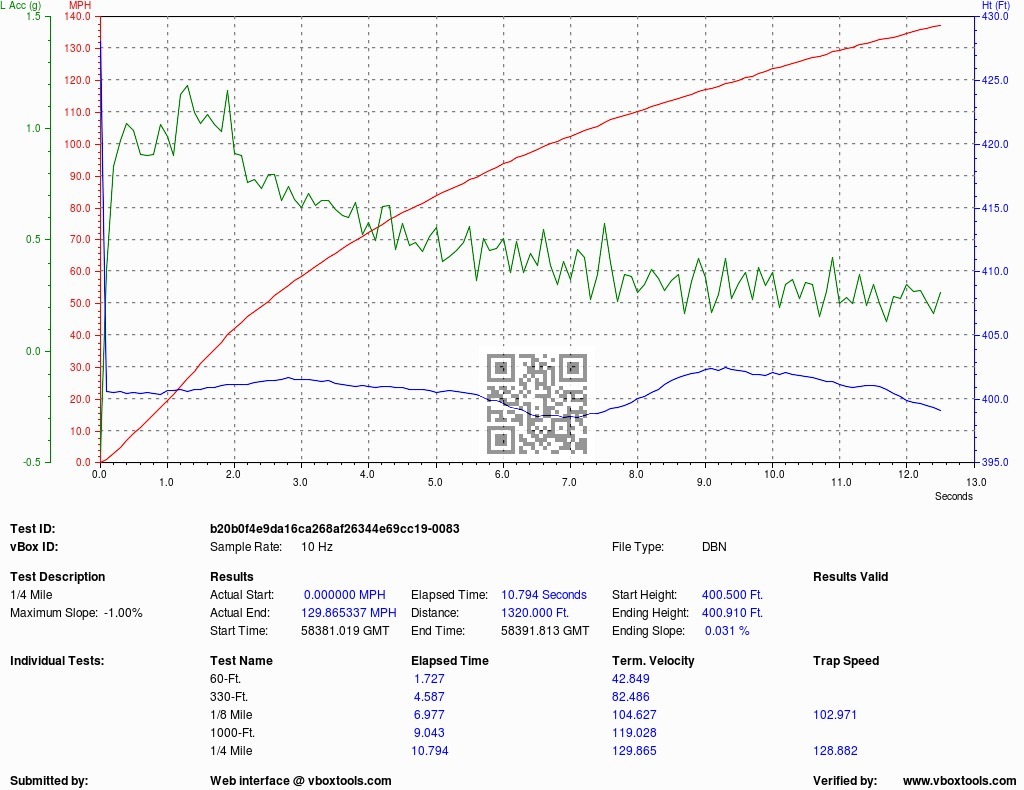

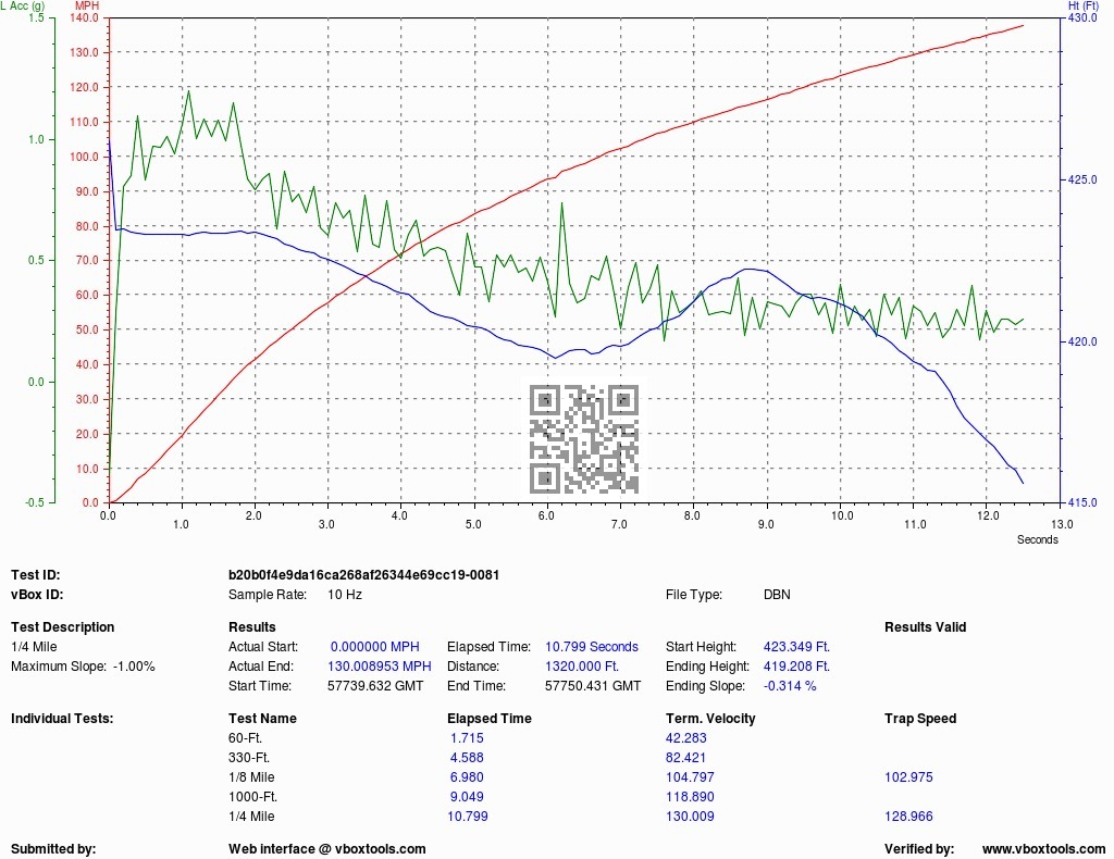

Pretty much no luck. Ran several times, it was about 73 when I started and 78 when I left. Ran a couple of runs with the Carlos map and a couple of runs with the regular Stage 3 ByDesign map. Here are the Vbox for the second of each one which were the best.
Pretty much dog slow. I spun the tires really good before each run. I backed up, put it in sport only never had TC on and brake boosted to spin the tires before each run. Tire pressure was 32 on the fronts and 36 on the rears and pretty much stayed that way. I had Valero 93 today which isn't as good as the VPower so that might matter. I could plot the AP log but I know what it's going to show, same old same old flat spots not shifting when it should out of first gear. Getting stuck after LC is done and not getting to 7000 and shifting into second. That consistently takes about .4s or more from my ET. I wish some other people that have AP would post the graphs I do so I could see how their cars shift.

Here are the AP Data Plots Posted in order of run
Make what you will of them. Not a lot of difference in performance as I can see. The second run is better in both and they are both about the same for the first run and then the same amount better the second run. Lot's of time wasted in that transition from LC to first gear and then a short shift to second gear. It's definitely traction that I can feel but I have had better runs on the same road by about .2-3s with higher trap speeds.
Really I have to conclude neither map is much different than the other in terms of overall performance. Initial IAT is about 10 degrees higher on the second map but that is to be expected but all final IAT are around 150F.
I didin't use the ice trick which could have helped. Still, this is a long way from getting below 10.5. These are N0 PZeros with a couple of track events on them but less than 4000 miles. I am probably replacing them with N1s while I get the turbos rebuilt.
