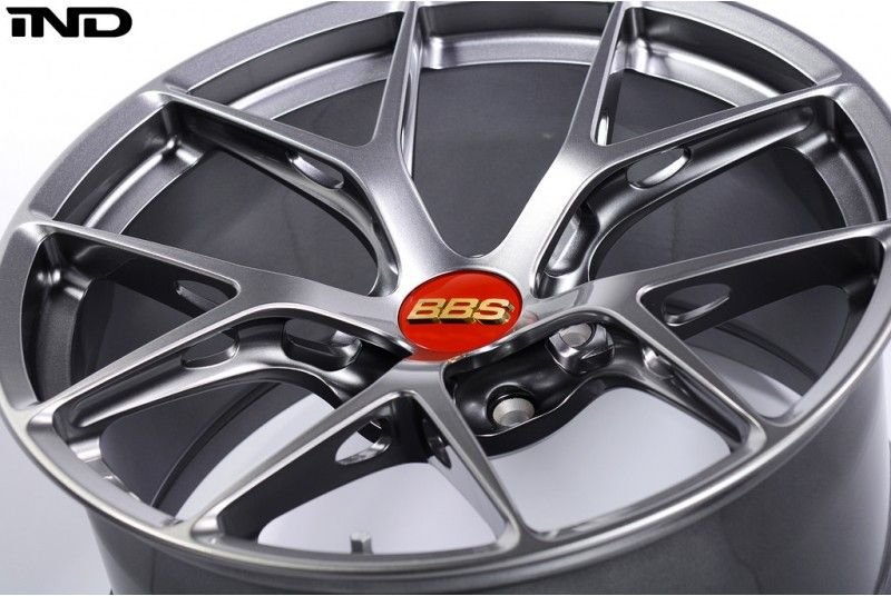

I finally picked a set of new wheels and they arrive tomorrow. I will post a few pictures of them on the car once I get them mounted.
For now here are what they look like on the GT3. I got them in 9x20 and 11.5x20 Platinum Silver. They are the BBS FIR.

Great choice - I just ordered a set myself.

Congrats. I almost pulled the tirgger on these but preffered the BBS. http://rennlist.com/forums/parts-mar...s-sensors.html
